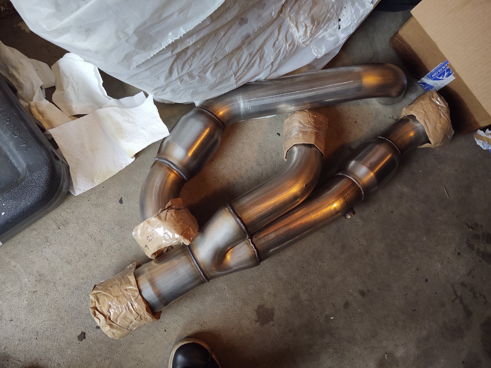

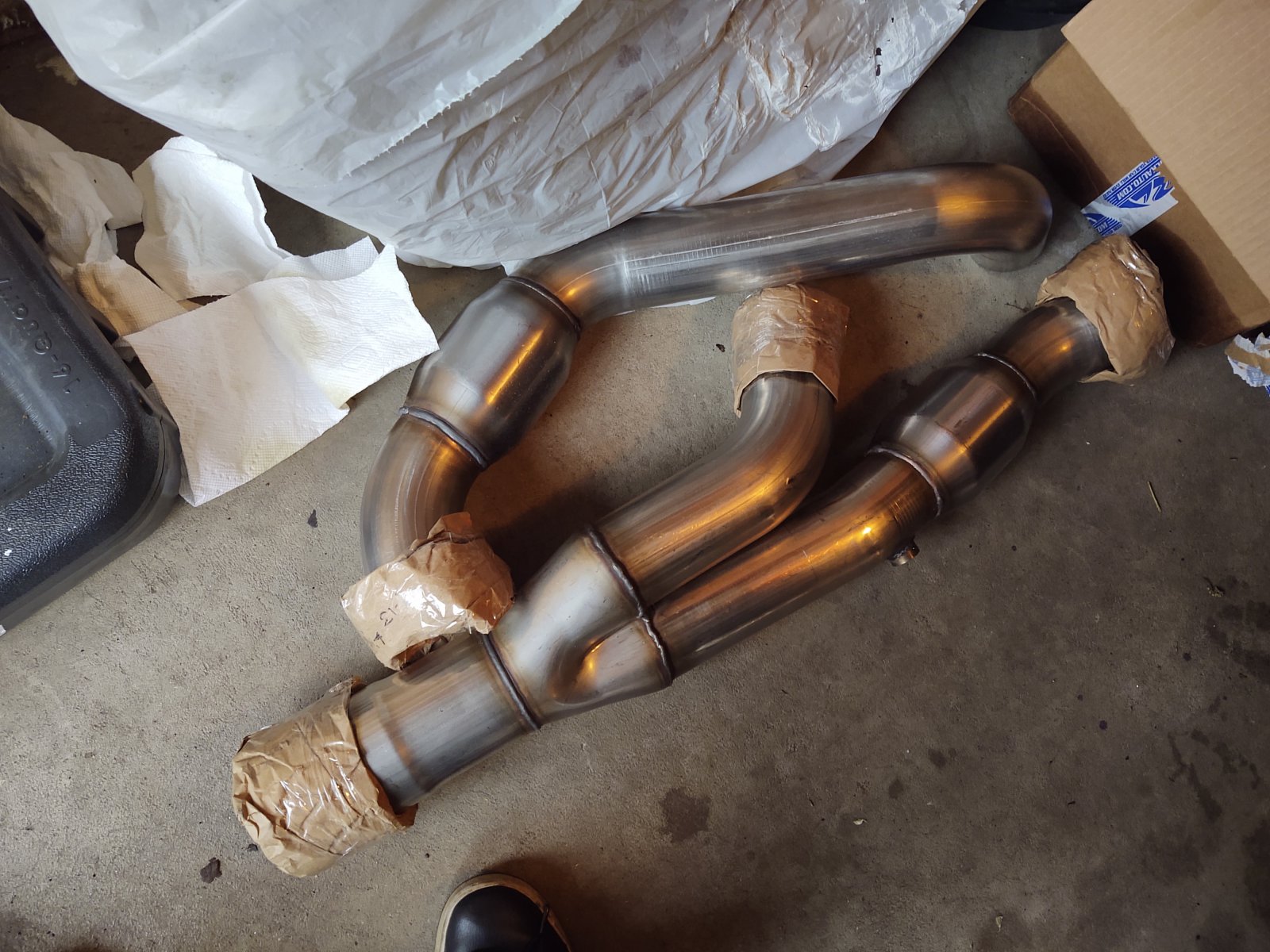

The factory y pipe was tiny but it stepped up to 3.5". My ARH long tubes came with cats and have 3" pipes that go in to a collector, that then bolts to the flange going to the factory system. I have always planned on going to 3" true duals with hidden tailpipes. The 3.5" system flows and sounds good, but I can't stand the sound of both banks converging into a single system.
A picture from last year, but under that cover was the wrong flange to mate to my stock exhaust, it had a ball type end while my stock system has a flange. We did a chop and weld of the flange to make it all work, but it leaks in a few spots. So that's why I'm just going to do the true duals now instead of later.

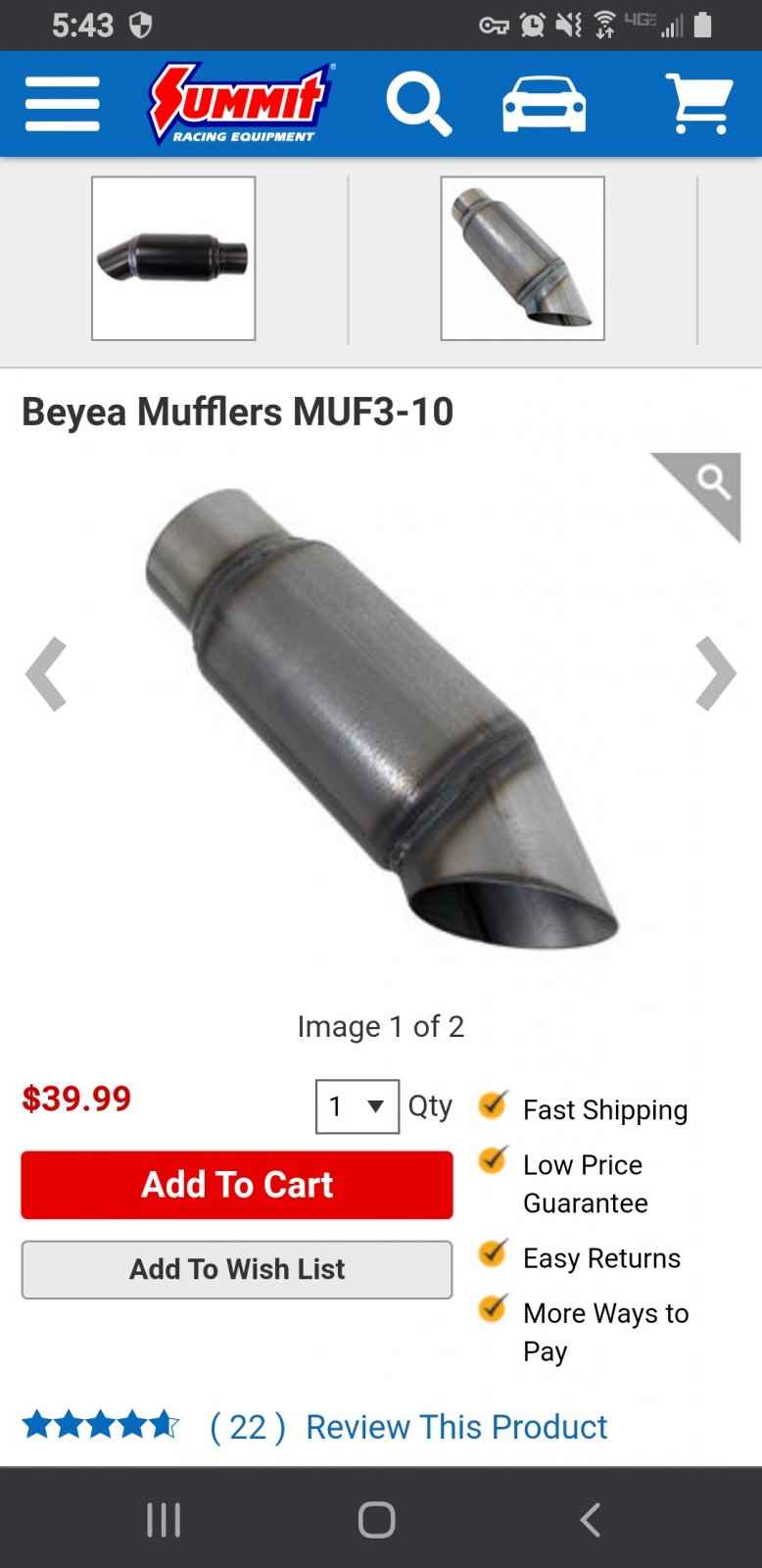

I haven't tried to contact them, only because I've searched google high and low looking for any situation where Corsa sold just a muffler. There was a DB series, but that dissolved. I am looking at borla s-type crate muffler, or the Corsa 3" dual in/dual out muffler that goes on a Raptor. I have Vibrant resonators that I plan to use at split rear exit. Since I gapped the rings for supercharging, I won't settle for anything less than 3" true duals, and I'm finding I'll have to Frankenstein the dual tailpipes from Silverado ones.
