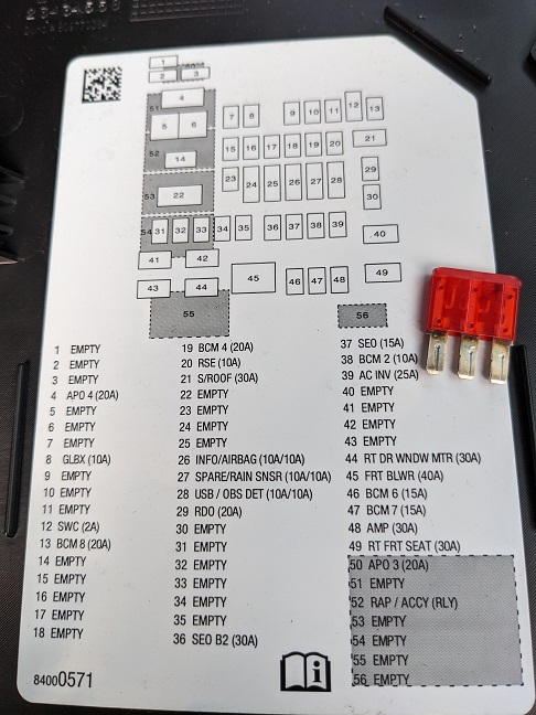

Woohoo... I checked fuses as suggested (thank you Doubeleive!) and found blown 28 (pic). Now I'm down to Side Detection Service message, which I suspect he's also right about, needs programming. Anyone know how to do this without a dealer?

Woohoo... I checked fuses as suggested (thank you Doubeleive!) and found blown 28 (pic). Now I'm down to Side Detection Service message, which I suspect he's also right about, needs programming. Anyone know how to do this without a dealer?View attachment 368690
Which fuse box was this? The one on the side of the dash?
