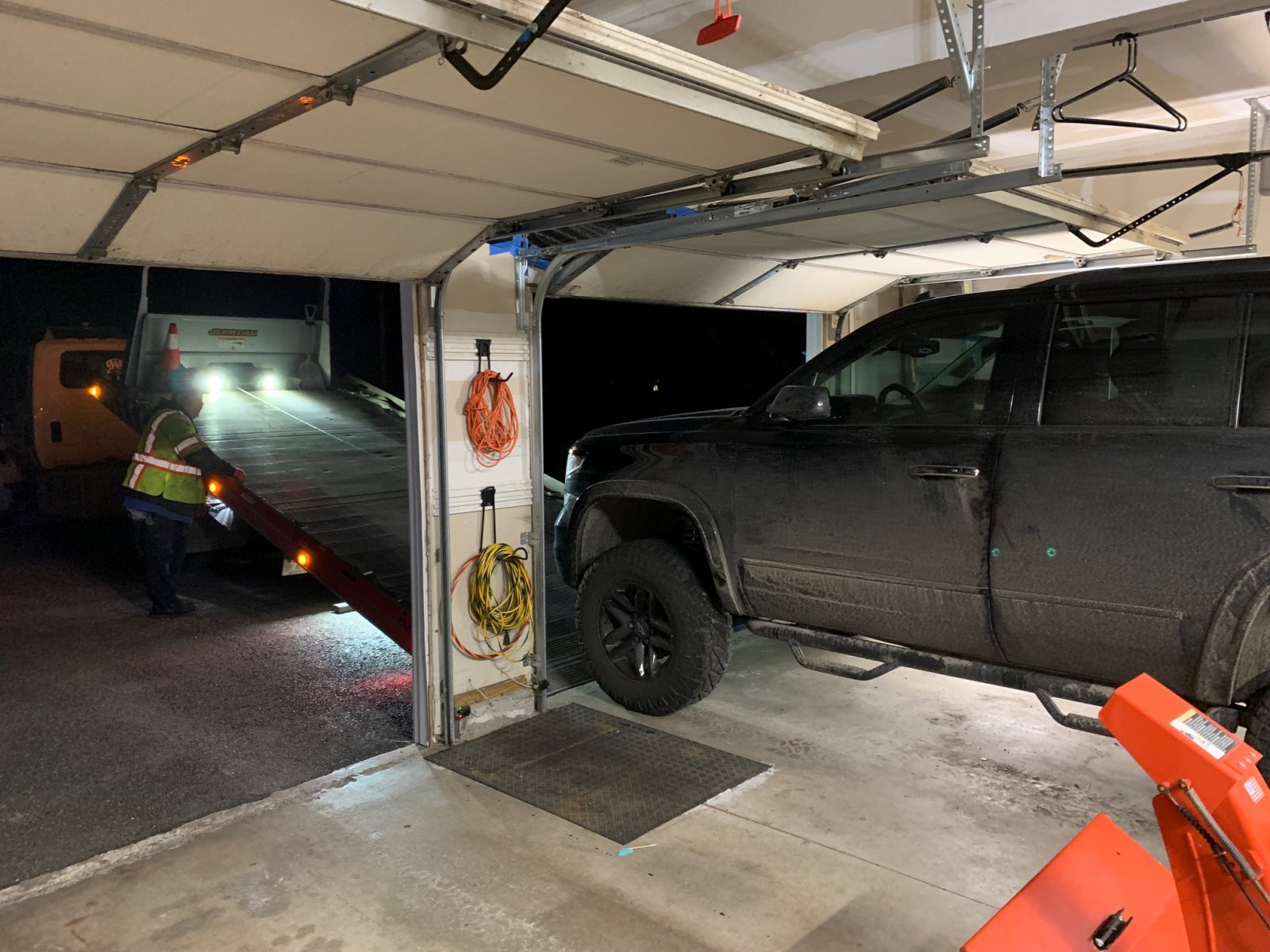

Towed successfully by AAA to local Chevy dealership last night. Took me and the driver about 2 hours to manually shift into Neutral and work together to winch up onto the tow ramp.
Pretty lucky to actually get it out I think, and thankfully no property damage - it was TIGHT! Literally centimeters away from top of garage door and garage frame...I ended up standing on a step ladder to "push" up the bottom of garage door for final clearance of top roof rails.
I almost found it humorous last night, standing in the freezing cold, as we winched up the Tahoe from the depths of my garage - I put a lot of effort into measurements and making sure garage entrance clearance wasn't an issue with my 4" lift. I never thought about having to tow the vehicle out of the garage!
I have to say, the driver did an amazing job and I was very impressed at the control he had over the rig, winch and ramp all at the same time, truly a learned skill.

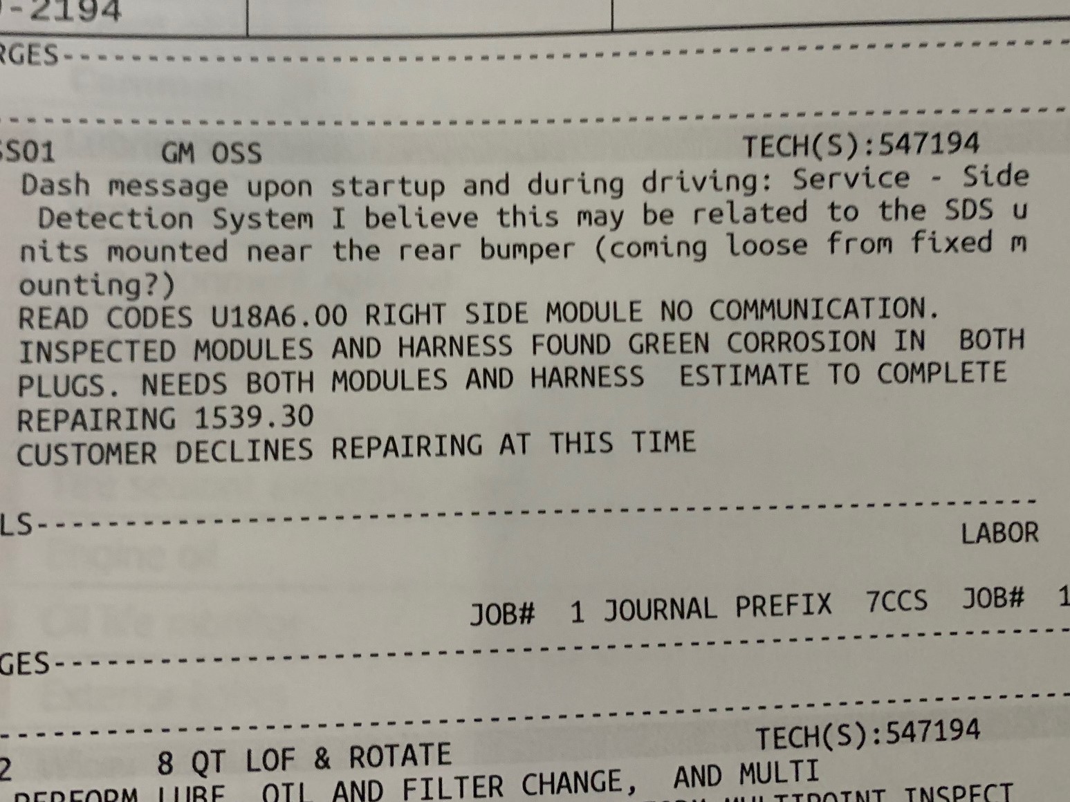

The result of my Tahoe not being able to start is due to electrical issues. The dealership told me that the vehicle had entered "crash mode," initiated with my failing rear side sensors, and running to the BCM, resulting in the experienced computer "crash."
Approx. 3 months ago I took the Tahoe into Chevy dealer with service message:
Service Side Detection System
They provided the following diagnosis:
As this repair only seemed to effect my side detection and I could easily dismiss the message, I decided to sit on the "problem" until I had the extra $1500 on hand to easily take care of this issue...
Fast forward three months to the past 2 weeks of crazy dash activities, normal battery and total loss of ability to start. I can't believe this is what Chevy dealer came up with:
After servicing, the Chevy service rep called it a "cascade electrical failure" triggered by the faulty rear sensor. I COULDN'T BELIEVE IT! I was lucky enough that the rear sensors were somehow covered under the extended warranty and then I had to pay for parts & labor on the faulty sensor harness/wiring.
