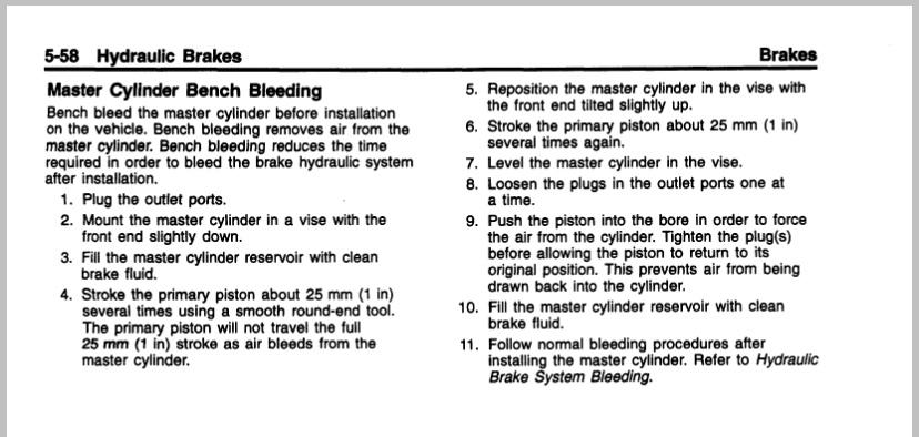

Not sure how many of these I've screwed up and how many bad ones I've gotten but I've been through this too many times now. I did not know that you should not do more than 1" stroke when bench bleeding. I might have stroked that one too deep, but who knows. A Cardone vid says 1" stroke and hold for 30 secs.

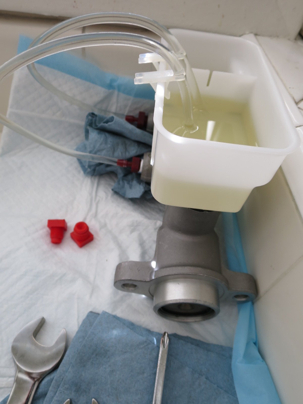

Bleeding new MC. I've always been in a rush to do this but it seems patience pays off. I give it a couple strokes, waiting at least 30 secs between each, and then walk away. When I come back 10-20 mins later air comes out with just 1/8" stroke. I thought I was done and walked the dogs for 20 mins and when I came back loads air came out. I think I'm pretty much done now and it's definitely the least effort I've ever had to put into it.

I had noticed that tilting it got air out. But haven't seen that. Thanks.

I didn't use the bleed kit and just followed the GM instructions. I think it's good to go.
Question: If there's air in the MC does it stay trapped in it or does it get pushed out when bleeding?
I've been under the impression it would stay trapped. but the GM instructions say it reduces time bleeding and is why I asked.
