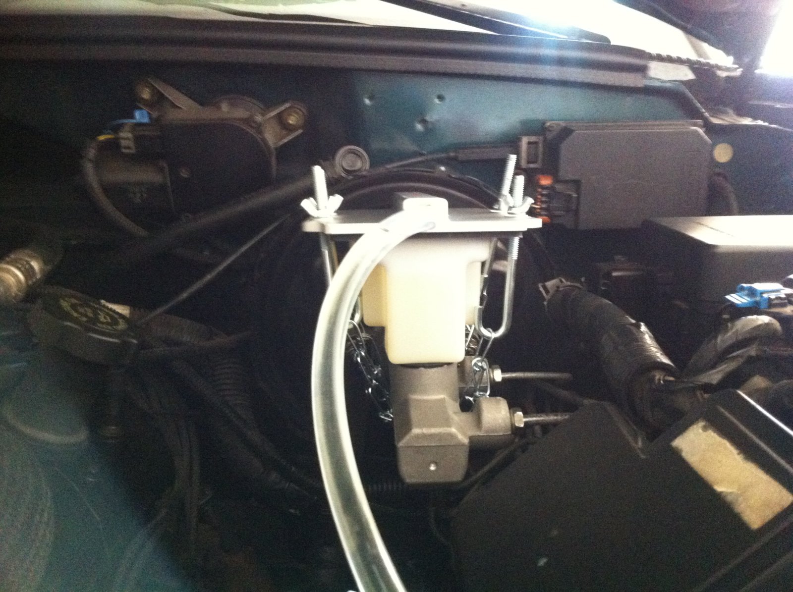

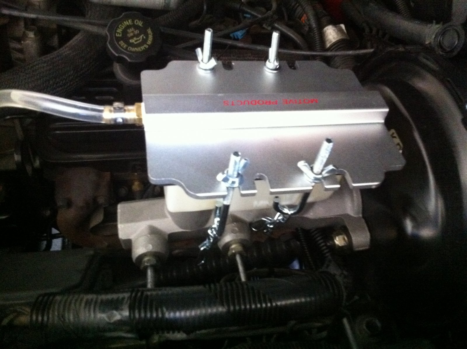

It is a PIA to get it to seal. Forget 15PSI. The more pressure you put in the reservoir just widens in the center and releases the pressure. If you can seal it at 7-8PSI it works fine. Of course I disfigured the MC reservoir trying to get to 15. Second time I put it on I put the chains at the back under the reservoir and the chains at the front around the MC. If the rubber on the plate was softer this wouldn't be an issue.
New MC, hours of bleeding, plus ABS bleed and the pedal still sucks. Am I missing something? Feels like I basically got nowhere today and used almost a gallon of fluid. Not a happy camper

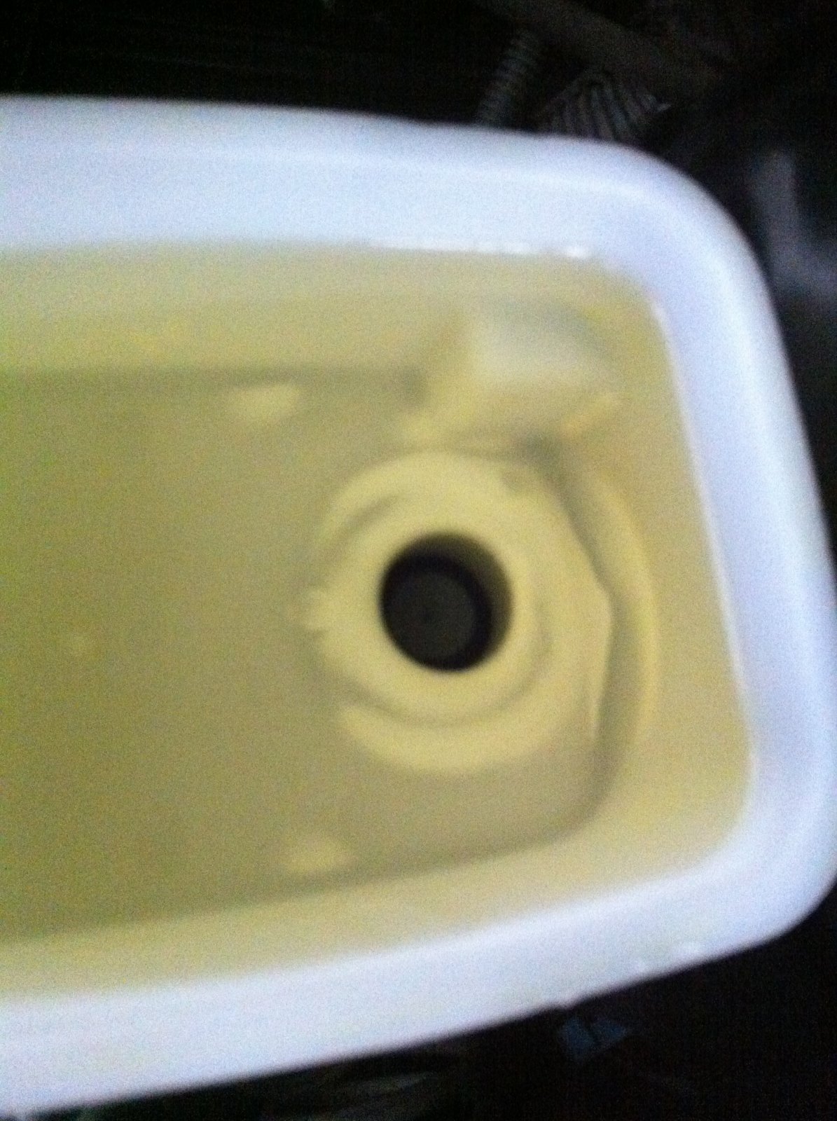

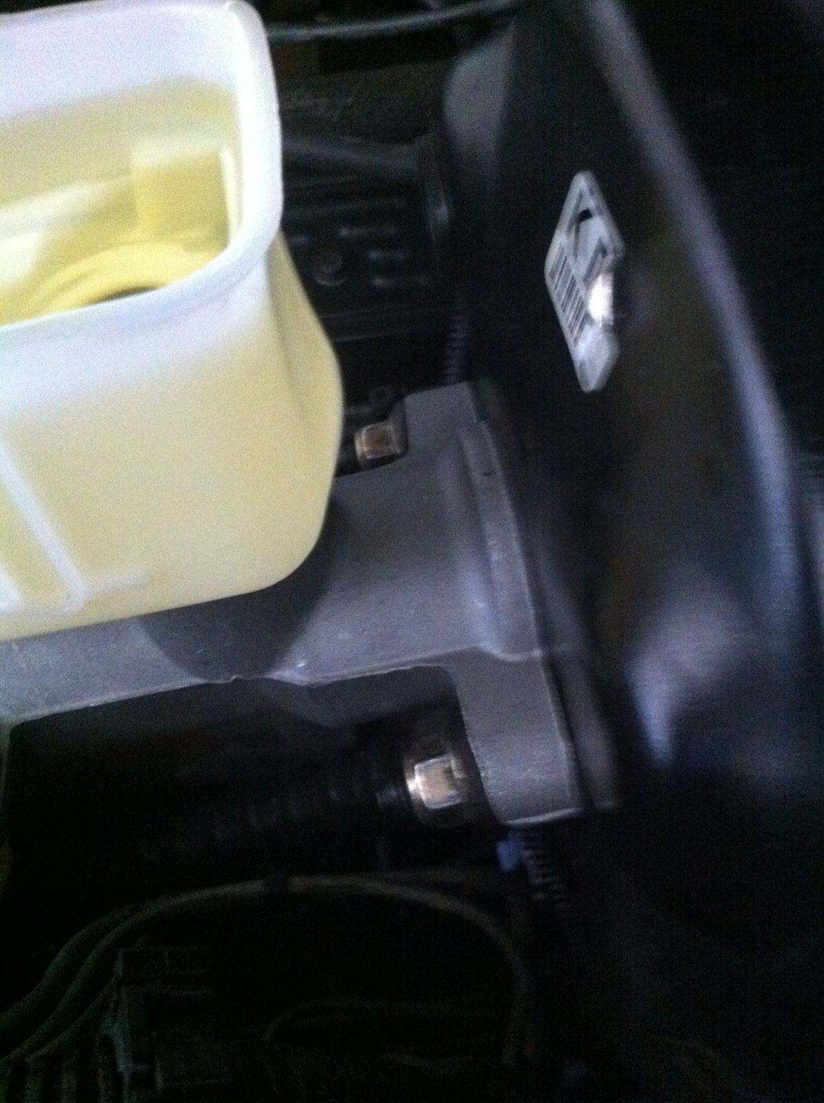

I spent a fair amount of time trying to get it to seal and did manage to get it to 12 PSI. But that's probably what screwed up the reservoir. After giving up on 15 I got it back to 10 without a leak, and then used it around 6-7 PSI. Fluid comes out at a decent rate. There's much less risk of letting it run dry and you only have to open the screw. Great for a flush. If I'm honest I was hoping for a bit more of a 'pressure bleed' though.
Mine was a bit lop sided the first time I put it on even though i was trying to tighten it evenly. Make sure it stays level
Here's the damage to the reservoir
Oh I forgot you had that style reservoir, I got the screw on cap.
