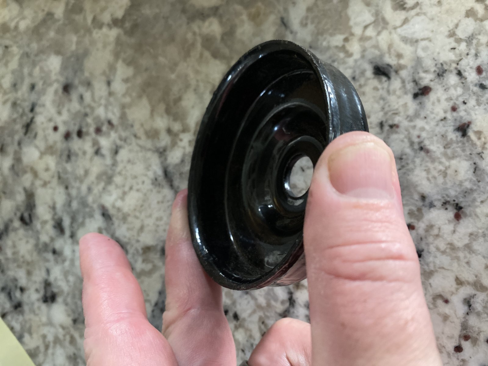

Glad I am seeing this, blown two sets of KYB mounts and trying to figure out why. What does this metal sleeve look like. Can’t find it shown on a parts diagram anywhere

Thanks for the info. Finally figured out what my issue was and fixed it today. I didn’t have metal sleeve that goes over the bump stop which push rubber portion of strut mount out of the mount. Found a used set of non-magneride struts and swapped over all necessary hardware to make 5100s work. I will eventually write a DIY on this since I only found bits of info and ended up learning the hard way and have taken my front suspension apart 3 times to get it right.
Was this the kissing sleeve you guys are talking about that comes Monroe Mounts?
