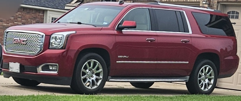

I replaced all 4 shocks with magna-ride-type aftermarket from O'Reilly myself, but I still get error message the suspension needs service. Do they need to be programed by the Dealer?
2015YukonDenali
Dec 11, 2025
To answer my own question, NO. Magna-ride shocks for 2015 Yukon Denali do not need to be programed after install.

But you shouldn’t have an error code if they’re factory replacements. Is it still there? If so mostly one of the connectors is off or loose.
Loki223
Apr 27, 2023
728
1,609
Elk, WA
Are you sure you got magnaride rears or did you get passive replacements that are generally much cheaper then the true active replacement shocks
