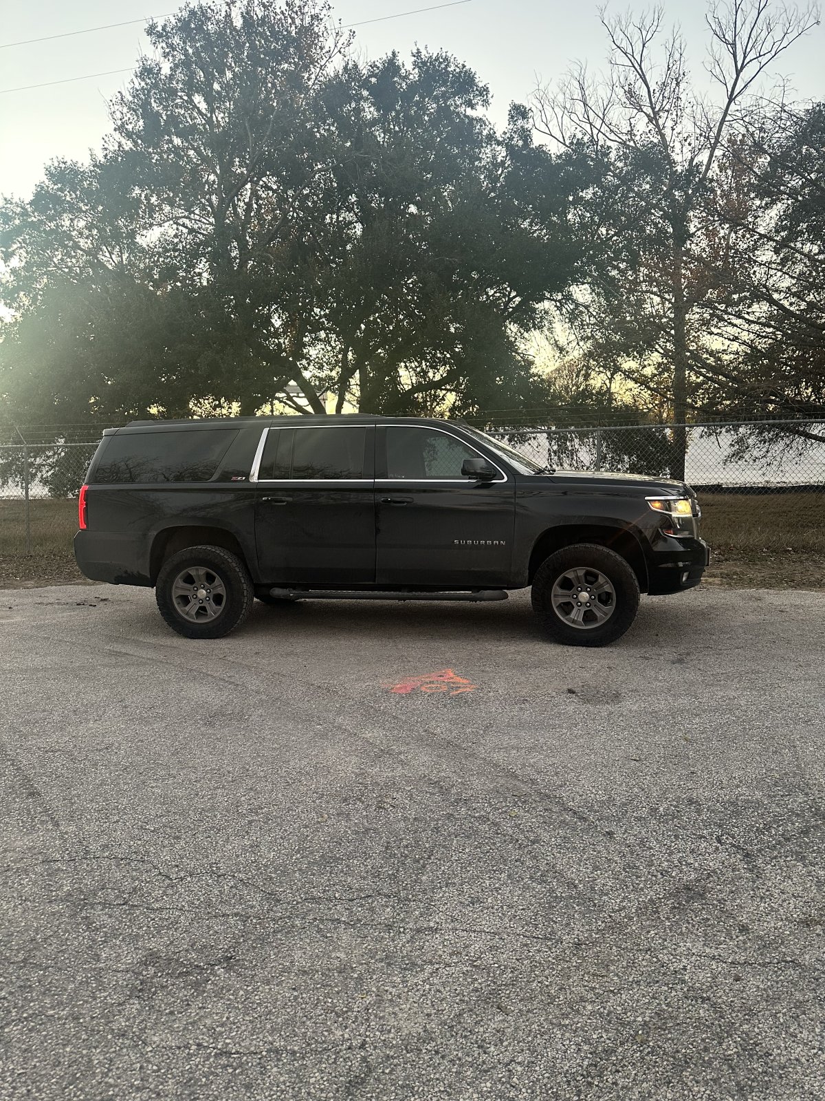

Hmmm, I didn't realize the z71 spring was longer...this has me thinking. I may switch out my springs. I have a 3 or 3 1/2 inch puck in the back and then a puck in the front that lifts it 3" but my front is just a little higher than my rear end (probably like 1/2 to 1") I bet if I put these springs on that would fix that issue (if my brake lines are long enough to handle it) they are already about as tight as they can be.
BoatsBros
Jan 2, 2025
8
The Z71 springs have different spring rates than the other trims. I just did the 5100’s on front adjusted all the way up, and 5100’s in the rear with a 1” spacer. Rides better than factory!
