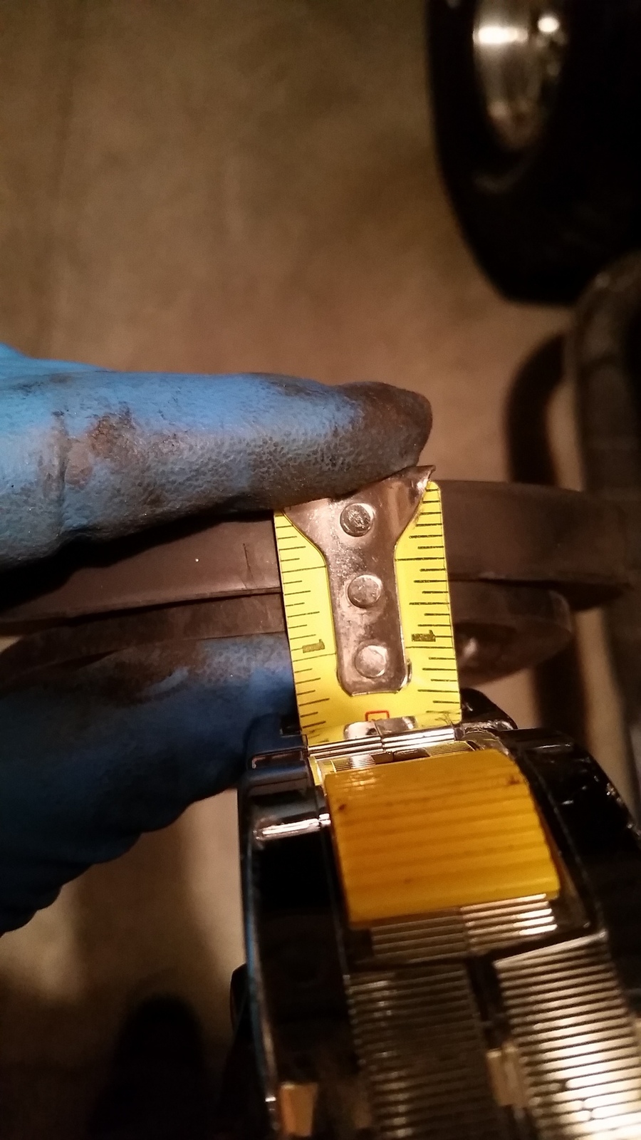

Did the free tavel mod on pass side bracket cut off which gives 3 more inches of travel finish up drivers side tomm
insulators on these things are big. I just wrap heater hose on top and bottom coils on them but the oem ones give the truck a 13/16 lift

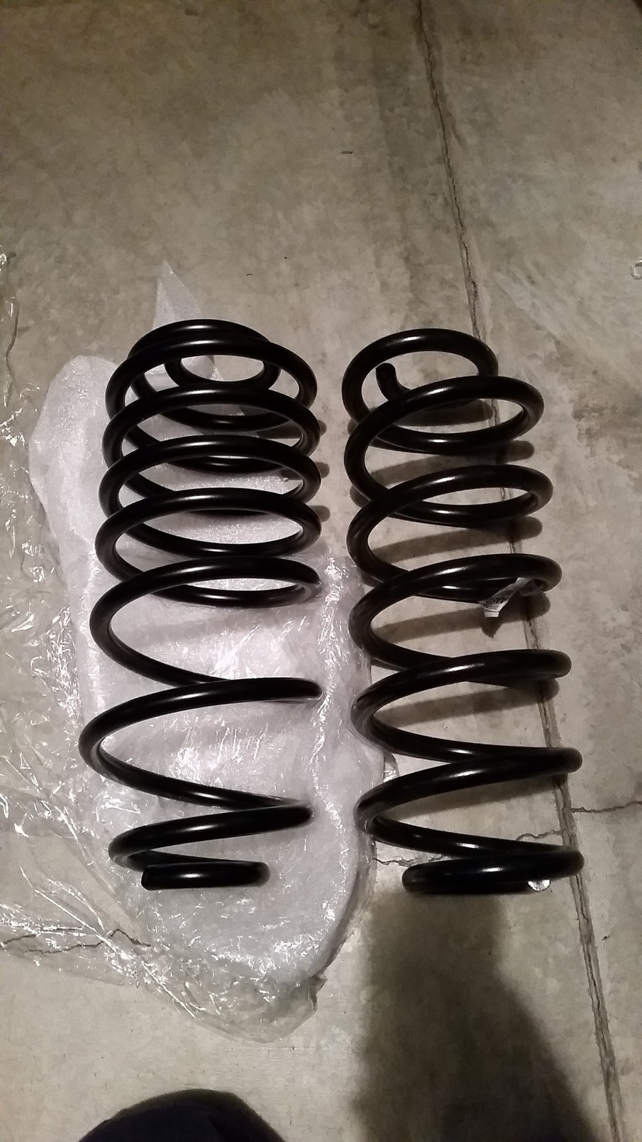

Belltech 5305 coil left vs oem spring right. Yes i had the belltech springs coated to match oem. OCD strikes again
