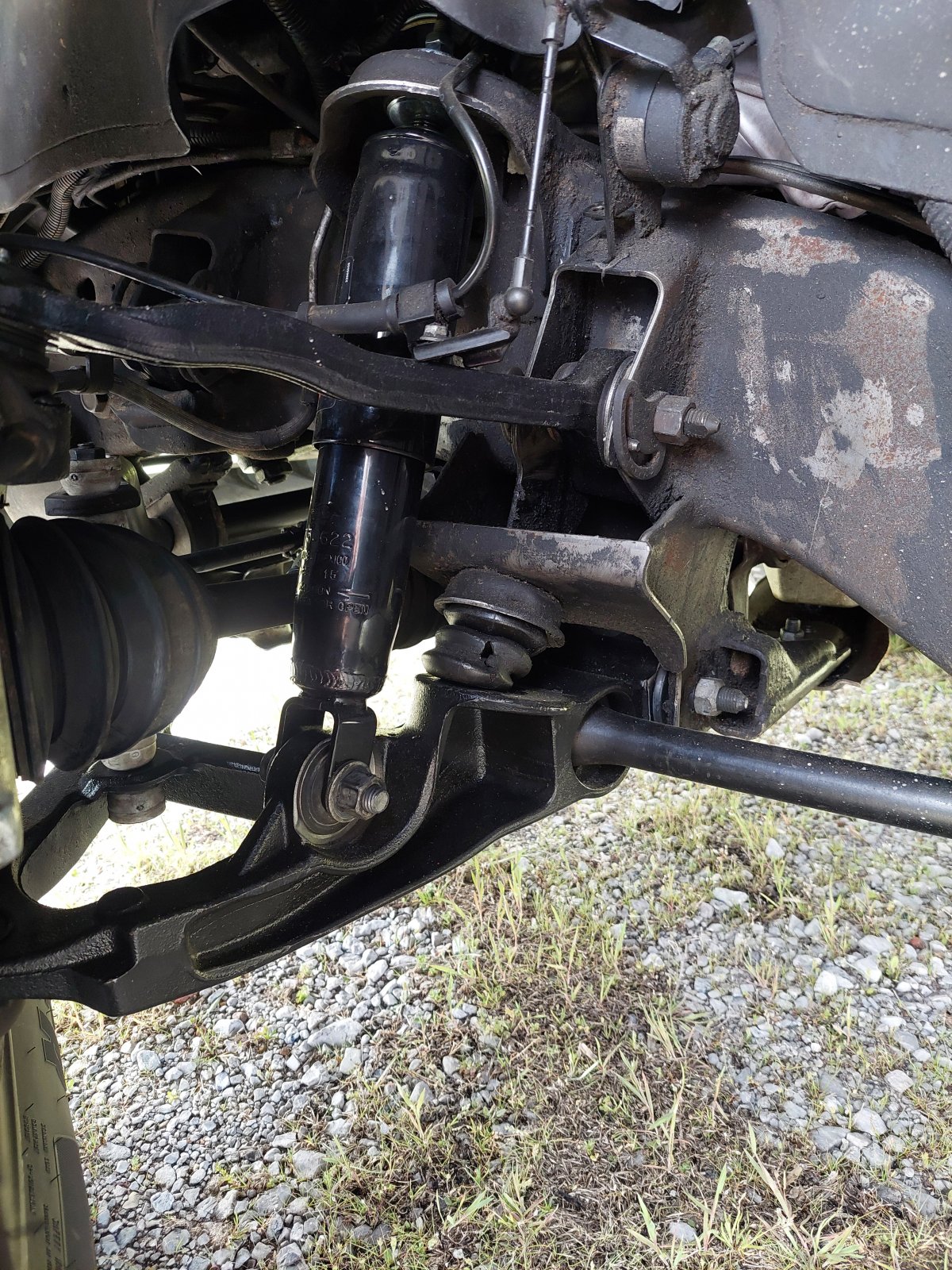

I'm in the process of replacing frontend suspension due to bad ball joints and tie rods. This yukon has a lowering kit on it, maybe 2 or 3 inch drop. I'm wanting to bring it back to stock. It doesn't ride smooth, i can feel every pebble. Not sure where to start or what parts to buy. Any help appreciated in advanced

OK as a byproduct of replacing top and bottom control arms, sway bar link and tie rods, the front appears to be back to stock height. I don't think the shocks on the front were replaced when it was lowered as they are delphi, but I could be wrong. I was a bit concerned the moog sway bar link would be a different size but it was the same. Any concerns I should have with the front raised back to stock while the back is still low? Will post pics later.
Needs an alignment bad, front tires are visibly not vertical lol.

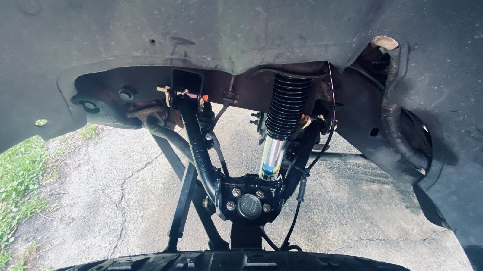

OK I'm still looking to bring the front up to stock height. I noticed I am riding on the bump stock, is that normal?

I appreciate the info. What would I need to purchase to restore stock height at the front, considering the parts I've already installed:
Upper and lower control arms
Shocks
Tie rods
Sway bar link

Looks to me, stock keys and adjustment and that should bring you back up
