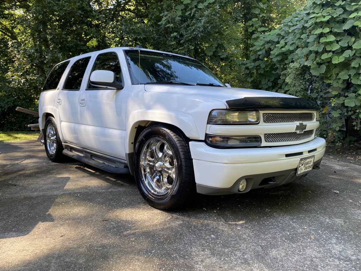

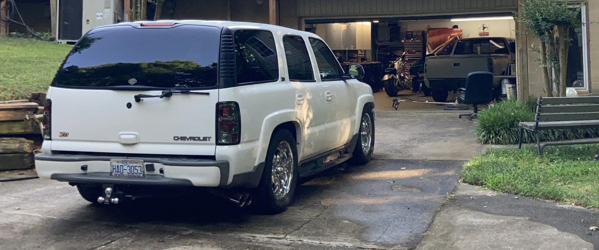

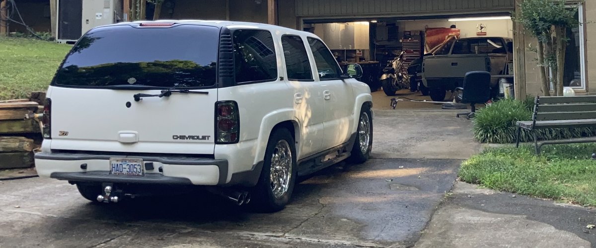

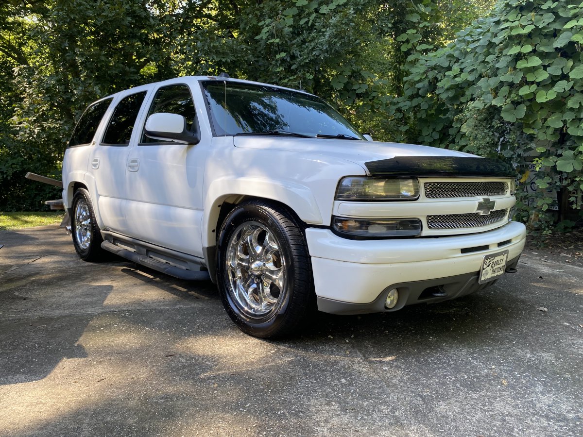

Mine 5/7 with Belltech keys and spindles,moon 4*UCA’s free travel mod springs shock extenders belltech shocks swaybar and adjustable panhard bar. If that helps
I like the look although it might be a tad low for my country driving.
It prompts a few questions:
Keys and spindles? It is an aggressive drop and I can see the need for both actually.
I can't say I familiar with the description "moon 4*UCA’s" although I gather that's an offset upper control arm that compensates for the lowered front end?
The rear is still just springs correct? (with the obligatory shock extension).
I understand why the extensions are needed but seeing as I'm doing shocks all around, I'd rather get units for the rear that are designed for the new travel range heights. I said that before and I also said "on the cheap" so I get the extensions approach.
Thanks for the post.
