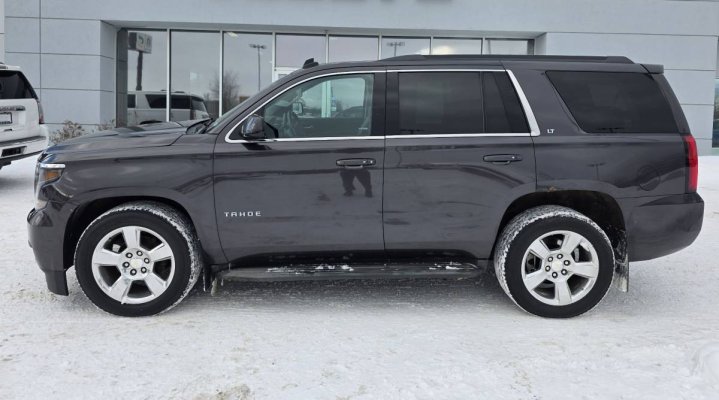

Hi Forum, I appreciate the wealth of knowledge that's shared amongst this community.
** I am going to preface this thread by acknowledging that the situation I am in is of my own doing; I was fully aware of the gamble.**
I recently purchased a wholesale 2015 Tahoe with 206K on it; I drove the vehicle initially, it was EXTREMELY clean inside, and I liked it well enough to have a pre-purchase inspection done by a local, respected Chevy dealership. The dealership was great to work with, and I felt like they went above and beyond after speaking with the service adviser. He went over the inspection report detail by detail, and the only noteworthy items were a passenger side seat heater not operational, and they suggested changing all fluids, which was always part of the plan. The adviser even went so far as to tell me that his head transmission tech went on the ride-along and voiced no concerns. I was fully expecting a laundry list of items that needed to be addressed with an accompanying estimate. But. The rig passed with flying colors. They even provided the (CLEAN) Car Fax and all of the GM service history.
So. I bought her.$8500 out the door.
Fast forward 5 days. I made an appointment at a local shop to have an LOF and a transmission fluid swap. Imagine my surprise when the shop called to say the vehicle is slipping in all gears, the fluid is burnt, and I need tie rods and ball joints. They quoted me just over 7K in repairs, including a reman transmission.
I'm not sure what the trajectory of the thing should be - I almost feel like I need a 3rd opinion? I have the money to throw at it, so that's not my hesitation, but even if I put a new transmission in the ole girl, she's still a high-mileage SUV that I don't particularly love. However, I am replacing a 2003 Yukon with 287K and still climbing - so I'm certainly not accustomed to the bells and whistles, and it's not like I've been driving my new problem child.
There's a repo auction site near us, and I ran comps on what Tahoes/Yukons in similar condition are bringing. I could damn near break even on the thing, but that feels like a shady thing to do.
Thoughts?

got pics? what area is this from, any rust? looks ok from the 1 pic, but.....
