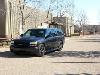

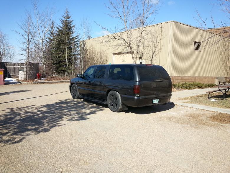

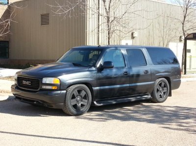

Z71 bump/jounce stops did give me 1/2". Modified my springs to sit closer to level until Tonys' next batch is ready. At least able to align tomorrow. BTW; how long for those? Couple pics:
