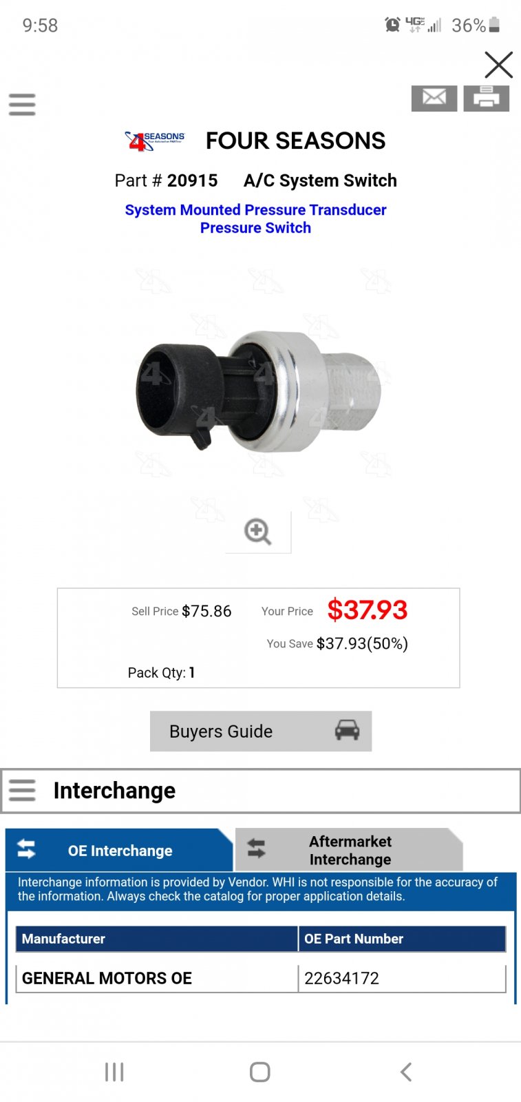

You should have what they call an "AC Pressure Transducer" mounted on your receiver/drier.

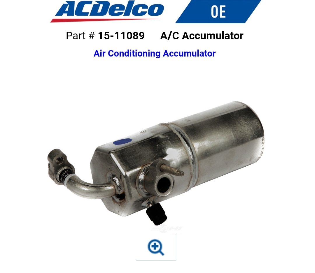

That strikes me as very very odd. Every single listing in my parts catalog has a switch of some sort on the drier. Can you post a picture of your drier?

Thank you for posting that. Does the refrigerant need to be evacuated to change the switch?
Not that I am aware of. There is a valve in the port that the sensor opens as you install it. You may get a little puff of refrigerant as you are removing the sensor.
