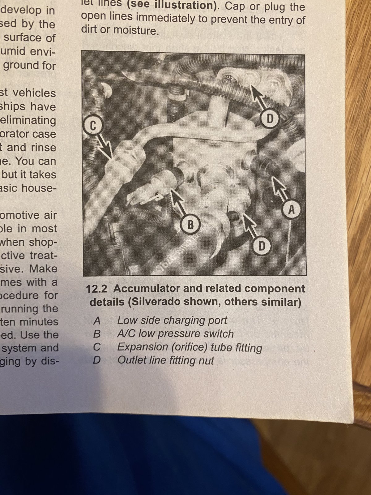

I’m happy for any advice: this is what has been done so far.

When I was first looking at this, I was pretty sure that I followed that line, with the pressure sensor in it, from the compressor to the condenser, which lead me to believe that it is a high pressure cutout. This is where Im so confused on this one.... the picture posted of the service manual labels the "low pressure" switch to be right by the filter/drier which on the truck is in the discharge line.
Every where I look try to look at different schematics, they all show that pressure switch in the line with filter drier and this line is labeled as the "discharge line".

What service manual was the picture taken from?
My 13 lt with rear Heat/air has it right there, like the pic and fwiw it is called a low pressure switch/pressure sensor
Where have you seen it called a low pressure switch? Other than that service manual picture. That line runs from the compressor to the condenser. When the compressor is running, that line is hot. That tells me it is in fact a high pressure switch. If it were a low pressure switch, it would either be on the suction accumulator or in line between the suction accumulator and compressor and would feel cold and sweaty while the compressor is running.
I dunno, I lookeded at the pretty pic then poppeded my hood and didn’t see another switch In mine....my baddddd
The picture does says low pressure sensor and not low pressure switch.
My manual shows the low pressure switch on the accumulator but my 2013 doesn’t match the picture so I give up.

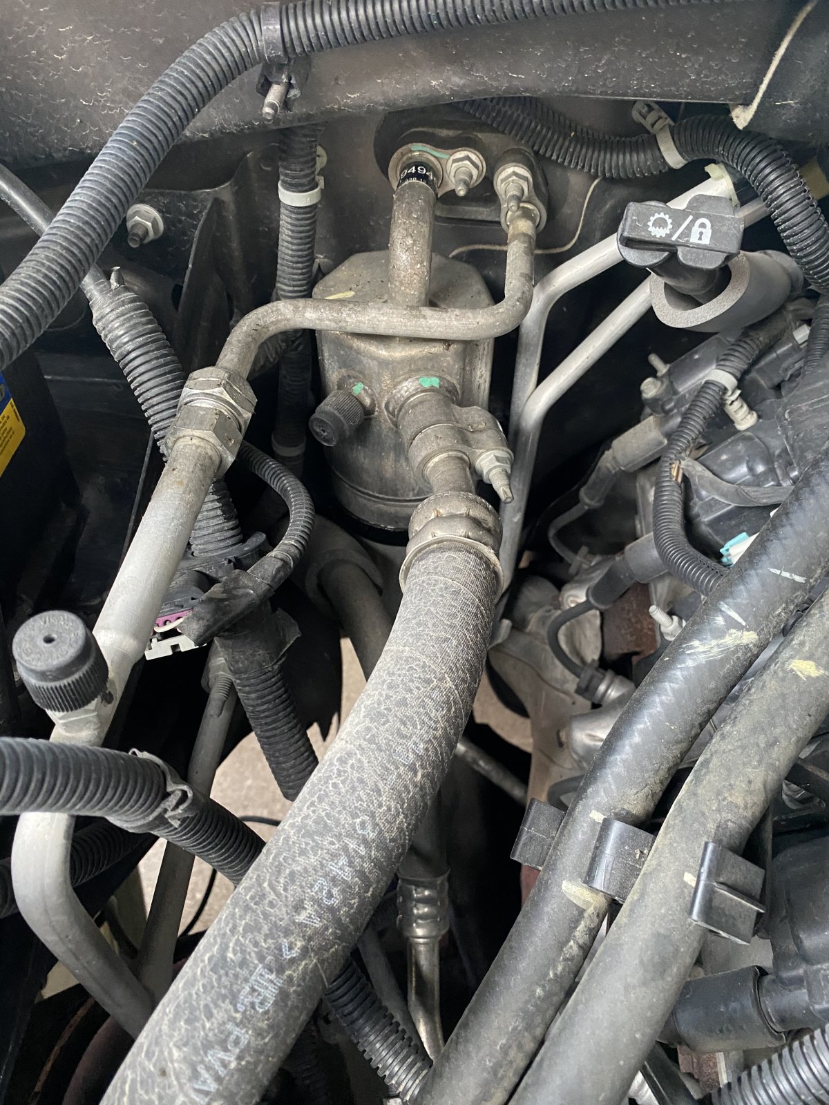

Found a pic in my phone of my low pressure switch on my '08 Burb. Mine is on the accumulator...
