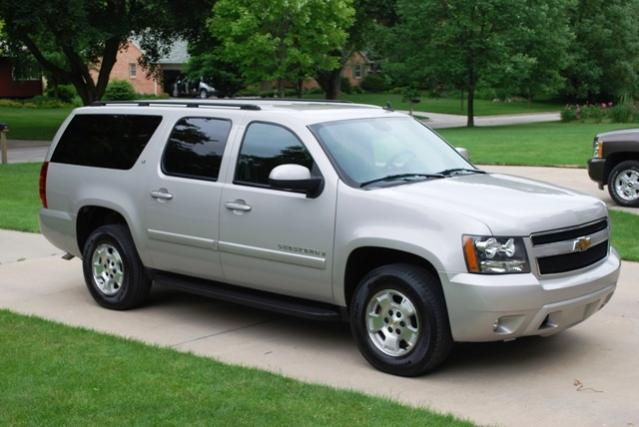

Today I was driving my 2007 Chev Suburban LT (5.3) when all of a sudden this alarm went off and the DIC text read 'engine oil pressure low stop engine now'. My Burb has never once dripped a single drop of oil or any engine issues. I pulled of the highway at a convenience store and added some oil (wasn't that low to begin with). I started the Burb back up and oil pressure went just past 40 where it most always is. I drove it down the street only to watch the pressure gauge fall and fall until the alarm went off again. Drove home and parked.
I just got the Burb completely detailed yesterday. I mean evrything. Even sgteam cleaned the engine bay. Trying to sell it. Has 152k on it.
Any thoughts as to what is happening with the oil pressure?:emotions122:
