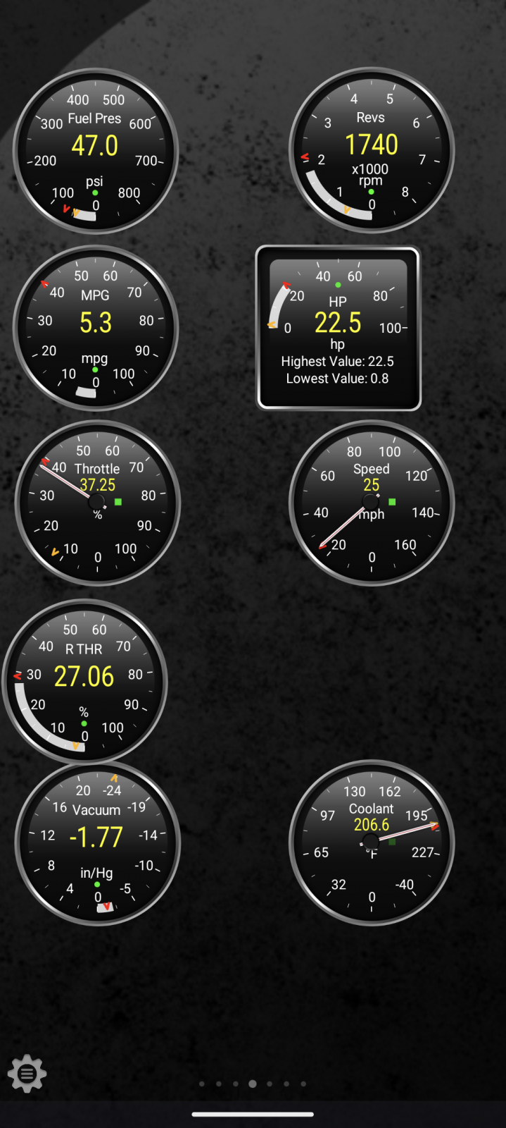

I have a 2015 Yukon Denali with the 6.2 and the car seems to drive normal, however whenever the accelerator is really pushed at all its as if nothing happens at all. It is as if there is almost no horsepower. The engine does rev up high but slowly and seems to shift normally. I have an OB2 and the torque app and looks like fuel pressure is normal the throttle all seems normal the only thing that seems not normal is the HP reading. Im not sure if that is even accurate but the highest I got it to go was maybe 50 HP at 3500 RPM. Also the car has no codes at all and no check engine or anything out of the ordinary.
