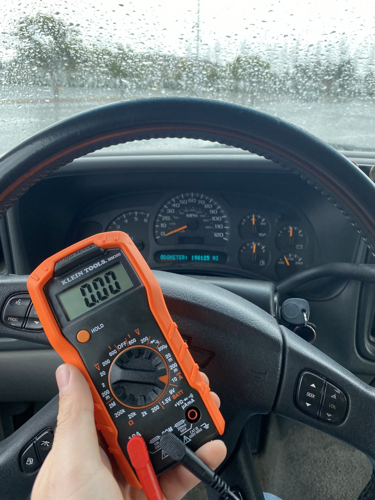

Can you show us a pic of the ammeter you're using, with the scale selected that was used when the ".01" value flashed on and off? Perhaps also show how the cables were connected (plugged in) to the meter?

Thank you to those who have replied so far. The multimeter was set to its 10a setting. I know that the multimeters fuse is good because it initially reads high when the computers systems cycle, but it falls to a very low number. I was worried to put it to the 200ma setting because of that initial spike being above 200ma, so I didn’t know if it would blow the multimeters fuse (but I did think of tying the system together with jumper cables to get past that initial spike, then attaching multimeter and disconnecting jumper cables. Not sure if this would work like it does in my head).
The past couple days I’ve been driving the truck around, paying close attention to check the batteries voltage at different times. I disconnected the battery last night, and it fell from 12.56 to 12.46 overnight, so now I know that this new battery I bought isn’t in the best shape anymore. I plan on leaving the battery connected tonight to see the effect it has.
