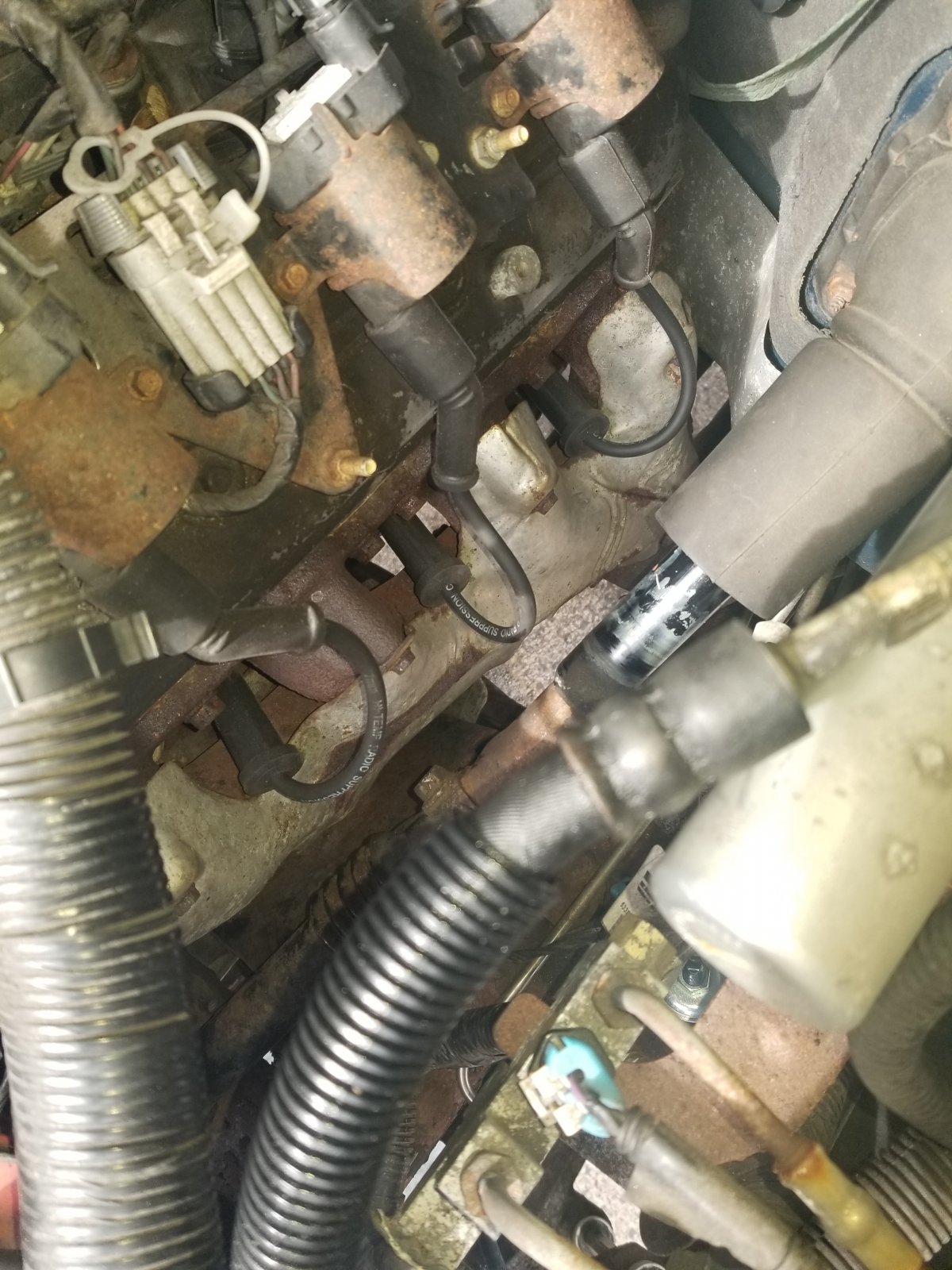

Hi so I'm replacing the pitman and idler arms today. However when taking the lower steering shaft off the gear box the intermediate shaft slid out a bit. It's still connected to the steering wheel. I've tried for an hour to line it up and push it all the way back in but it's not going anywhere, it feels like it's as far back as itll go and wont go any further. Any suggestions?
Also got this fixed too, removed the steering shafts out and hammered on it. It went right back in and slides back and forth as it should!
