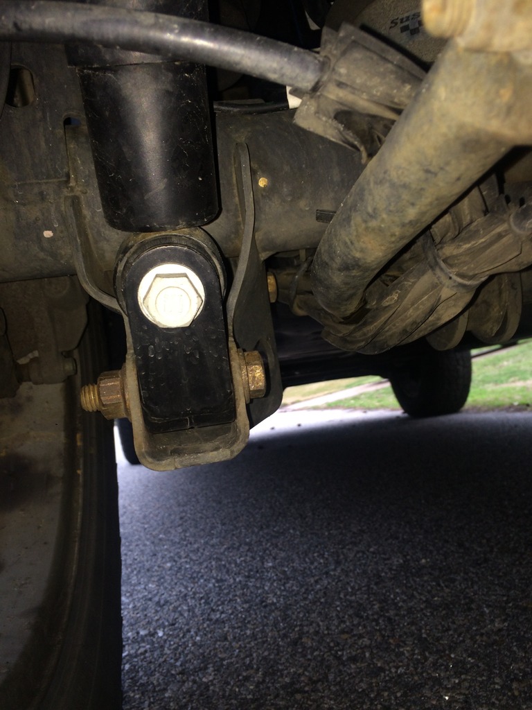

I got the shock bolts from another dealership in town. Installed everything and the damn compressor still won't turn on. I'll start another fix thread on it.
fishingwizard
Nov 10, 2015
72
Pics -

Were you able to rotate the air shock or did you use two extenders per side (1 top, 1 bottom)? Reason I ask is I've never had a pair of air shocks that can spin for alignment. Those shock spacers are generic and can find them on ebay cheap. Really only need to get FTS ride height rod spacers.
Looks like the ride height sensors are in the correct position to activate compressor. Have you verified power to the compressor and fuse under hood in panel? Once verified it should all communicate with the suspension module and BCM.
