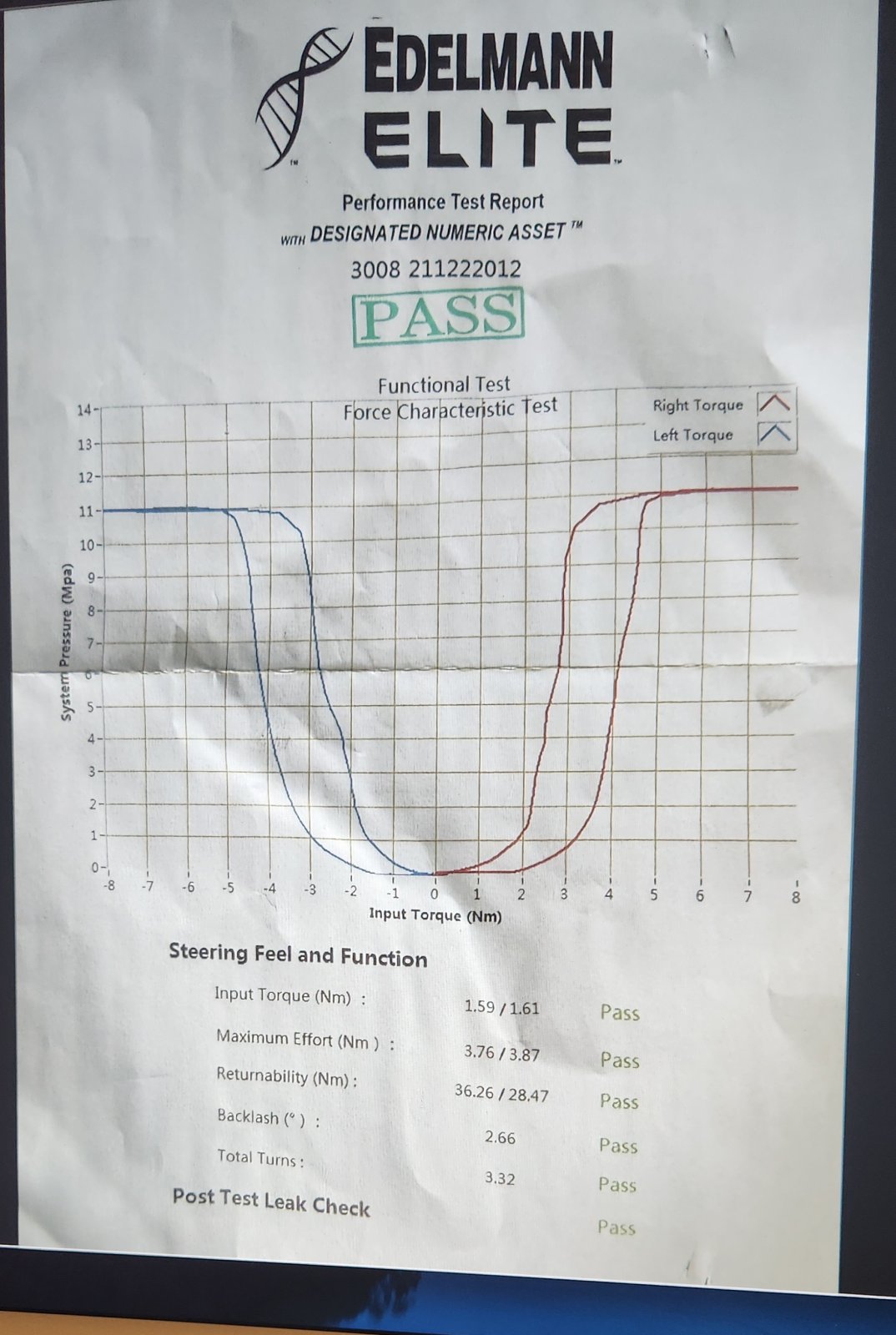

I have your answer….. “ Plews & Edelmann”. I got their ‘Edelmann Elite’ steering box Just 2 months ago.
It is BRAND NEW, all components NEW, they resolved all the OEM defects ( will never leak, etc )….
Their warranty is : 100 years / 1 million miles...
Hand built in the USA. It is also ‘dyno’ checked w/ the dyno sheet.
It is a PERFECT steering box. Amazing steering control.
It cost about $950.00 with their pitman arm.
WORTH. EVERY. PENNY….. It performs NOTHING like a mass-produced box.
THEY DO NOT REQUIRE A ‘CORE CHARGE’….. Because they do NOT refurbish them….. EVERYTHING IS NEW INCLUDING THE HOUSING.
Any steering box that sells for under $500.00 is a refurbished box ( with the old GM defects still )
>> You will be relearning to hold the steering wheel straight & still at 75 mph… No “micro- corrections” anymore..
And your ‘left-right’ maneuvers will be precise.. A world of difference from a factory box.
( Oh yea….. It’s in my 2005 Yukon XL )
They make them for older trucks too.

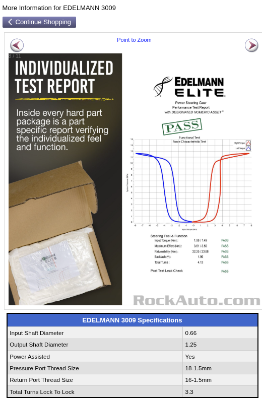

Their box is on rockauto for 535 with no core.

@mountie Apparently same as yours. Your mechanic probably up-prices them for you, as do most indy shops.
Rock Auto……. The “ $535.00 “ price does not mention anything else until you go to “cart".. Like shipping a 45 lb package, plus sales tax, and, you have no recourse for a defect, and no warranty from Plews & Edlemann. If Edelmann box is purchased from a certified distributer, you will have the warranty. Rock Auto is not a certified distributer for the “ complicated parts”.
UPDATE….. MY HIGHER PRICE….. “ OVERNIGHT SHIPPING”.
