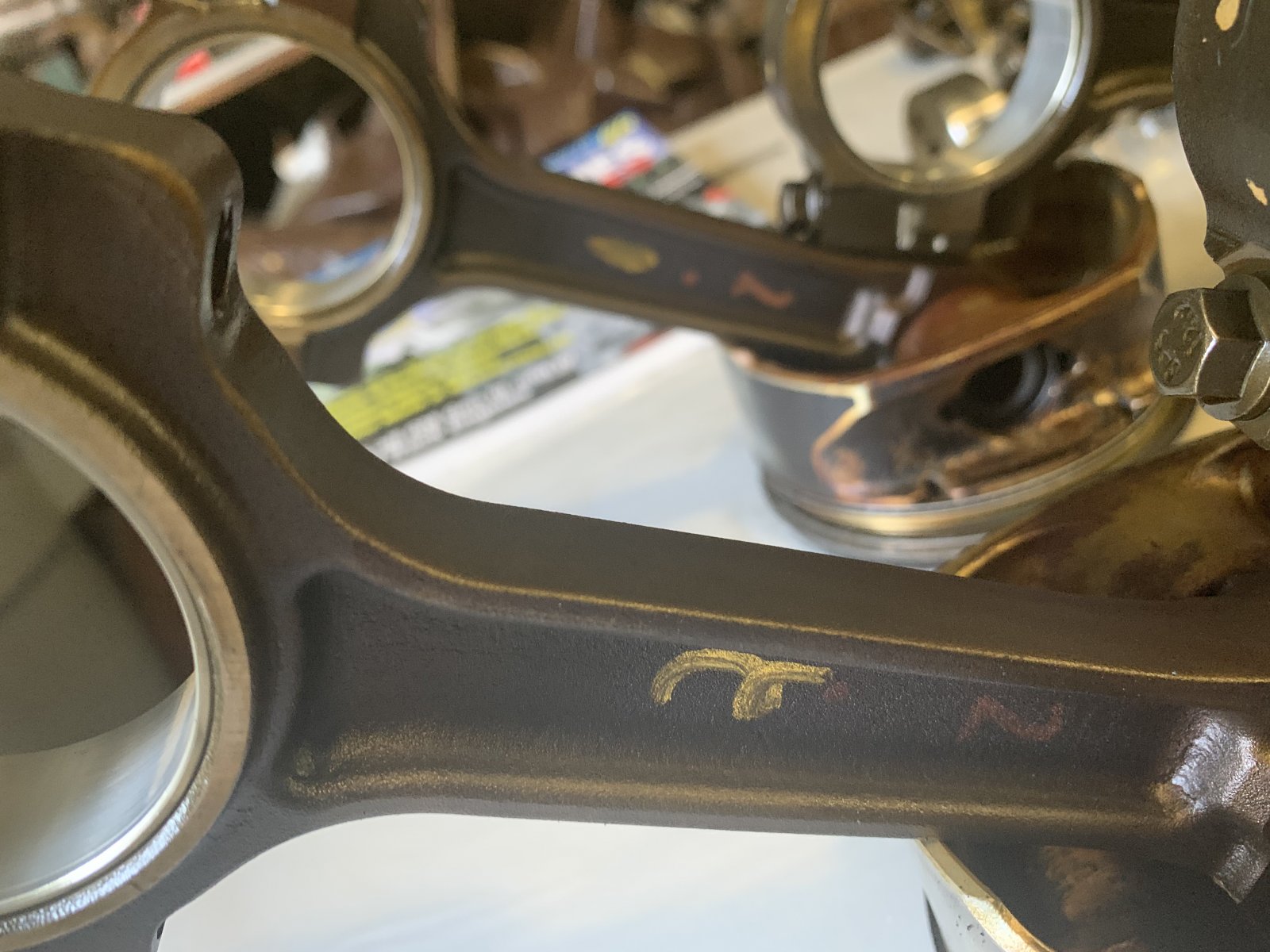

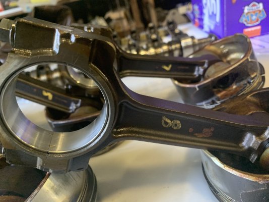

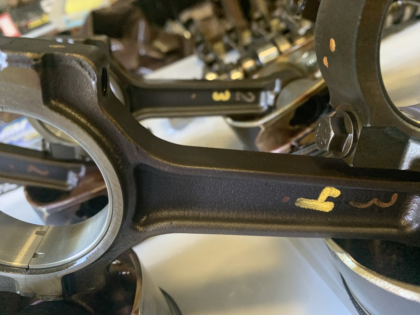

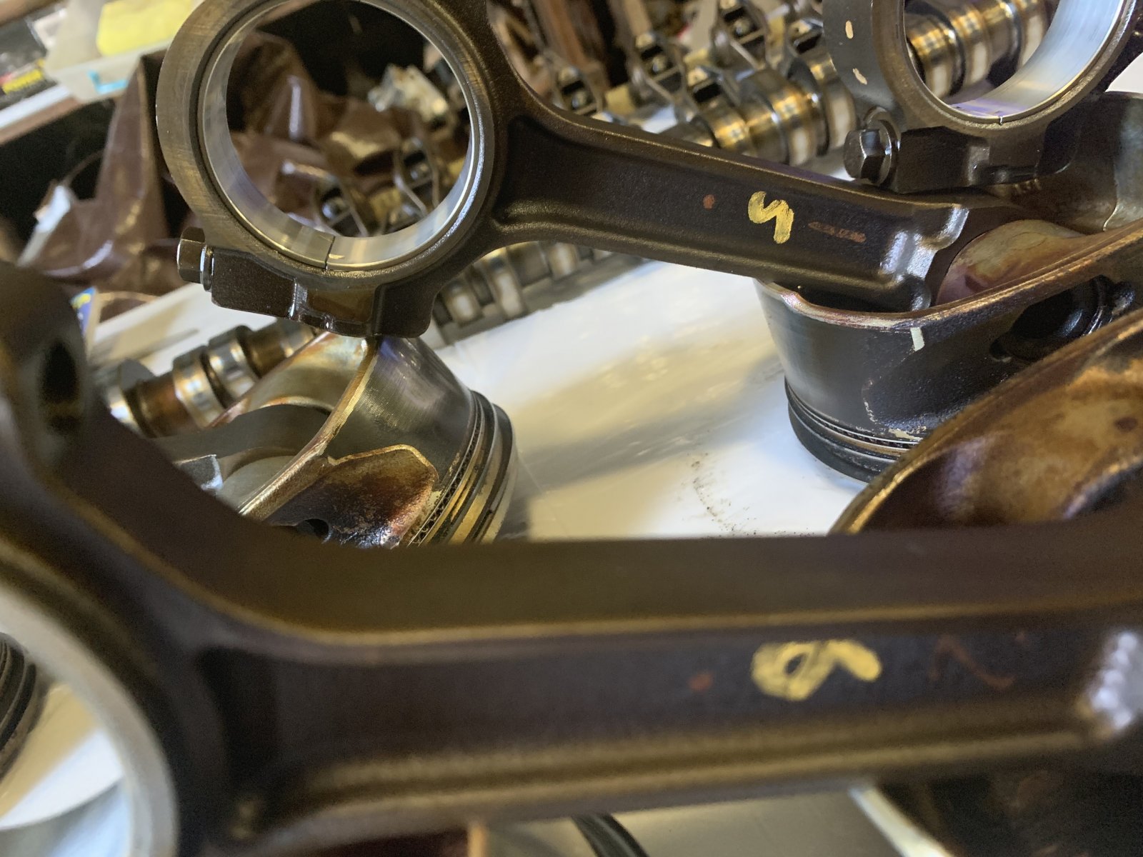

Well the mystery deepens…….WTF?
Someone suggested the paint marks were from the factory. These one’s most definately are not. The bright yellow is my markings as they came out of the holes.

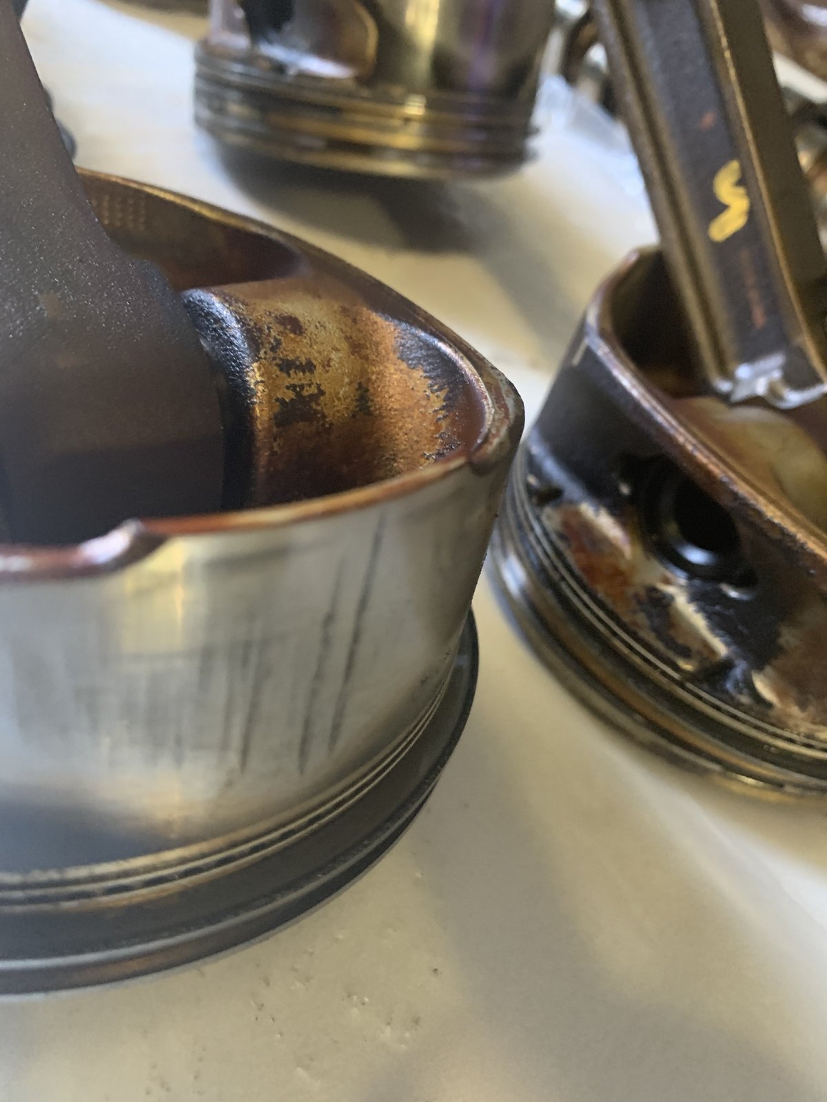

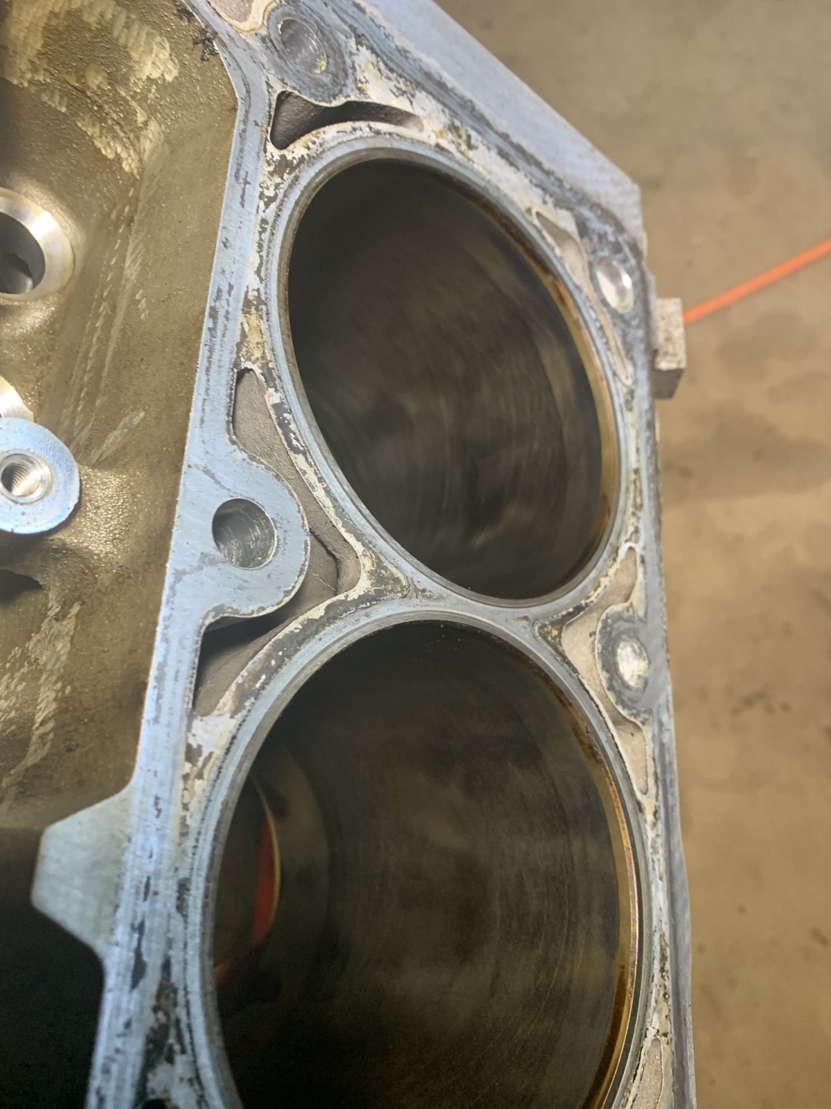

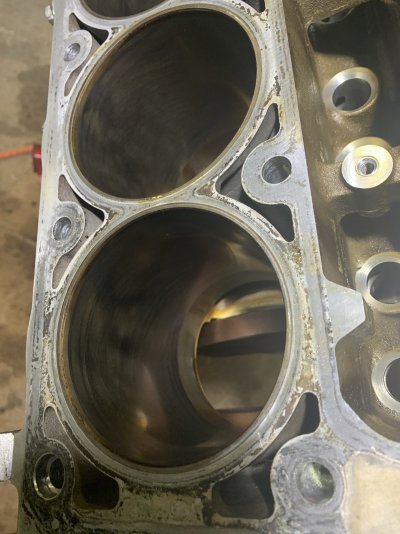

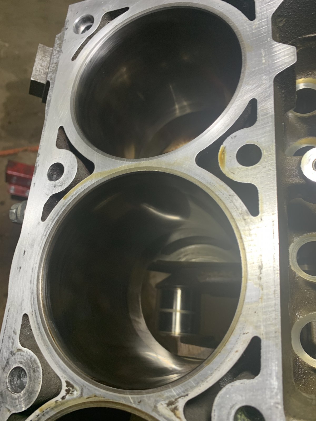

Cylinder walls…..#1 definately the worst of the bunch

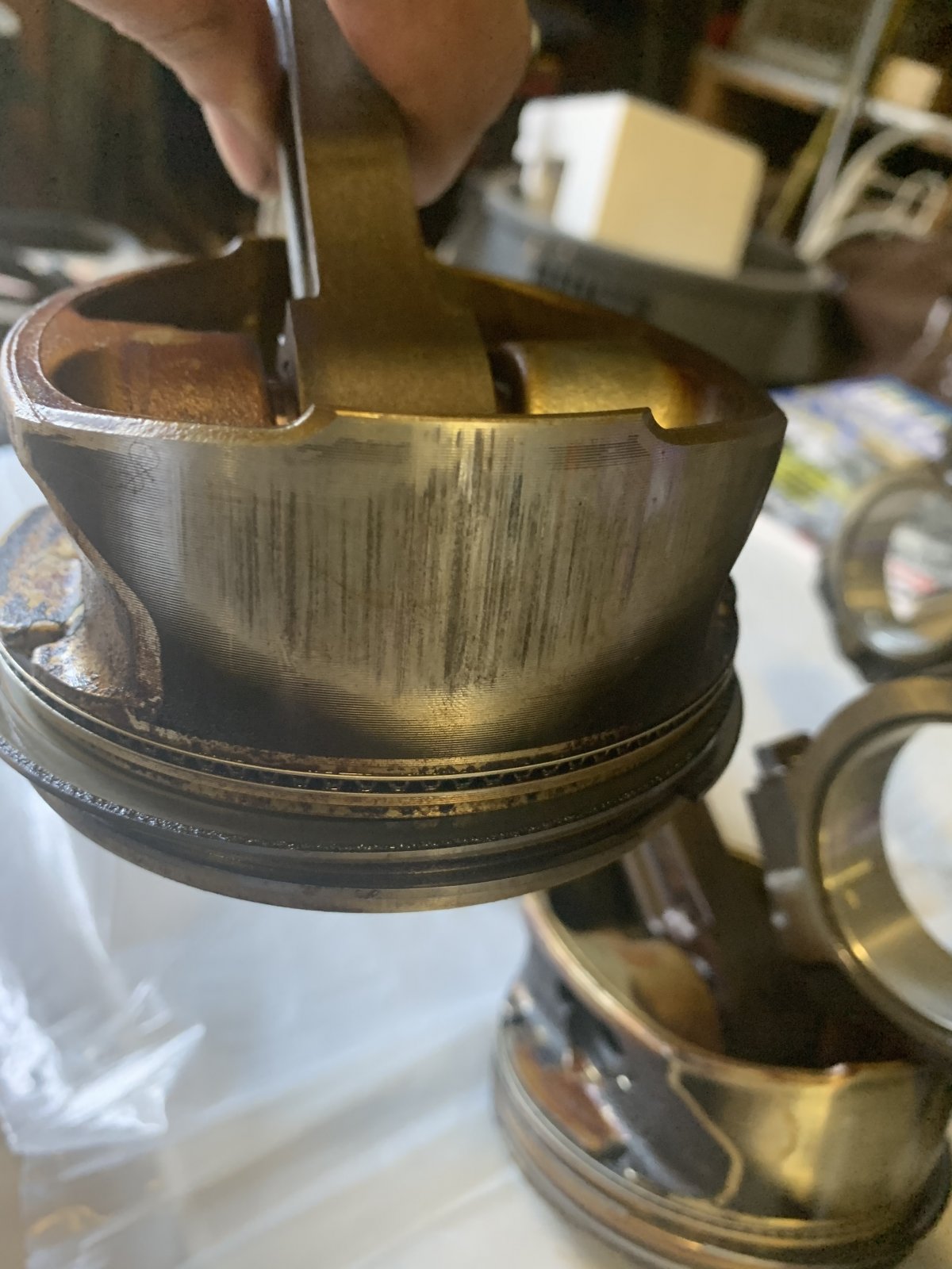

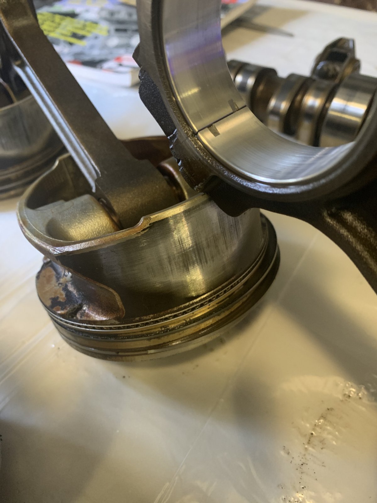

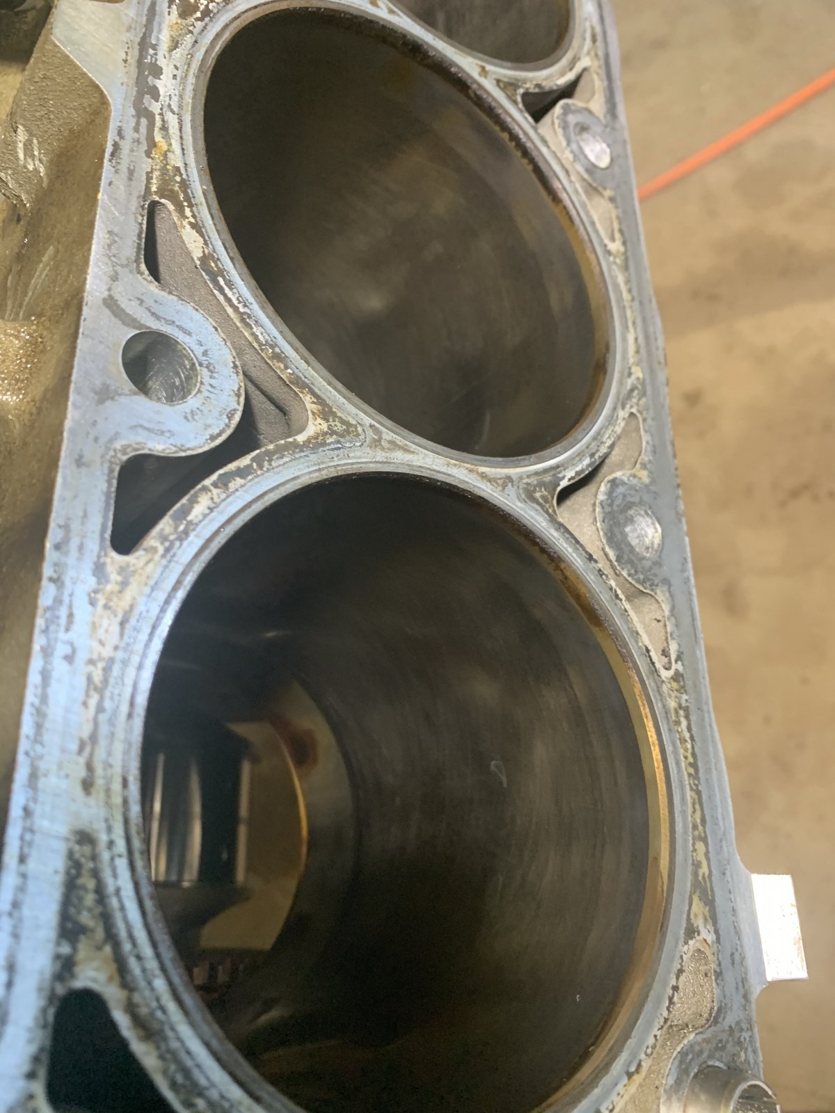

Don’t like the scoring on the skirts but I understand this is common. Again #1 is the worst

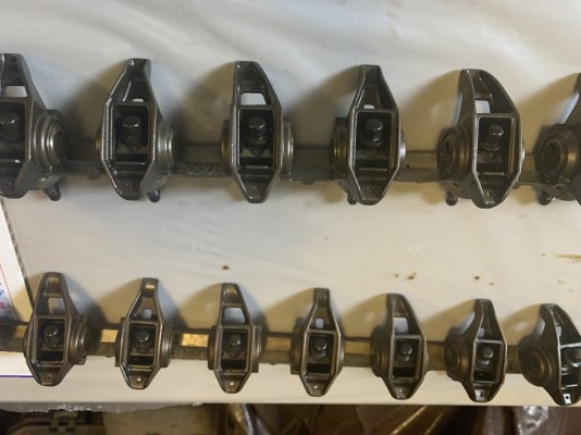

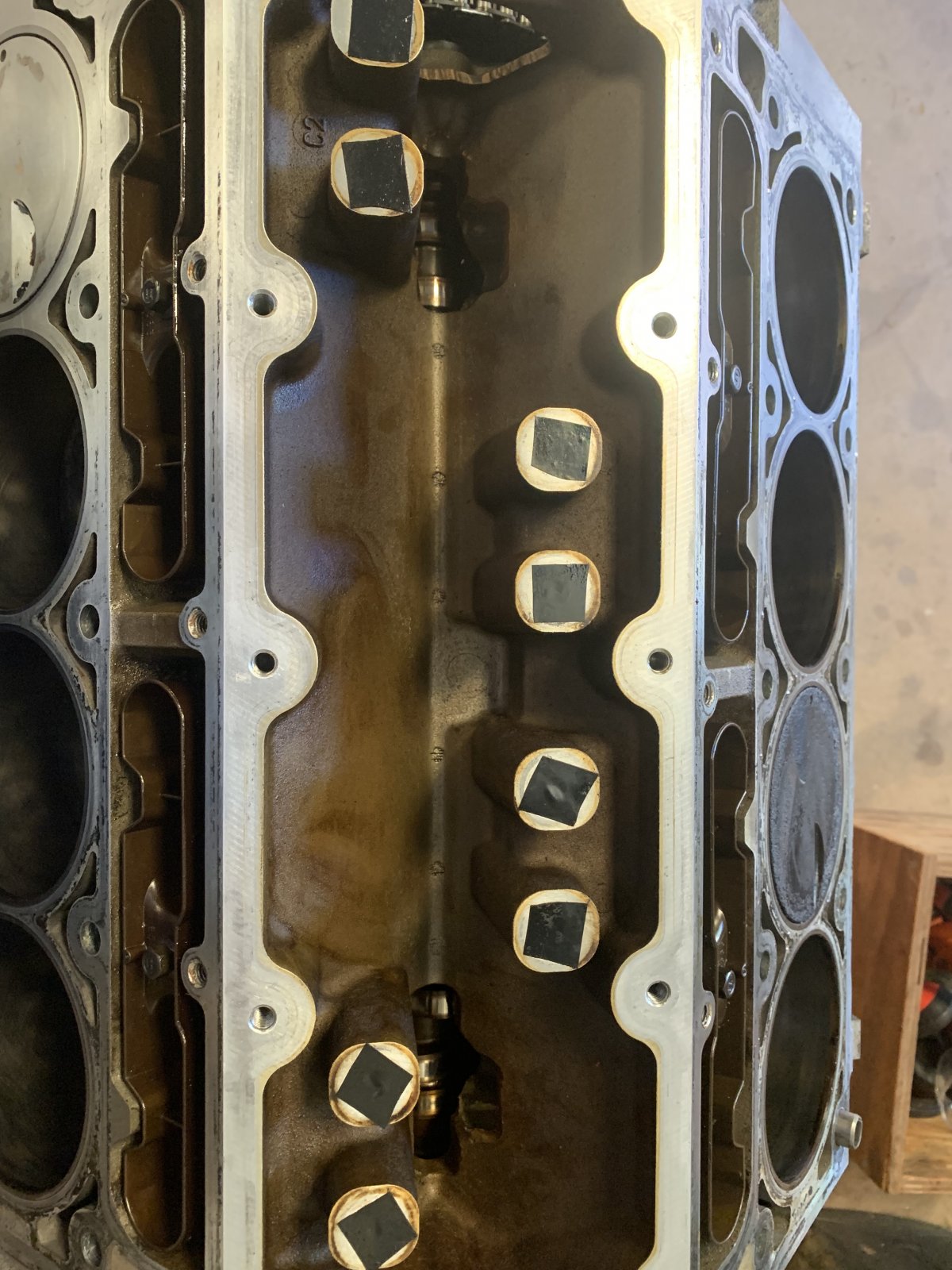

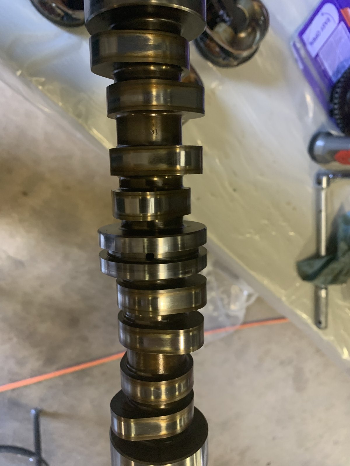

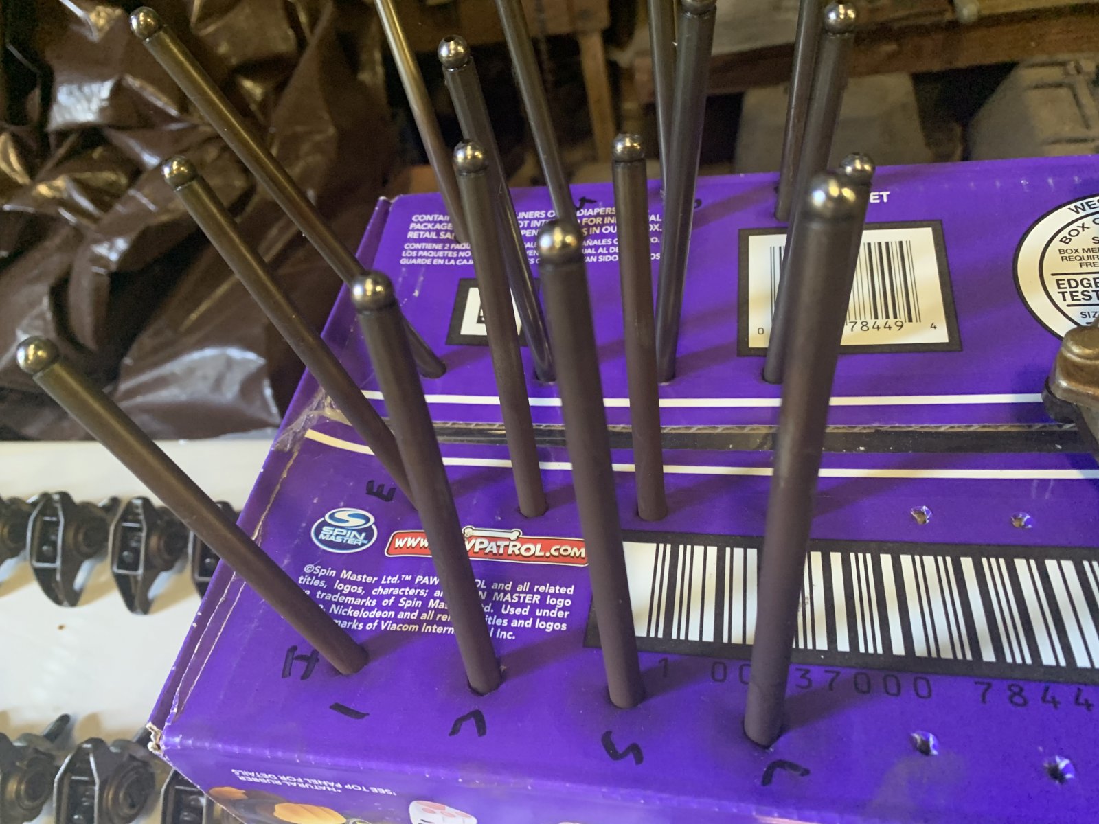

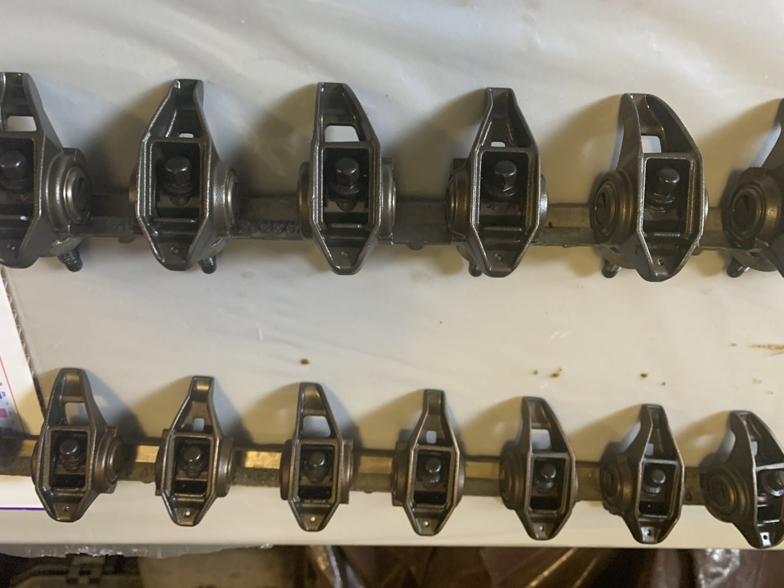

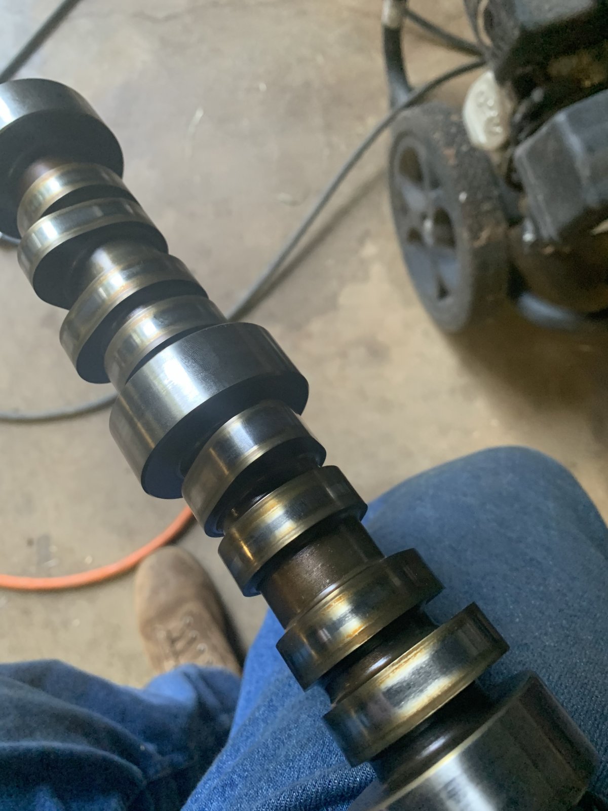

Camshaft looks ok far as I can tell. The lifters were beautiful but not attached to the trays very well. Matter of fact I had to pull all of them out with a magnet. Pushrods rockers look good

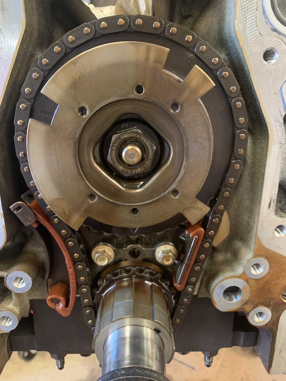

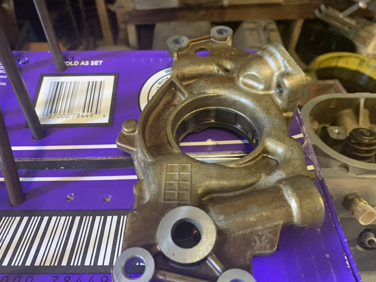

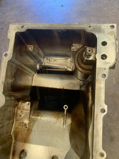

Oil pump looks like it’s newer than everything else. VVT phaser looks good, very minimal wear on tentione. This is what the pan and valley looked like. Almost too clean huh?

Bearings look typical. They look pretty similar to my 06 LQ4 with around 265k. I replaced the cam bearings with Durabond CH-25, new main/rod bearings, cylinders dingle berry ball hone, new piston rings, and I "sent it." Kept the original oil pump because it was pristine. Truck runs good.

What do you think about the non sensibility paint marks on the rods?? How many miles on your truck since you did it?
The numbers are definitely not factory, I don't think(?) Edit: looks like the rods are factory with the little "dimple", but they were just numbered by someone for reassembly?

The cylinder walls are kinda hard to tell on the photos, maybe try some close-ups of the actual wall. Do the vertical scoring get caught on your fingernail when you drag it across? Same for piston skirts. That first one does look pretty rough on the photo.

That is a real head scratcher. Are you thinking maybe someone just did the rods and mains, and new oil pump?
But that oil pan gasket speaks volumes, covered in RTV. That leads me to ponder a shade tree mechanic trying to address low oil pressure and swapped out the oil pump..... Didn't want to spend the $45 on an oil pan gasket. But that doesn't makes sense with the cleanliness inside the block. (Unless they were using Valvoline restore and protect for 10,000 miles perhaps?) The camshaft looking good with bad cam bearings is not unusual. I've removed a lot of AFM camshafts and they've all looked pretty good, except for one that had a lifter issue and chewed a lobe.

Bingo. Possibly the lifters cuz they look great too. And something let go in the lower half of this engine or it got ran low on oil. Crank seem like a polish will suffice but I havn't broke the mains loose yet. What is crazy is the way those rods are marked makes absolutly no sense. How are you going to have 5 rods marked 1 or 2 with a single 3 and the number 8 cylinder marked with a 4? I'll post my theory on what happened after I get it all apart.
Yes you catch a nail on the scoring on #1 piston and one other. The cylinders themselves are definately not the worst ine ever seen all have visible cross hatching but #1 is the worst. Don't think they need to be bored.

A light hone will probably be all it needs in the cylinders.
Any plus or minus signs on the connecting rods? I'm just picturing one of the high volume rebuilders, with a big box of good connecting rods.... Writing down some reference to the weight. Like how much each rod needed added or subtracted from it. Difficult to say.
Quite possible it was a short block and they did not prime the oil pump?

As far as the rods go, there are 3 of them that appear newer/cleaner than the others.
