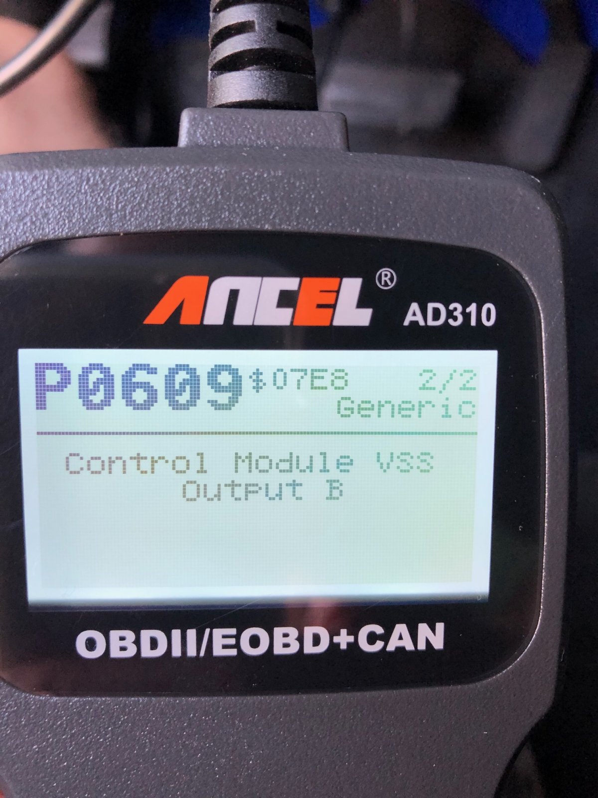

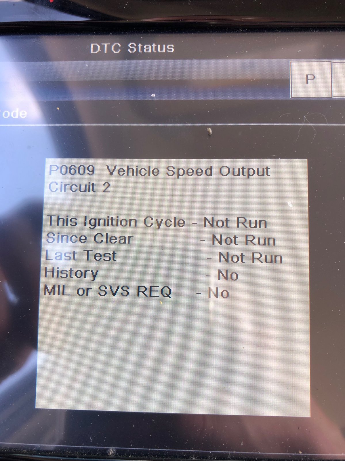

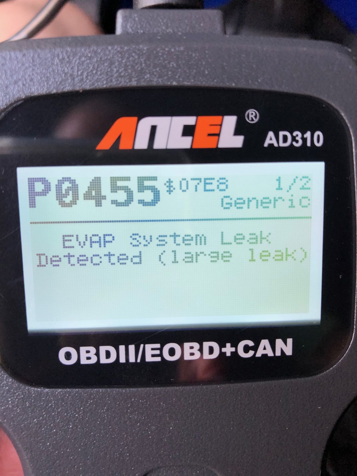

Im still getting the PO609 and sometimes the PO455.
PO609 is VSS vehicle speed sensor
PO 455 is a Large EVAP leak. I have a smoke machine coming soon..
The PO609 still baffles my little brain.

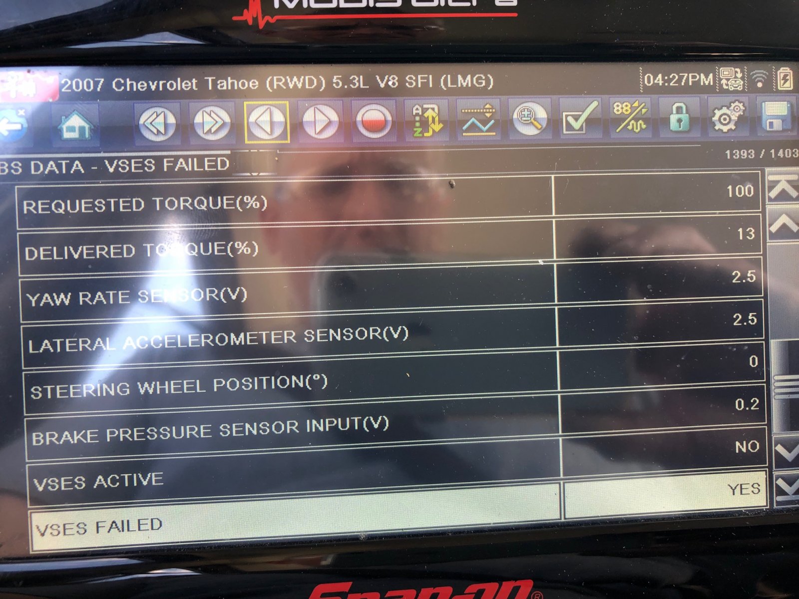

Today 5-31-2019 I removed each wheel speed sensor and cleaned off any metal shavings.
Also removed the speed sensor at the tail of the transmission and checked the pigtail on the plug.
Also followed the rear speeds sensor wires to the top of the transmission.
Used a snap - on scanner and watched each wheel speed sensors and they all show the mph as did the vehicle speedometer.
I guess I will start throwing parts at it. Starting with the two speed sensors in the transmission.
Does anyone have any tips.
I cannot find anything on the PO609
This is a 2007 Tahoe 2wd 5.3 flex fuel.
Has the superchips active fuel management deactivated.
The Snap-On scanner showed VSES Active - No
and VSES Failed - Yes
