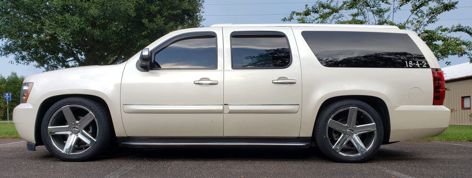

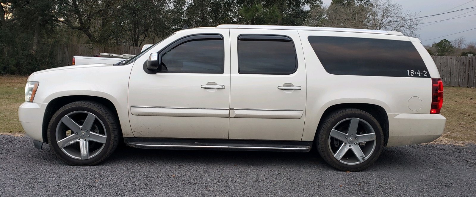

I don't have 24s only 22s but here is my Burb...
First pic is 4/6 drop...
This is it after I raised it back up 2" all the way around so 2/4 drop....

They both look sweet why did you raise it back up?
kbuskill
Mar 11, 2017
5,821
9,832
NE. FL.
Thanks!
It was time for tires and I wanted to try out a set of 70,000 mile rated Michelins. Unfortunately Michelin doesn't make a 285/40/22 which is the size I was running without any issues.
The only two sizes I had to choose from was a 295/40 for $470 each or a 305/40 for $232 each.
Naturally I chose the 305 and it just rubbed too much.
I had been tinkering with the idea of try out the TBSS air bags in the rear in place of springs but you can only run a 3"-4" drop while maintaining a decent ride quality so I decided to try them out.
I have them hooked up to my factory Auto leveling compressor and they work and ride great with the Rancho 9 way adjustable struts and shocks I have all the way around.
I preferred the look of the 4/6 drop and it rode good but I couldn't deal with the rubbing and scrubbing from the wider tires.
