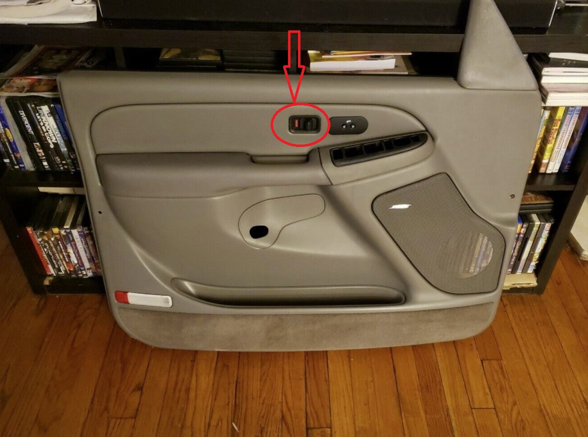

The vehicle thinks you are inside it, Simply get a piece of stiff coat hanger wire and gently pry the driver side door at the top open just enough to slide the wire down and press unlock on the door armrest. I think a good thief could do this in less than 30 seconds!
