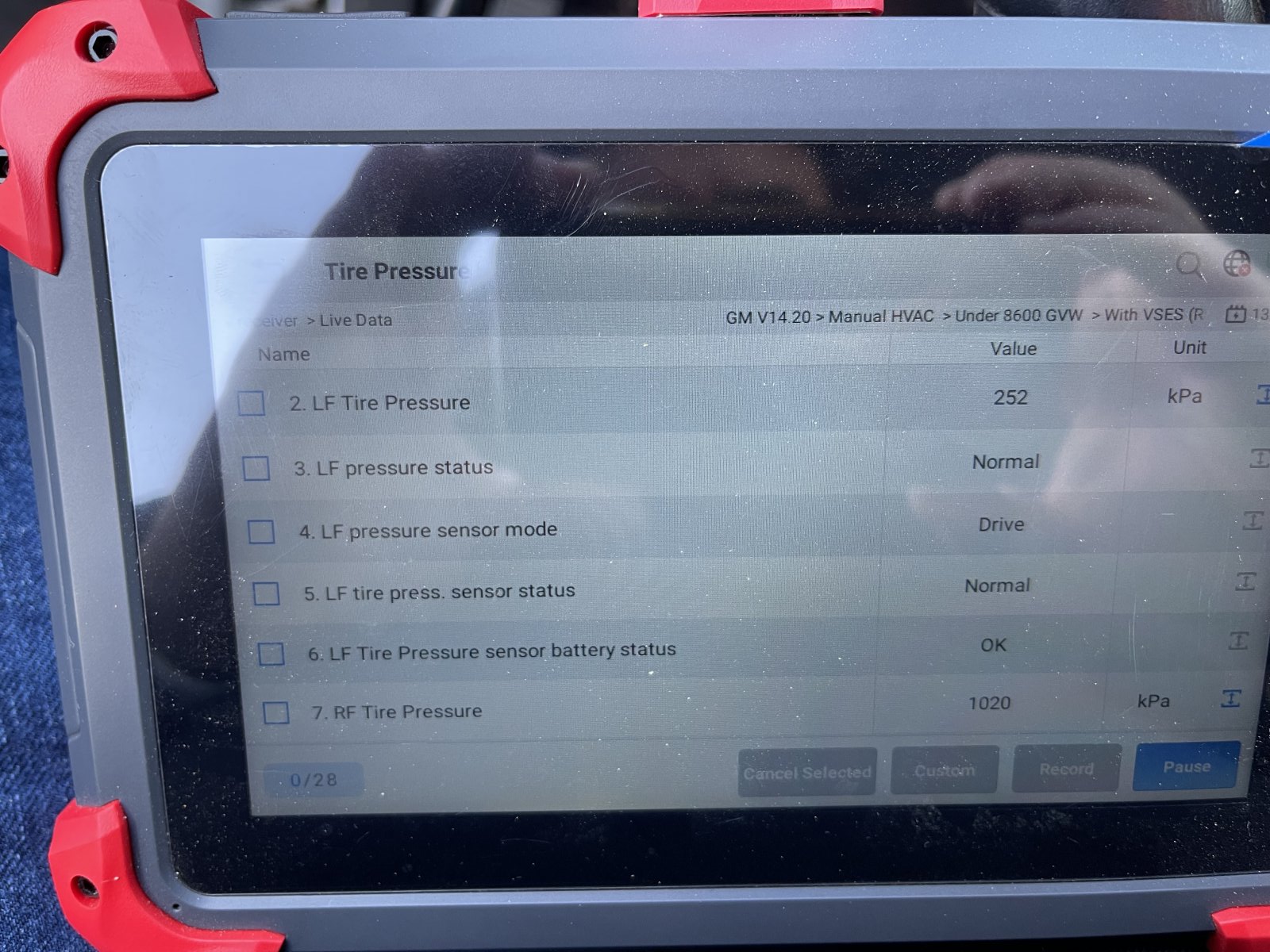

So I scanned it and only had the service tire light in the dtc for all four . I remember the tool at work showed the tire pressure and battery life but the scanner was showing one tire at like triple the psi and I checked them with a gauge before relearn and after so I think that one may be the problem. It was also showing the LF not learned even tho I have done it a bunch . The one that was showing way more pressure was the right front but In not sure which one that is since the wheels got swapped and sensors won’t relearn so gonna deflate them one at a time to find it and go from there. The remote relearn I still don’t know what’s going on with that I cleared it and reprogrammed it but it still says that . I will keep you guys posted. See if I mess with it tomorrow or maybe the weekend

so after messing with it this weekend, i think for the relearn tire position and remote key I'm not sure if that's just something that is on the D.I.C. with key on engine off all the time, because once running its not there , any who i can not figure this out i reset the tpms with a scan tool hoping that would fix it and drove around the wholeweekend and the light stayed off but once i get on the free way for about 10 mins it will come back on. sensors all tested good. im going to try to re write the sensors today and see what that does other then that im not sure. would suck to buy 4 more and still have this happen. do the ppv tahoes have this feature shut off in the bcm or something? to where it wont stay off? hope eveyone had a good weekend. i did for the most part.

i will have to show a video of what i mean. looks like i had two sensors that were just intermittent. used my scan tool at work and yeah they would jump all over the place and be fine for like 5 min then just start reading wrong. so i replaced them yesterday and today i will set the tire pressures and see if that worked. im pretty sure it was just the sensors because now its at least letting me know what tire to check instead of just saying service tire monitoring system. cross your fingers guys. once this is done then the suspension is next,then the carpet and dash.

ok guys i feel super stupid because just like the bcm crap i over think and get lazy instead of doing the digging and being patient i post on here lol. so it was just the two sensors, I'm glad. i recorded a showing on the scanner what the sensors were doing. napa didn't want to refund me . it was the relearn on the dic that was throwing me off. i will post a video later showing what i mean . so yeah its fixed i am glad . i do appreciate all the help though, it does get the gears turning to put me on the right path. that being said i order the front struts and leveling kit for the front and i am going to do some shopping around for the rear springs and shocks today . next weekend i will be riding high lol (hopefully)
