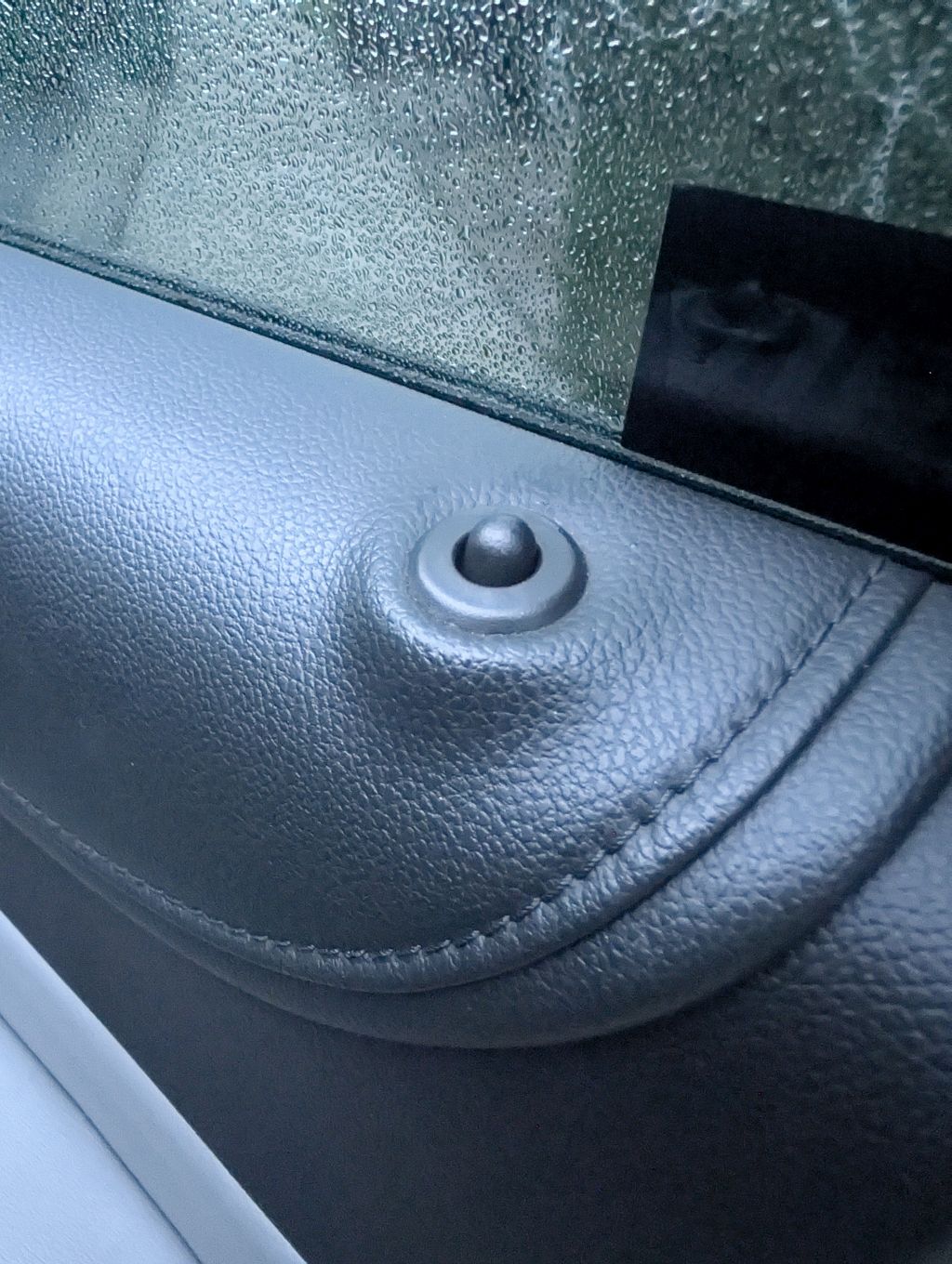

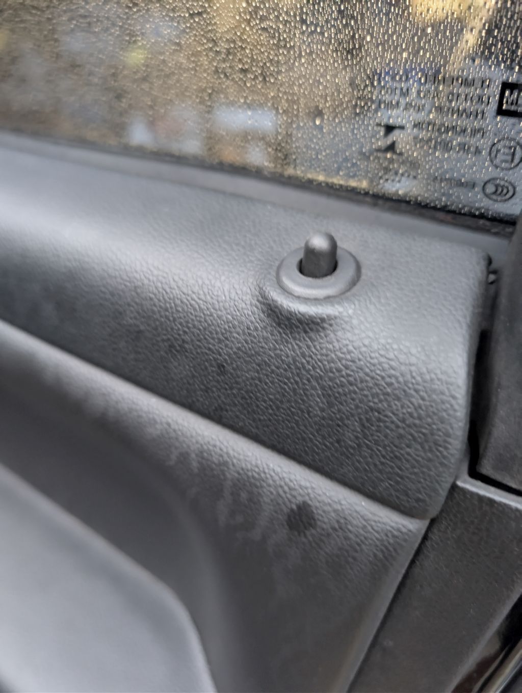

on the wifes 16 it is pretty short, hard to lift up if it all, on my 18 silverado it has enough sticking up to pull it
GMCChevy
Oct 13, 2024
427
457
View attachment 470860View attachment 470861
I think mine are sunk more then that.
You can probably unscrew them a bit to raise them and still be on the rod enough to not pull right off. Or replace them with longer ones if someone is so worried.
