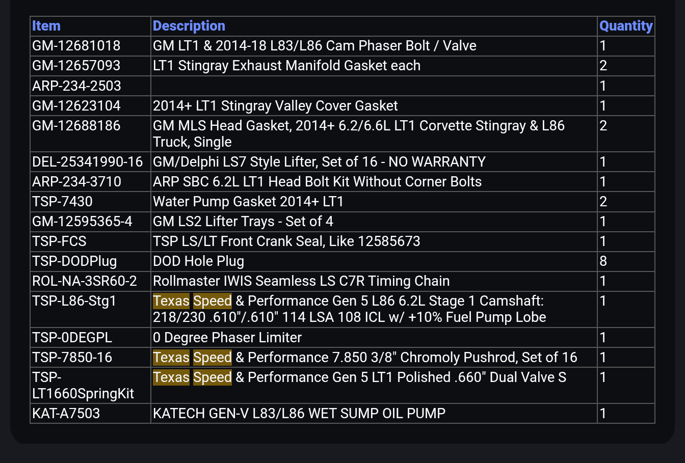

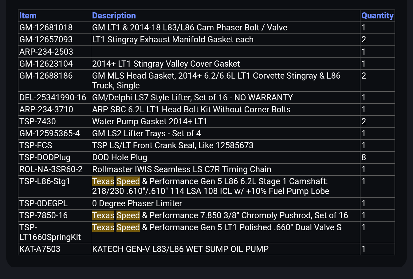

2017 Yukon Denali, 6.2L. So I had a collapsed lifter, which bent a pushrod. I went with a Texas speed replacement set. I tore everything down, there was no scarring or damage to anything that I could see when doing so, just the bent rod.
Anyway, everything was torn down to the block. Lifters replaced, new cam, new oil pump to be safe (parts list attached). There was no visible metal but I wanted to be sure. I also had it tuned because of the DOD delete, etc.
