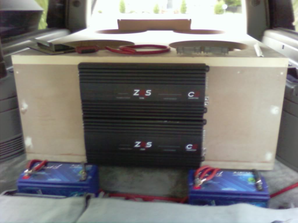

As for where you can put one....thats completely up to you and the space you want to dedicate to a battery. In my suburban I put two all the way in the back where my stock sub was.
I also have two in the foot well of the third row seat. Box was unfinished BTW.
And i have one up front. So thats just some ideas.
