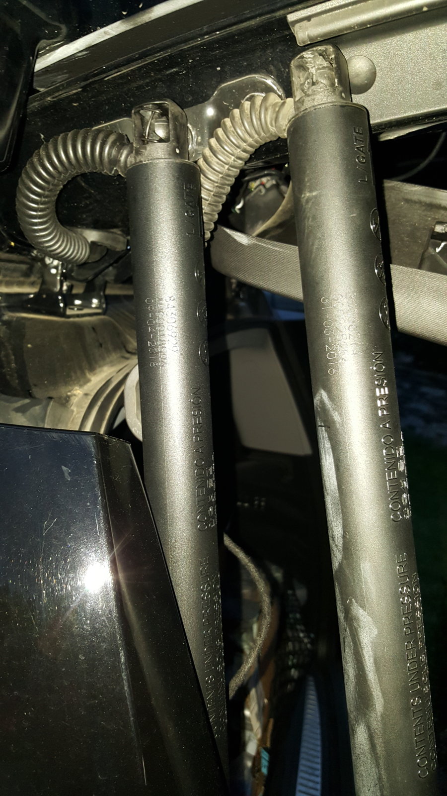

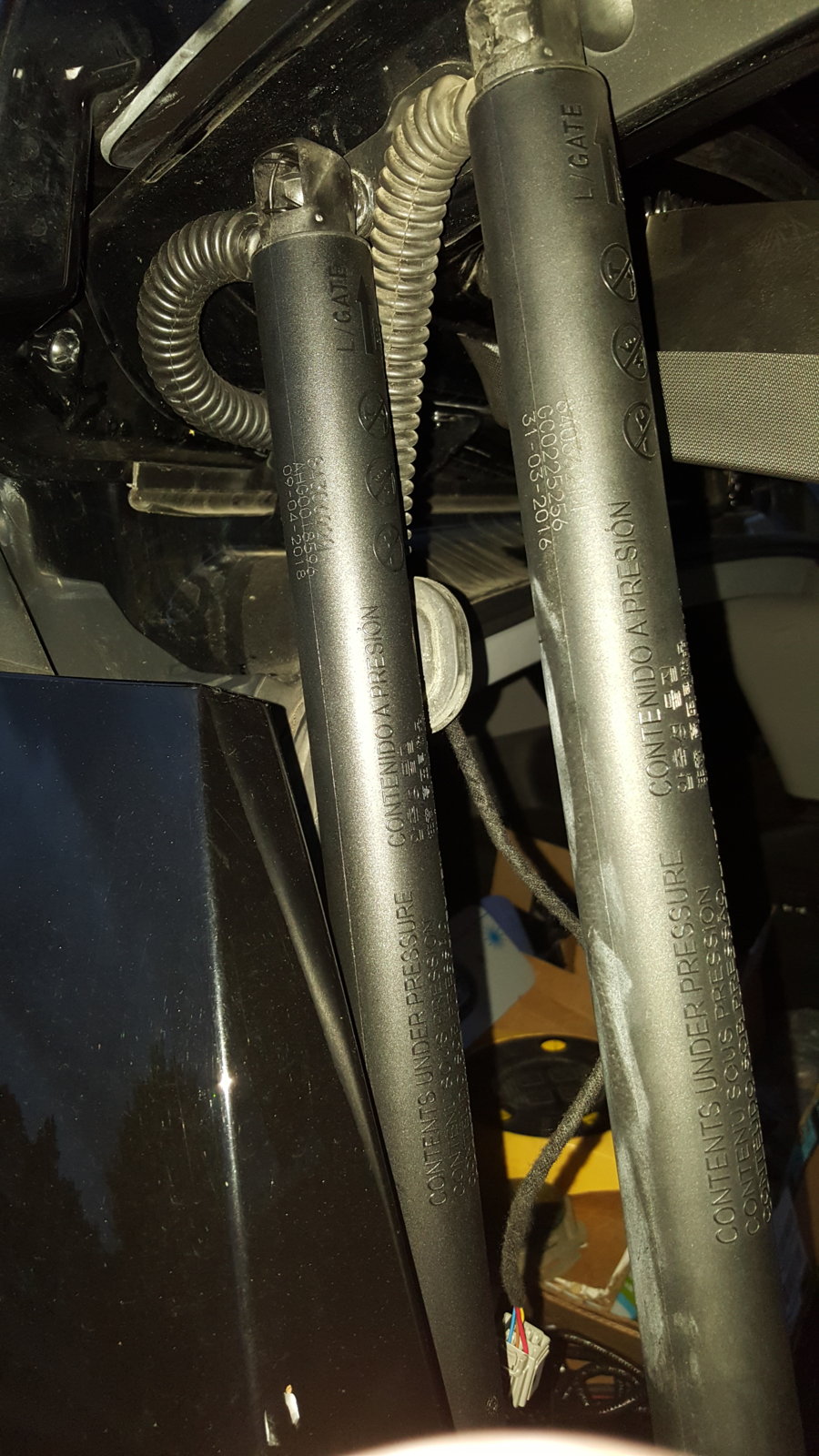

On my 16 Denaly i had some problems with liftgate this pass winter. When cold after pressing any of 3 buttons or using feet yo open it it will just unlock and start raising a few inches than stop. Than a few dayo ago it started doing same thing but on wark weather. I never had problems liftgate opening and closing by it self because spoildr was hitting roof
Looks like GM update part # 84036214 Lift Cylinder to new part # 84306929. I didnt had time to mess with dealer and use warranty so i bought new one off ebay $120 shipped and install it my self. There is 7 small red retainers part # 11547026 if you broke them. You can get 10 of them on ebay for $12. Also if you mess up upper trim part # for black one is 84299959, they go by color. Around $50
Old one was opening and closing faster but it did slammer right before fully closed. New one is little bit slower but its quiter
Here is pics of new one installed on left and old one on right
