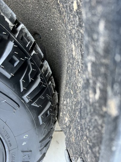

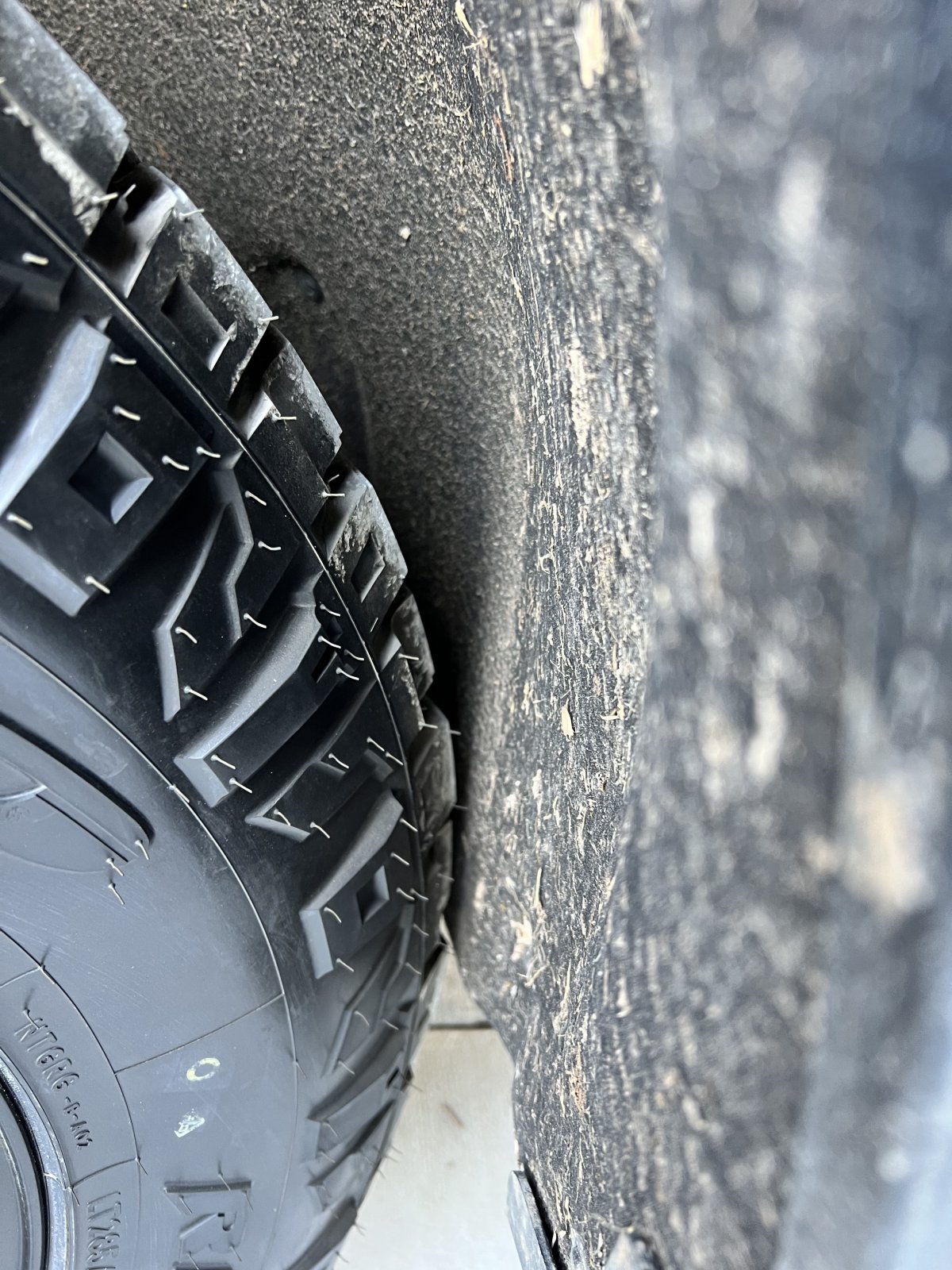

Thanks man, my wife and I are really happy with it. I agree that the 70’s give it just enough of a meaty look to the tire. Any smaller wouldn’t look right to me. I’ll post a pic of where it’s really really close to rubbing. I can’t even get a finger in there but I drove it around all day yesterday, making u turns, little off-road, etc and zero rubbing. I’d say it’s a width thing. These are 11.5 width tires, not sure how people do 12.5 wide unless the offset of the wheel is popping out of the truck a bunch or spacers. I’m really happy with the balance of practicality and still look of this setup.

That’s the very bottom too….would be very easy to trim.
Yeah, they say you can trim and even pull that back and pin it back better. I drove it all over the past couple days and zero rubbing. I think this is absolute max tires size to have to do nothing…but could go a tiny bit more and trim. I’m real happy with the general look and not too heavy of a tire either. The next size up is 10 lbs more per tire…exact same brand and tire. So that made me feel more sure to just stick with this. Doesn’t bog down the power much if at all and give a great meaty look. I’m happy
