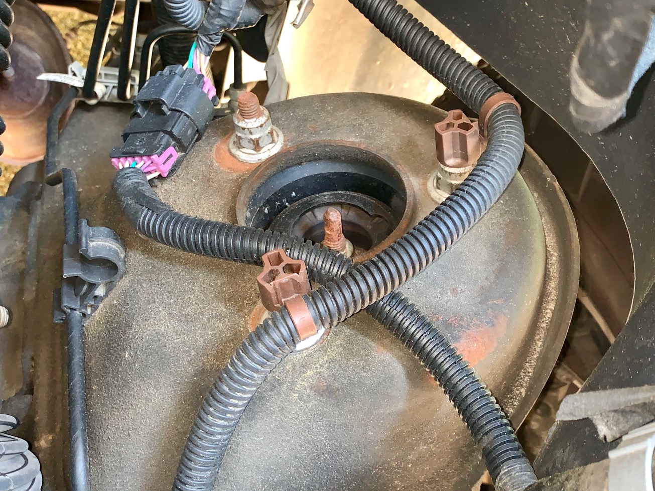

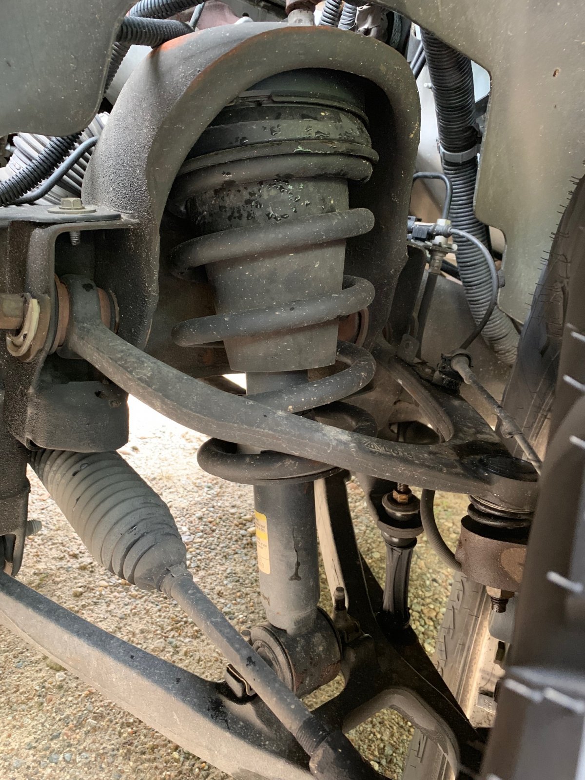

Bought this 2014 2wd Tahoe LT few weeks back and want to replace wheels and tires and drop slightly. The issue I have is with the leveled look. I cant for the life of me find a leveling kit. Afraid if I drop 2/3 the rear will sit lower than the front. It almost looks that way from time to time already lol. Here are some pics for you eagle eyes. Thoughts?

I'd have to look at a known stock one to know for sure, but is the top of the strut not all the way up in the frame cup as if there's a spacer up there? If so, then removing this will drop the front about twice what the thickness of the spacer is. I don't see one of these rigs sitting that level/high in the front with no modifications.

Same here. Either there’s a spacer up front or the rear has shorter coils. If you get it back to oe the 2/3 drop makes the rear look slightly taller this isn’t a great picture but it has 2/3

It sure looks like that truck has been leveled to me. I'm betting with @iamdub here. There's a spacer on the front struts somewhere. Looks to be at the top.

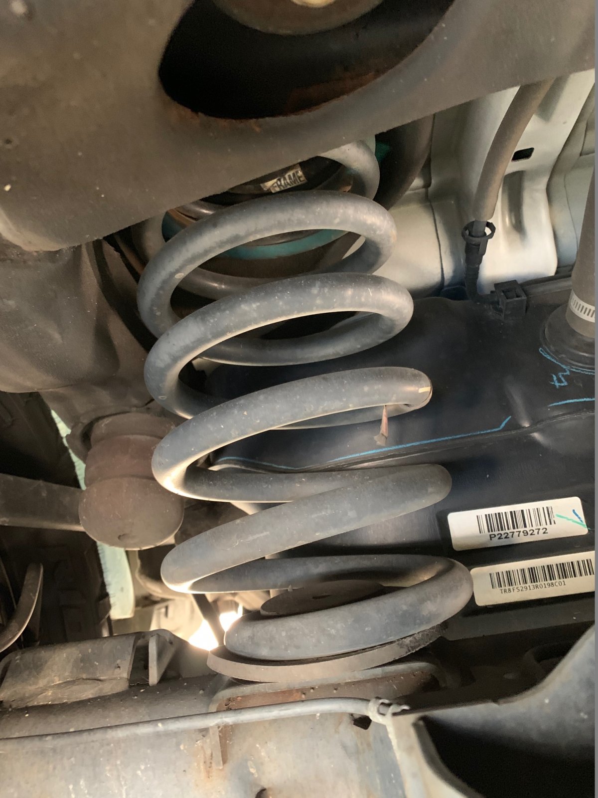

Nothing in the rear for sure...
Can't make out anything on the top of the strut. I will have to drop it and see..
45,012
You're looking right at your lift spacer. In the pic, from bottom going up, you have the spring coil, the lip of the rubber isolator bushing (with the tiny cracks in it), the sloped piece with the triangular notch in it towards the right of the pic, the top plate of the strut with the notch in it towards the left of the pic, then the lift spacer on top of that. The top plate would normally be all the way up inside that cup and bolted. That spacer looks to be about 1" thick, meaning it's a 2" lift spacer.
This is what the top plate of the strut looks like. Also, the center stud of the strut would be sticking up through that hole in the frame. You can see the lift spacer in your pic of the top of the frame with the three studs and nuts that have obviously been wrenched on at some point, such as during the installation of that spacer.

yup lift spacer in front. take spacer out and will be good to go to lower. I also offer the lowering kits
Wow. That part looked completely stock to me. I was looking for a piece of billet aluminum or similar. Thanks so much!

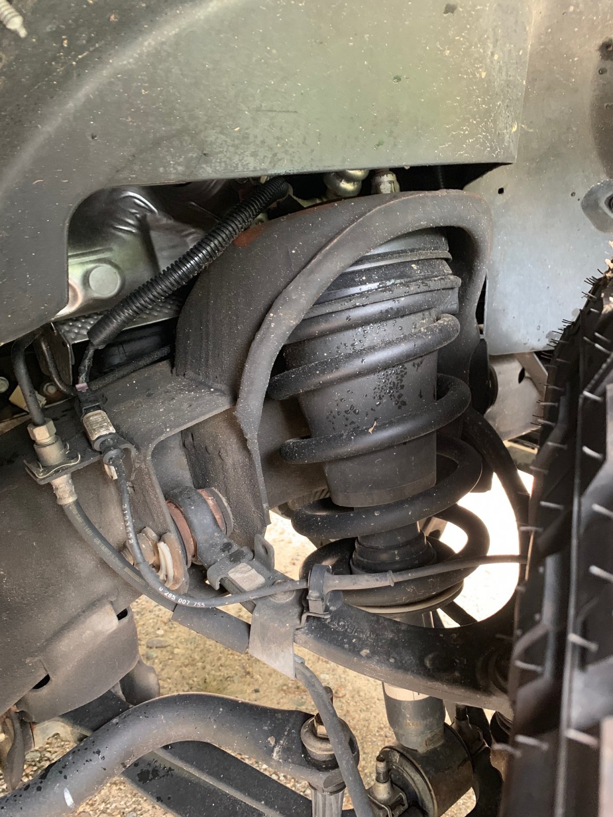

Also @esoteric_ast you may want to remove your front caliper/calipers and flip them around to get the twist/kink out of your brake line.
Its probably not a big deal when the wheels are straight but when turning it will restrict fluid to the caliper... again probably not a huge deal but it is ******* the rubber brake line and could cause premature failure.

Nailed it Chris nice job. Al, if you’re going to have the drop kit installed have everything done at once including removing the spacer or you may need 2 alignments. Tony can get you everything
