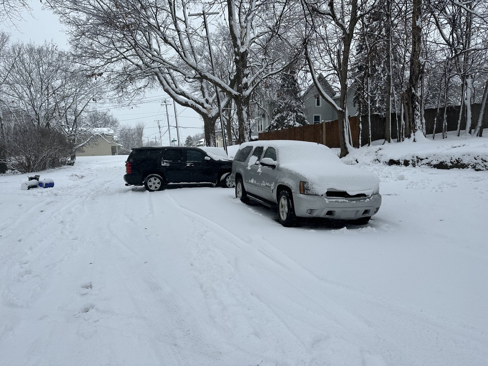

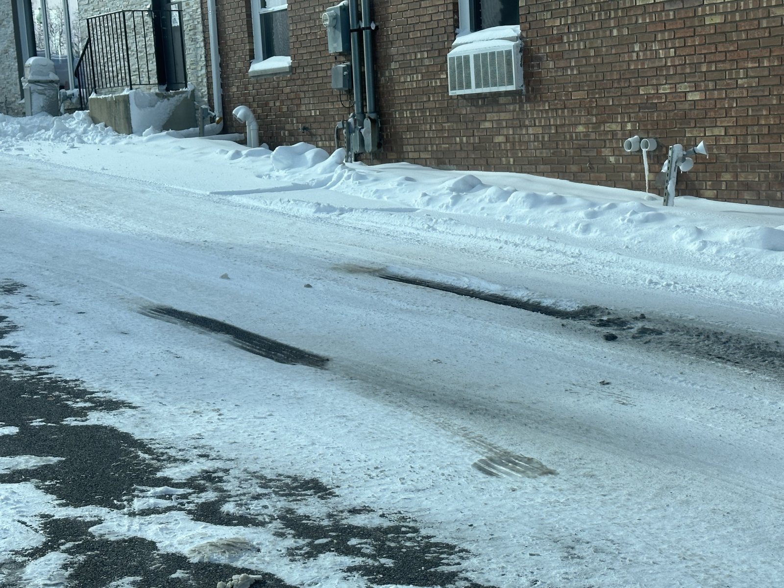

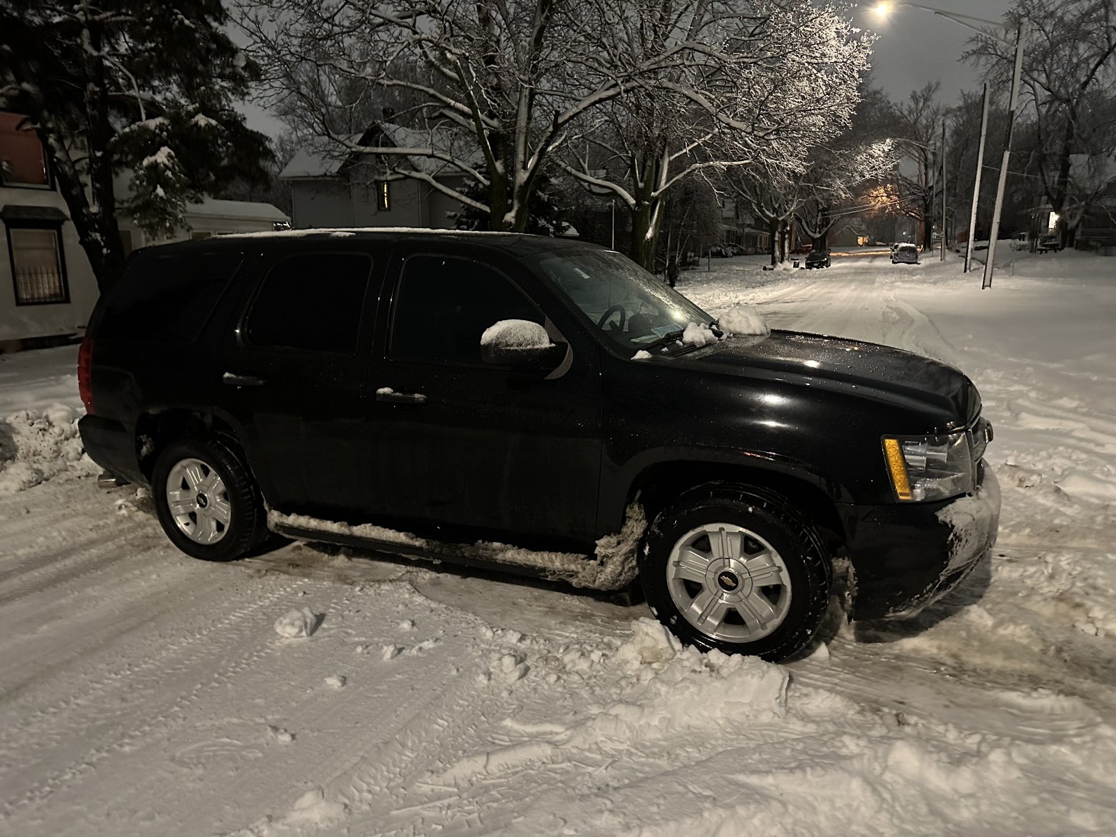

Guys… I have never been more upset with a vehicle than I am right now.
Today… On two different occasions, my Tahoe got stuck in the middle of the road in a residential neighborhood.
This is a full-size truck with a posi and brand new all-season tires. YOU HAVE GOT TO BE KIDDING ME.
Look at these pictures! ‍♂️
That’s one picture of each incident. Can you even believe that the vehicle in those pictures is stuck at all?

I've never driven in anything like that so I can't comment. But, yeah, both pics don't look "stuck" to me. What tires?
Continental all-season, basically new.
The only point on that topic would be that they are wide, which supposedly is a bad thing on snow and ice. Ideal snow tires are tall and skinny, I guess.
But, still, ridiculous. It’s not like I’m doing something super demanding.
EDIT: I forgot to mention that at times it felt like the brakes were independently kicking on and off. That makes me think the stabilitrak is acting up.

I got stuck again this morning in a flat parking lot while other cars were driving right past me.
I eventually pulled the fuse and was still stuck for 5-10 more minutes until I was able to gradually inch my way out onto less slick pavement.
Maybe my rear IS blown? I hadn’t considered that until now. I was about to buy some Blizzaks or something but I really shouldn’t need them on flat ground like this.
