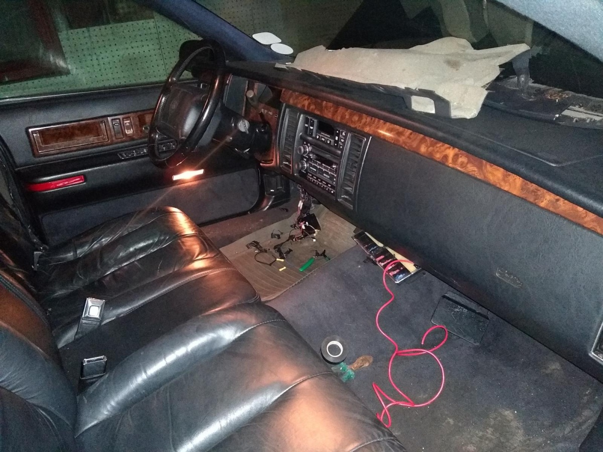

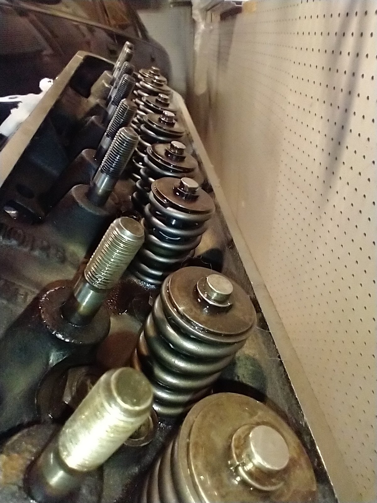

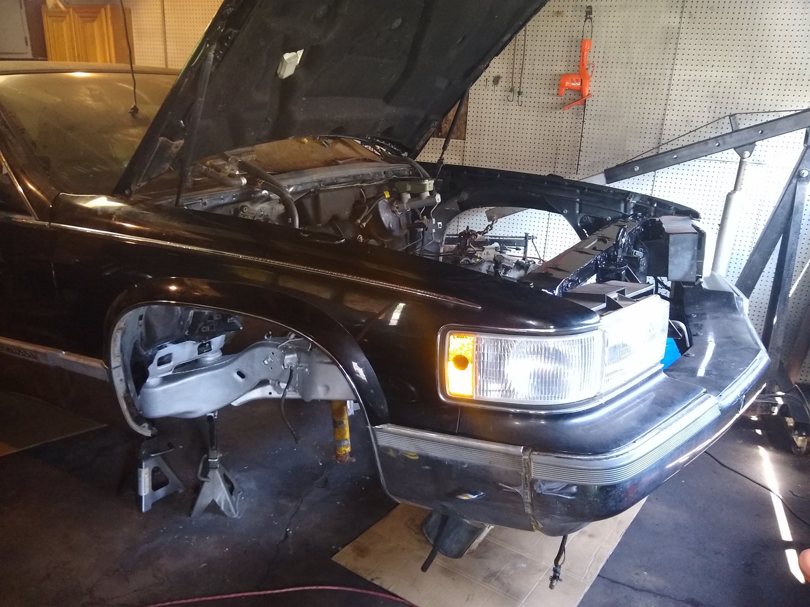

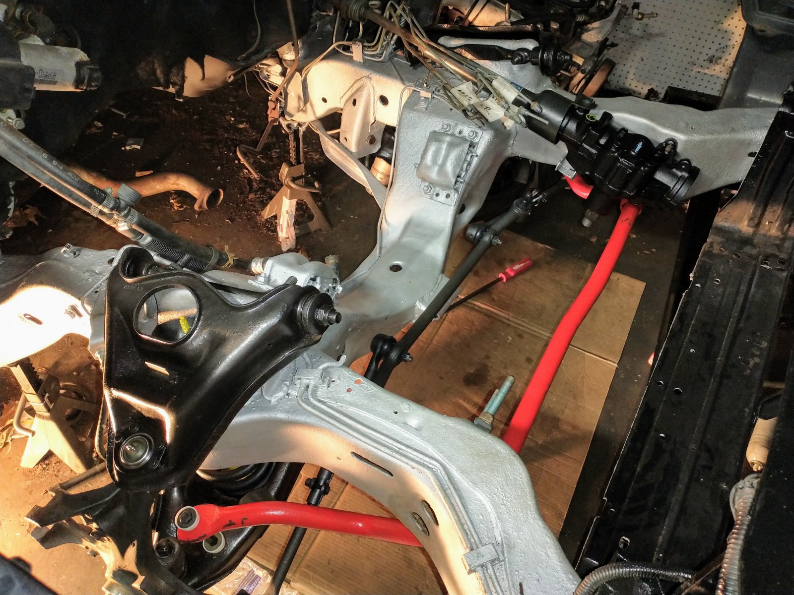

As requested, here are a few pics of my 95 Fleetwood Brougham project. This car is meant to be a tow rig and general comfy cruiser.
I pulled the original (strong) engine out and freshened it up a bit. I added the LT4 "hot cam" along with 1.6 rockers and Edelbrock valve springs.
The trans is a built 4L60E that was originally purchased for my Roadmaster wagon. The converter is a stock diameter 2600 from Edge.
This is an old pic from when I was mocking stuff up:
More mocking/bullying:
In the 1990s, this was the tippy-top shelf American car. Notice the flip-down mirrors in the rear. There is also rear HVAC, and a pretty decent rear center console.
Suspension mods include upgraded sway bars, Monroe police shocks all around, OEM police coils in the rear, and OEM SS coils in the front.

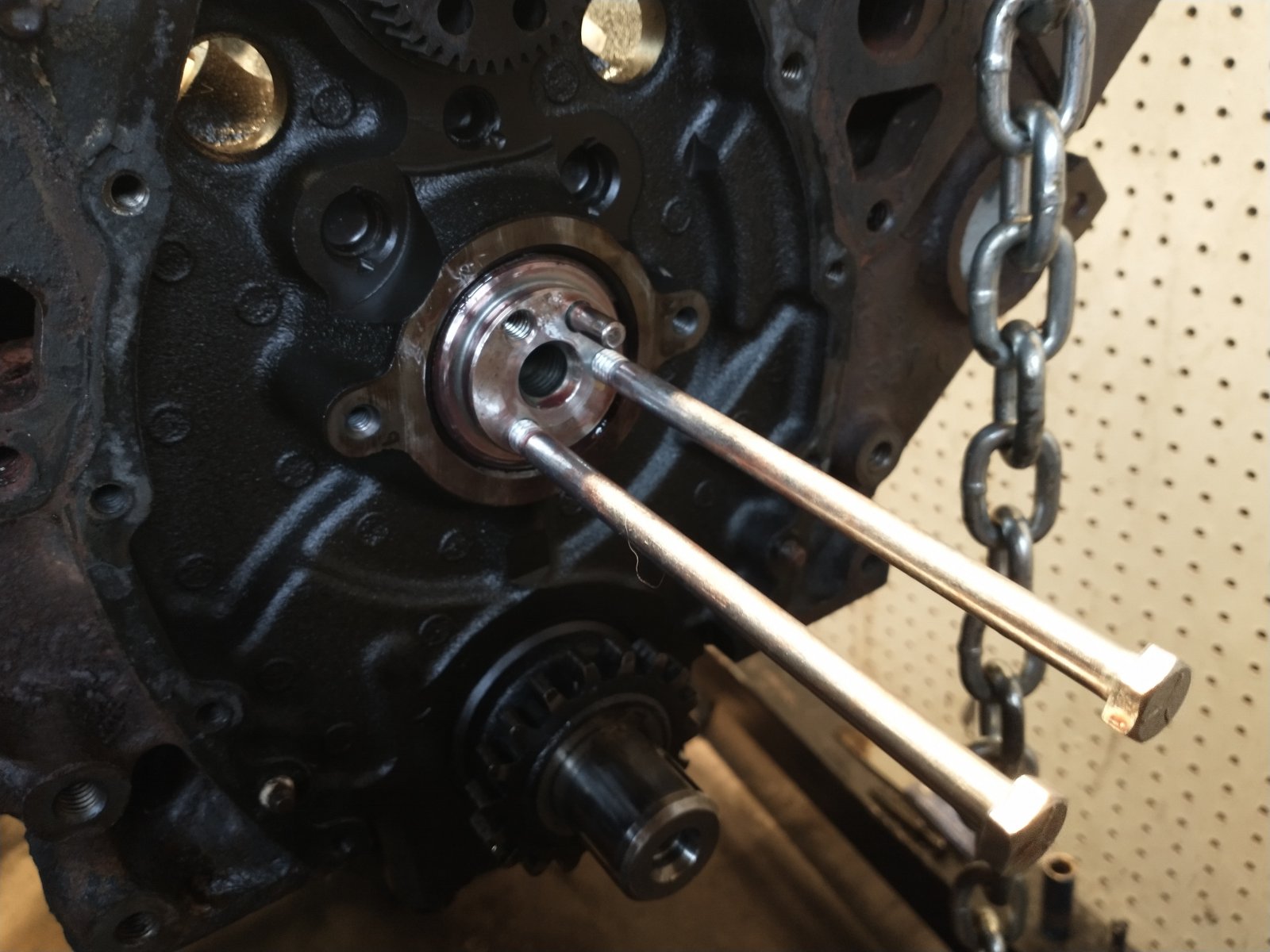

From 1991-1996, GM produced their last body-on-frame cars. This group of vehicles, built on the B platform, was ultimately a farewell to classic muscle cars. Under the hood starting in 1994 was the second-generation SBC, the 5.7L LT1. Factory specs were 260 horses and 330 torque. This engine was shared exclusively with the Corvette, Camaro, and Firebird of that era. The 2nd gen lasted from 1992 until the C5 Corvette debuted with the LS1 under the hood in 1998.
Included in this group: Chevy Caprice, Chevy Impala SS, Buick Roadmaster, Cadillac Fleetwood, and several station wagon variations.
Pictured is my black 95 Brougham that I recently "finished" rebuilding. I also have a red 94 that is going to be a full-blown race car with a bunch of wild aero mods and no interior.
This was my first cam install, which was a big milestone for me.

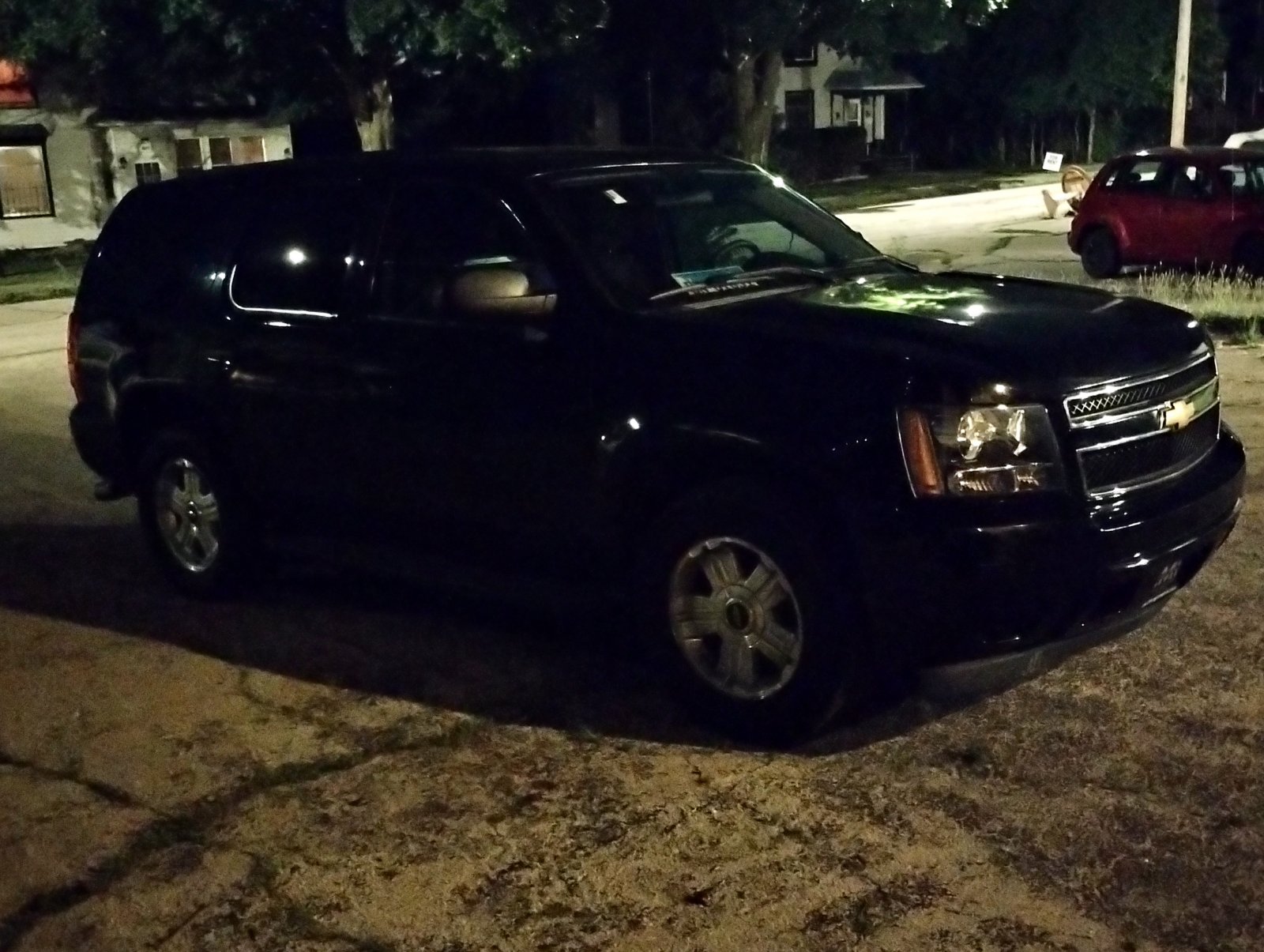

Well then.
We had an ice storm and a tree branch fell on the Tahoe. I got pretty lucky, the damage was minor.
There is a pretty nice ding in the driver side quarter panel right below the window. Then there's a long scrape that can only be seen from the right angle.
