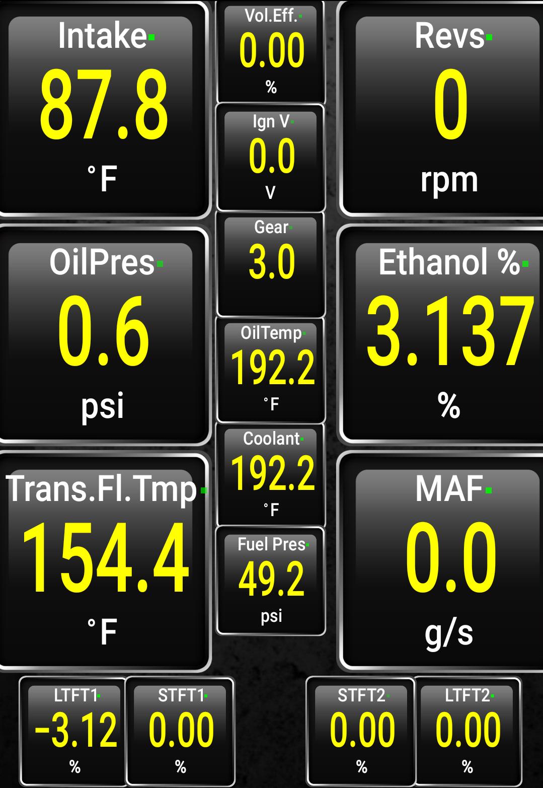

So here's the question...
Do you guys think that this means I have a problem with the drivers side O2 sensor???
When I turn off the truck with the OBD2 scanner still connected and Torque Pro app still running the Long Term fuel trims for bank 1 don't drop to zero like the others do.
I'm really not certain what this means but I am thinking about changing the upstream O2 sensors on both sides just in case.
What do you guys think???

Well it's the LT trim that seems to be acting weird so live at idle doesn't really do much for LTFTs.
I meant the O2 in question. Pretty easy to spot whether it's lazy or not by viewing the graph at idle. It'll either be switching from close to 0 up to about 900 and back every second(ish) or it won't.
I haven't watched it on a graph but I have the STFTs and LTFTs for both sides on my screen as you can see from the pic and the STFTs seem to bounce around just fine.
