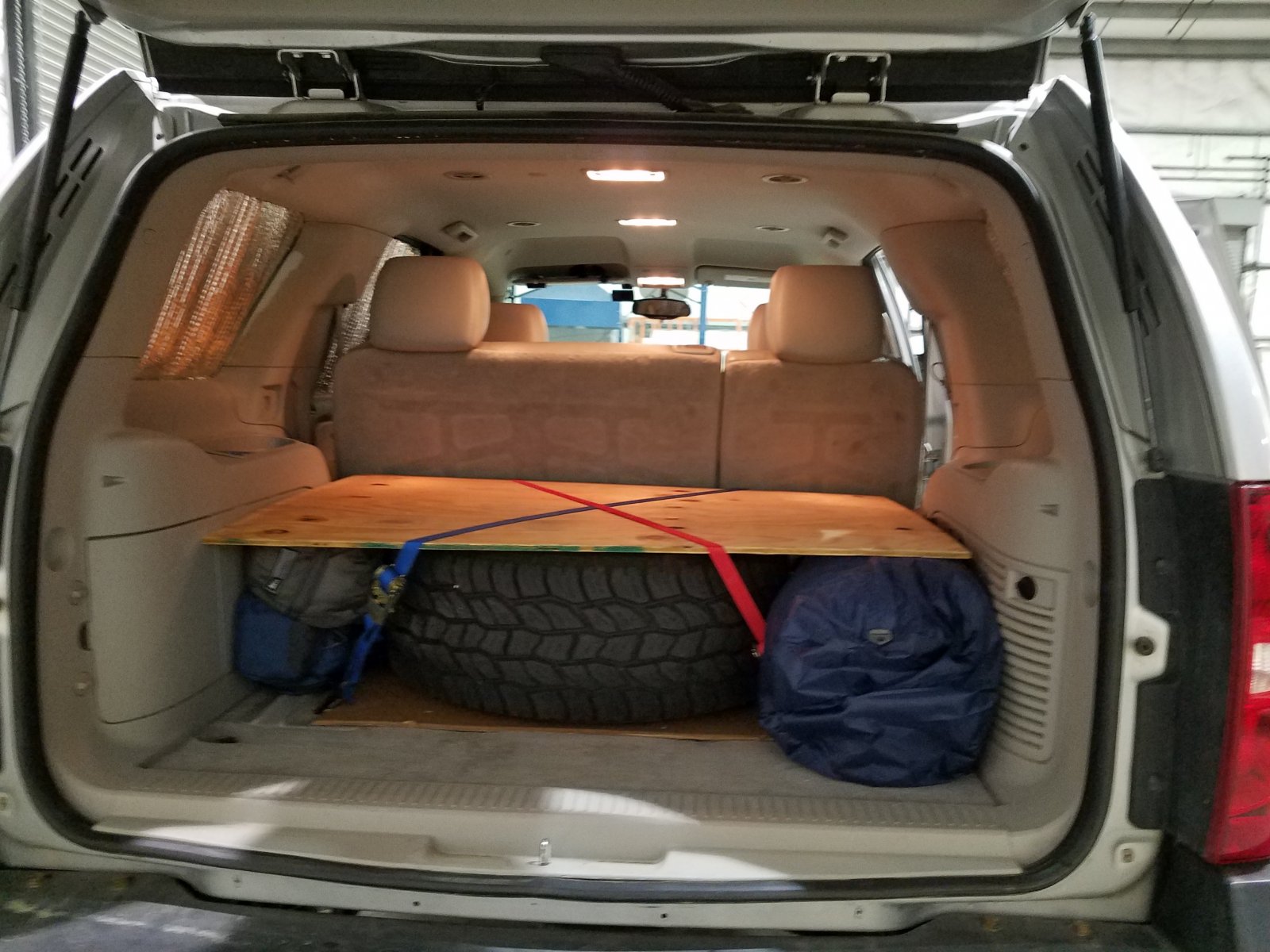

If you do not have the third row seats you can put the spare back there and put a piece of plywood over it so you can have a deck back there.. I did this for a little while until I got a swing out... You could do a fancier version of my platform back there and have storage space around it.

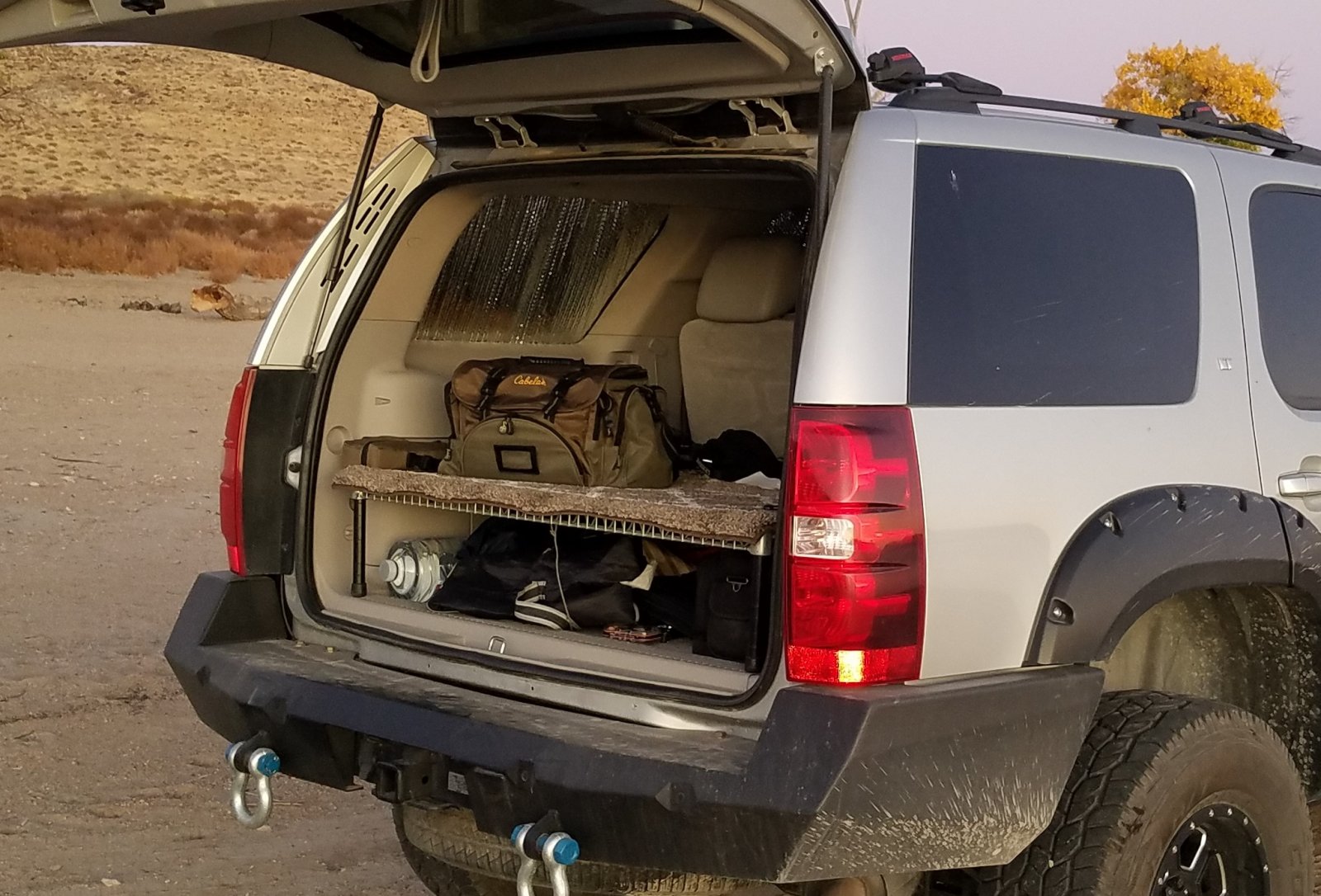

If I was determined to keep the spare inside I would consider using the steel shelving I have in mine and making it high enough so I could slide the spare under it and put the carpet on top so it would look nice and neat kind of like this only tall enough to fit the spare under it. I have two shelf panels with a hinge on mine so the rear section can lift up. Check out my build to see how this can be done if you have questions let me know.

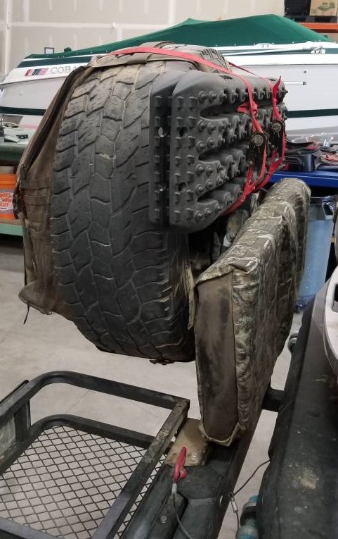

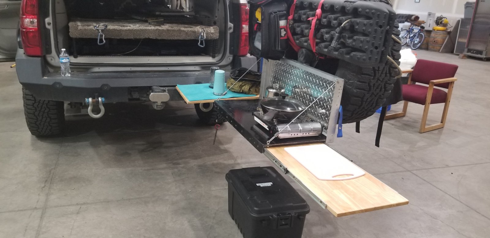

Just get one of these heavy duty Wilcos.
I built the cooking table for it and added them to the back of the swing out tire mount. When not in use the wooden table slides in then it all folds up. I also added the gas/water basket too.
