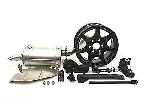

yeah.. I read that too somewhere. I do have a spring loaded flap in the exhaust between the muffler and the resonator. it is meant to make it even more quiet.
this is what the kit comes with. I think I'm just going to hit by now and see what it does haha.

So the spare tire add-on kit comes with exhaust modification parts.
I bet your exhaust is different than the previous years. That's probably why it says it doesn't fit your year.

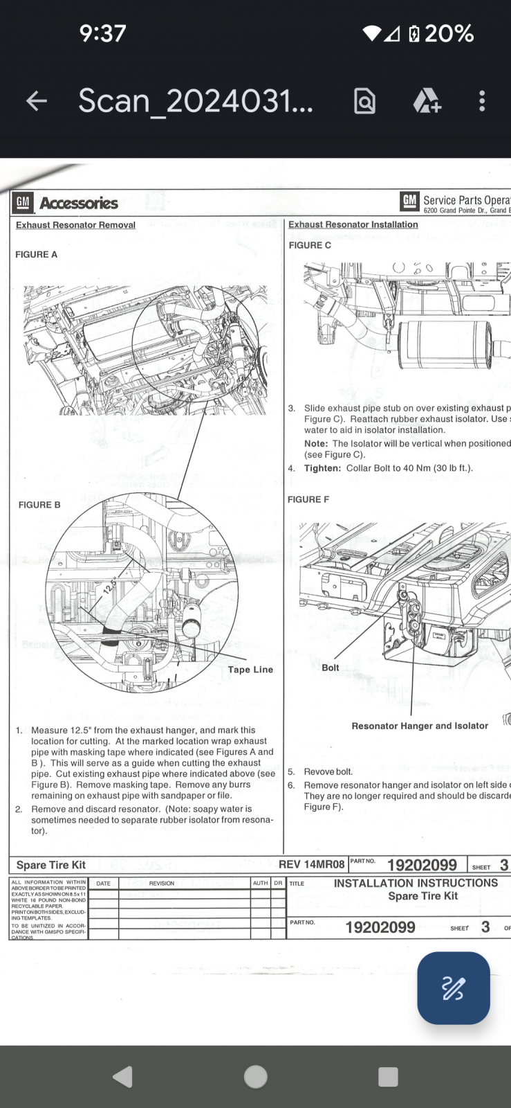

so just to follow up. I got the kit in, it was probably exhaust based fitment listing. from the instructions the early models came with a cross mounted muffler. so that makes sense why it needed the new resonator. mine doesn't have that and the res on mine looks smaller than what came in the kit. so I probably didn't even need it. but I'll find out during install.
I'll make an install thread in the hybrid forum, since it's probably very specific. but figured I'd follow up incase this comes up in a search for someone.

that was my fear. I found the part number for the kit and Googled it. found one on ebay. not sure if any are left. but worth a Google. kinda over priced so it took me a while to actually do it. but figured one time of a flat tire would make it worth it.
have a look under your truck and see what your exhaust routing looks like. if you have the cross flow muffler like in the instructions. you'll need to do the exhaust mods. I got lucky and mine have the normal truck exhaust. I'm guessing because its a 2011.
byond that, nothing special really. if you down load the instructions. the process is laid out pretty well. I would have to look but I think the individual part numbers are there if you can't fine a kit.
