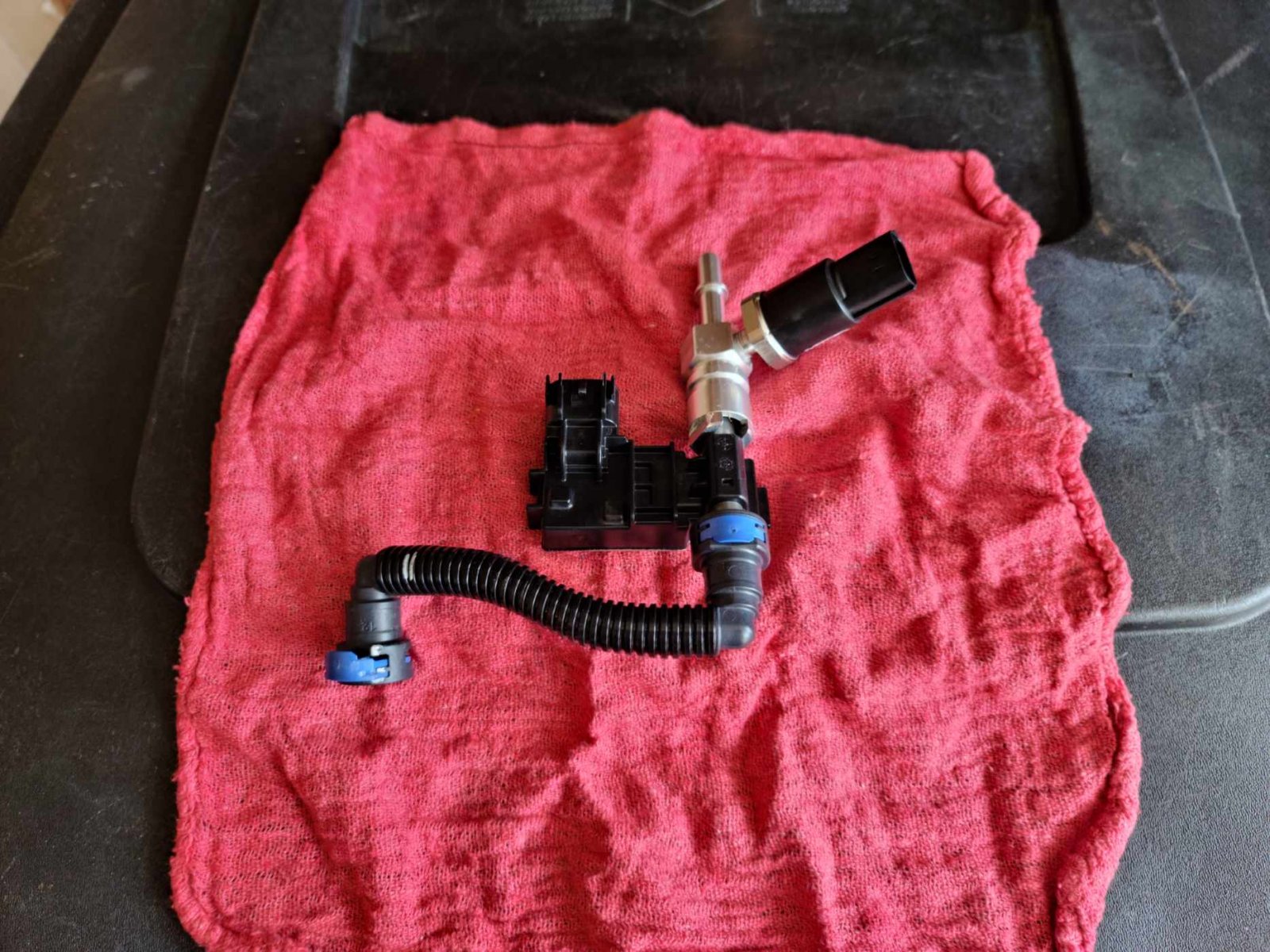

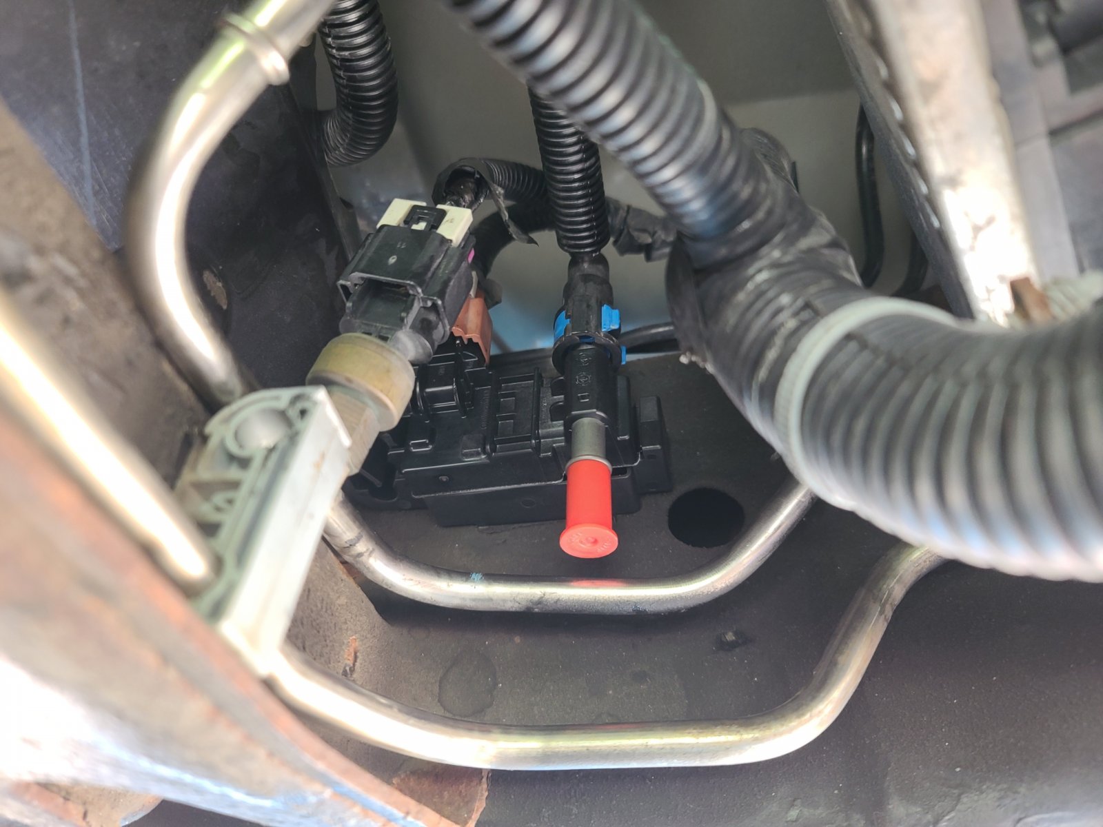

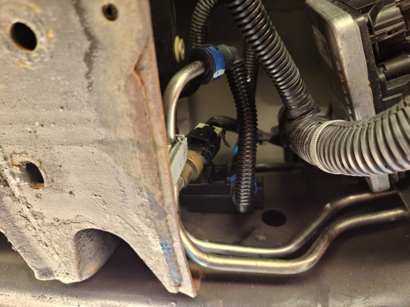

I have a Flexfuel conversion on my 2019 LT suburban, the sensor harness under the driver side passenger door jam where the pigtail is blind plugged right by the frame rail in front of the fuel tank. 1 GM sensor and some npt push fit connectors rated for fuel systems…. I haven’t sent the tuning out to blackbear performance yet to open the E85 tables. but I will once I get back home from the road. Everything fit like factory and it looks like it belonged there in the first place. I haven’t taken photos yet but I will in about two months when I’m home.

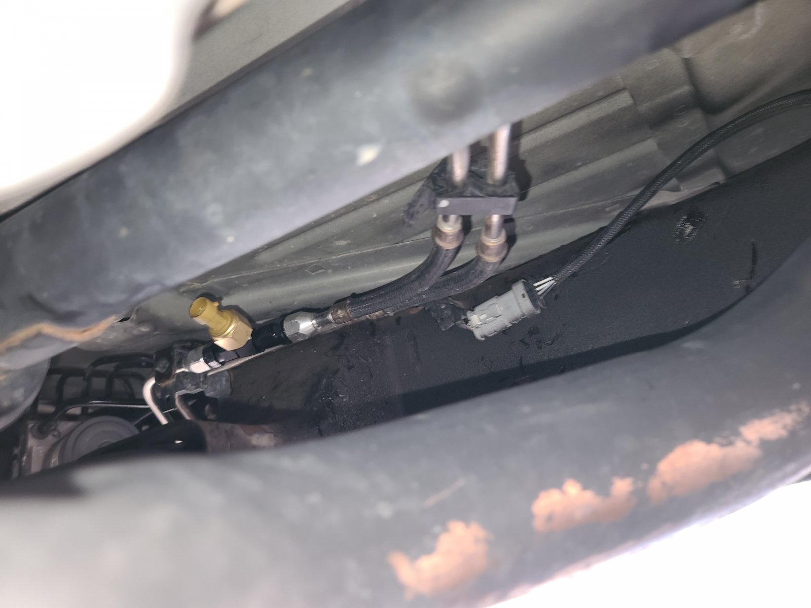

Well since facory dash gauges are way off im installing sh$t load gauges, plus more gauges im gonna need for the future . Hiding them all over. Here is two of fuel pressure sensors im adding, one for AEM X series fuel pressure gauge and one for Innovare ECF-1 gauge

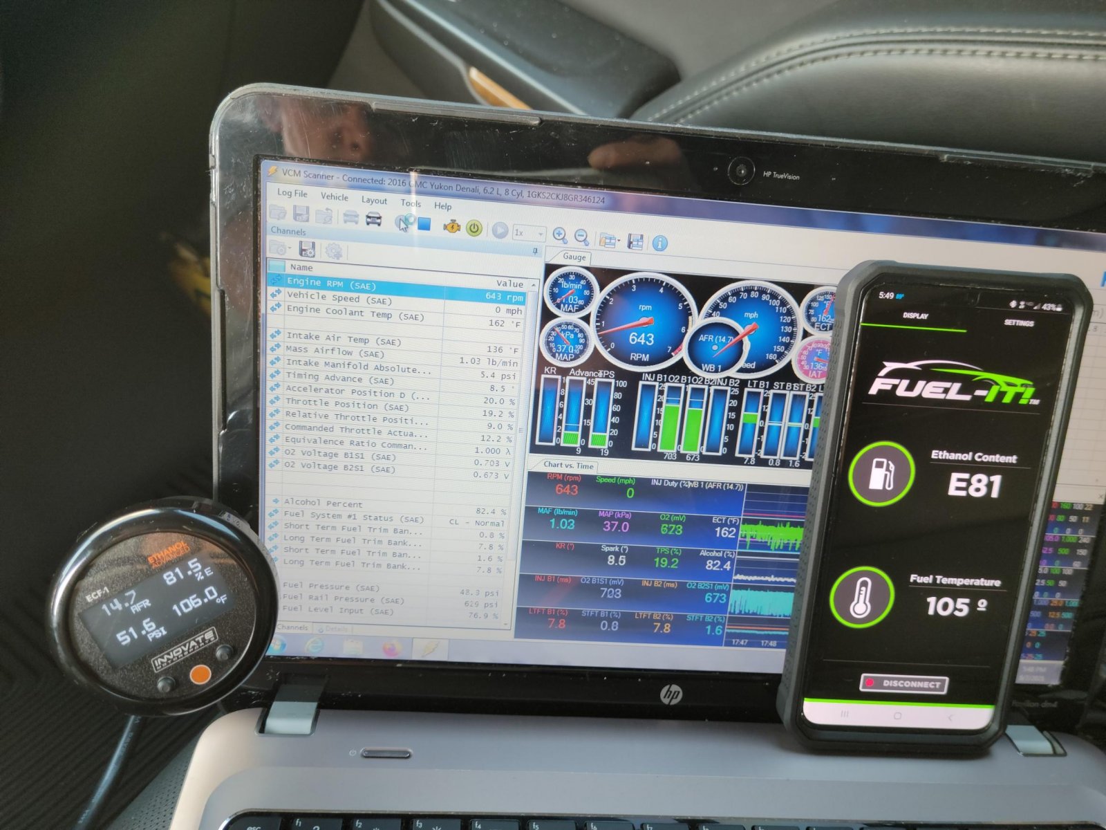

Its possible to splice aftermarket flex gauge on GM flex sensor. It works

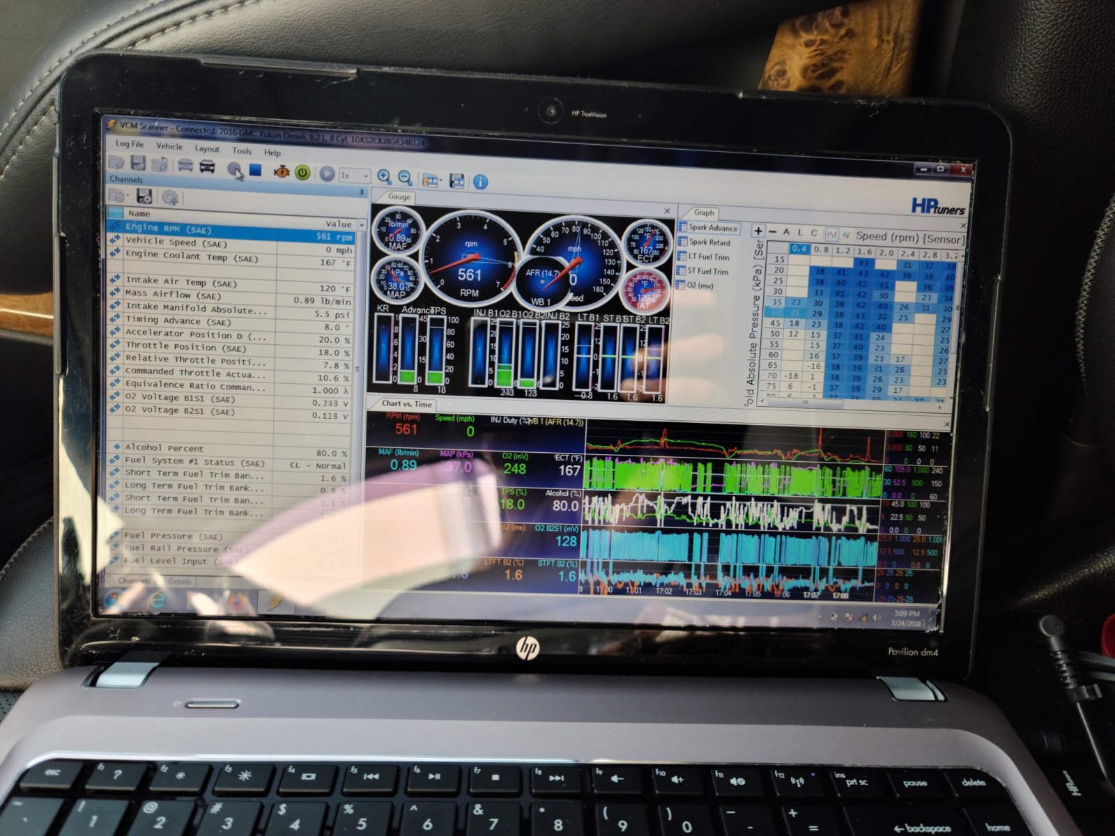

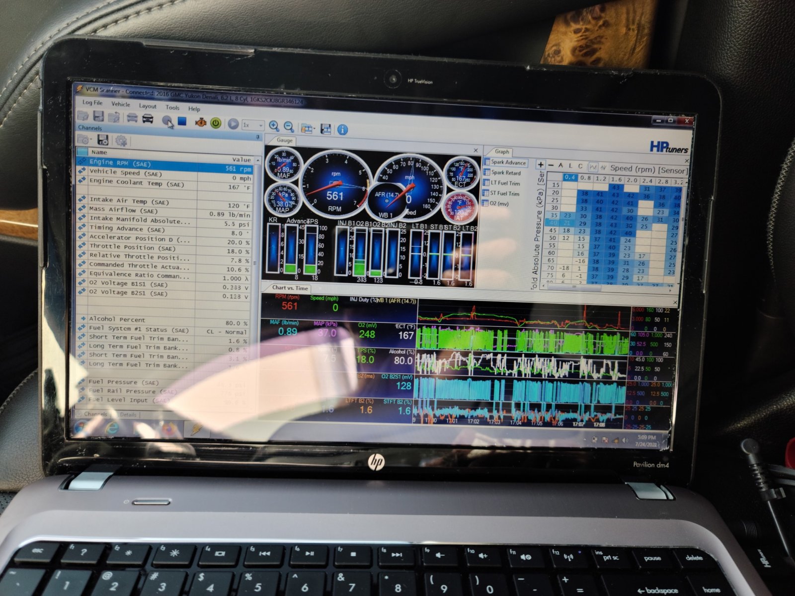

First of all i installed Fuel It Bluetooth Raw signal output 50-150hz. Scanner shows 82.4%, Fuel It app 81-82% for its very close. Than i installed Fuel It Flex harness extension, shorten it some since 48" was too long, splice male plug from 2nd Fuel it extension i have using only white signal wire into 1st extension white wire. This way im only tapping into signal and not adding 12v and ground to existing flex sensor that already have that from the ECM. Installed Innovate ECF-1 4 in 1 gauge, also hooked Innovate fuel pressure gauge on top of flex sensor with adapter that comes with gauge
Scanner still shows 82.4 %, Fuel it 81F and innovate gauge shows 81.5%
