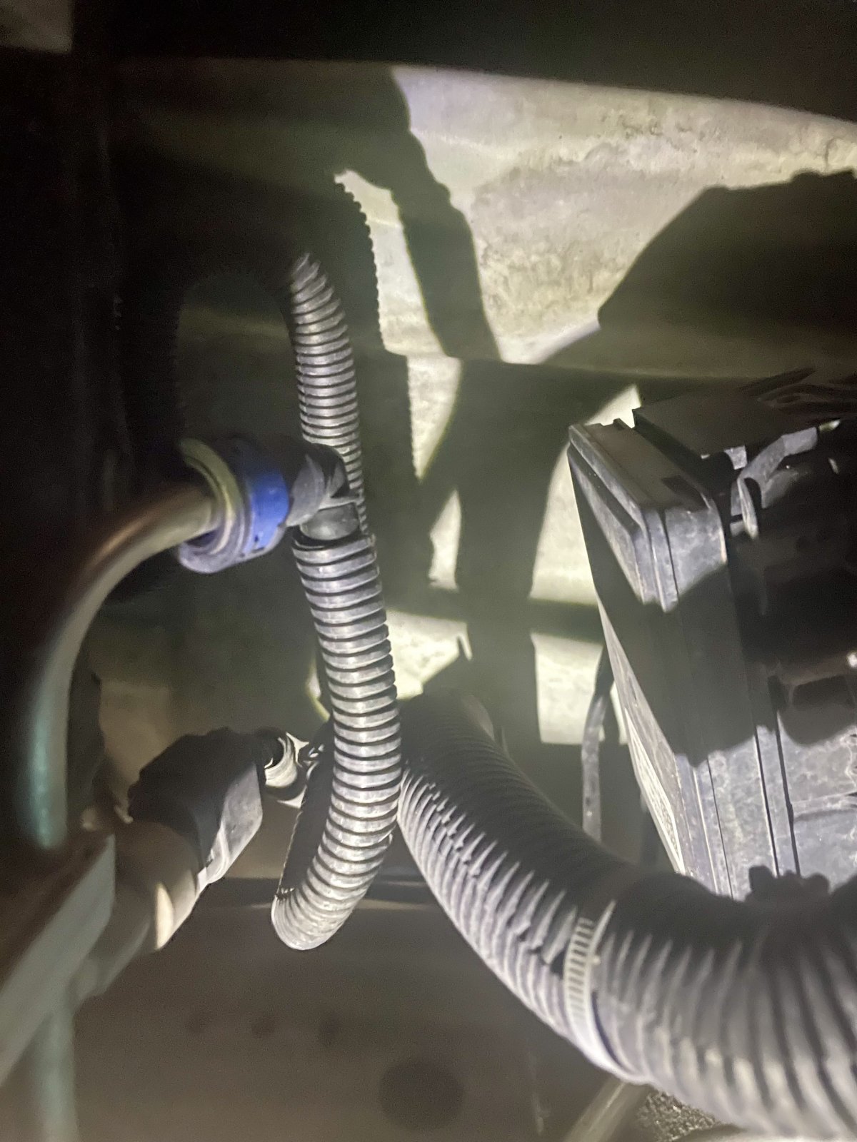

Own 15’ Escalade L86. Looks like all I need is the sensor and bracket. I dont see the brown wiring harness… so I guess I’ll have to wire that. Signal should goto x125 pin 17 per wiring diagram. So I’ll just have to figure where the best place to get +12v after ignition and a solid ground that won’t mess with the ECU ground. Any suggestions on the wiring?

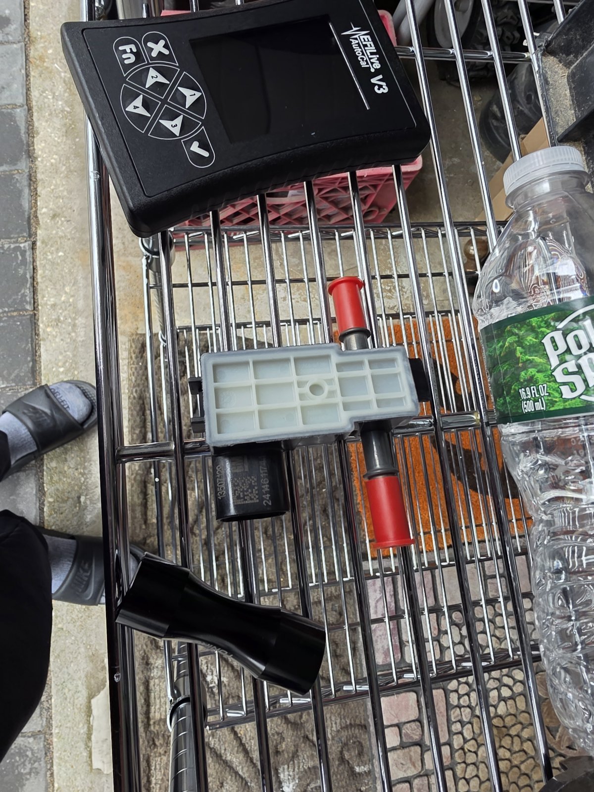

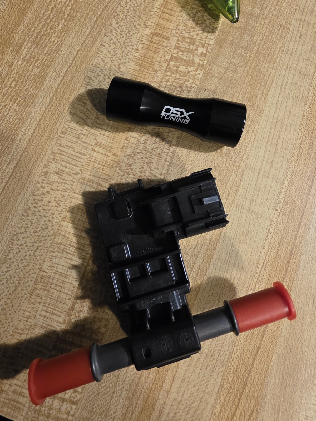

Easy peasy lemon squuezzzy
2 parts
Dsx tuning quick connect female to female coupler
Gm #13507129 Flex Fuel Sensor
@ had BBP turn on e85 maps
