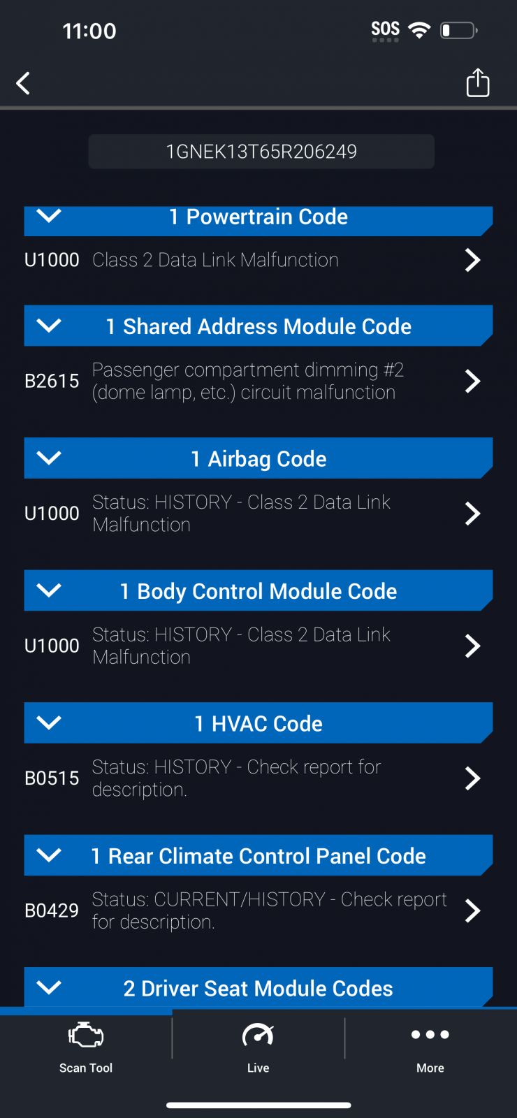

If it helps I do have three u1000 codes. One for powertrain, one for airbag and one for body control module.

So with my scanner the only thing it's telling me is u1000 indicates a comm error between system control modules and is often accompanied by other network related u codes. So with how I'm looking at that is the related modules to those specific items are bad. Correct way to look at it or no? I'm trying everything before I resort to just letting the parts cannon go full auto. lol

Is "Brake" light on when engine running? Andy ABS messages in message center? How did you bleed the brakes? Do you have a firm brake pedal with engine running? You need a scanner to identify which module(s) are throwing the U1000 code. Me thinks the ABS is a part of it and its no talky which would explain why your brakes arent releasing because you have a solenoid in the ABS manifold not being told to open/close.

U1000 is telling you that the PCM is not talking to a module. You need to find out which module it is with a decent scanner.
