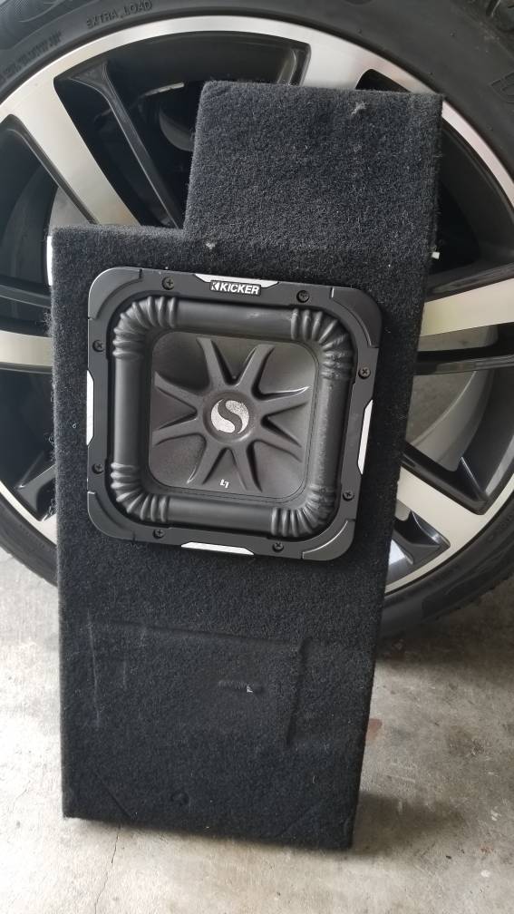

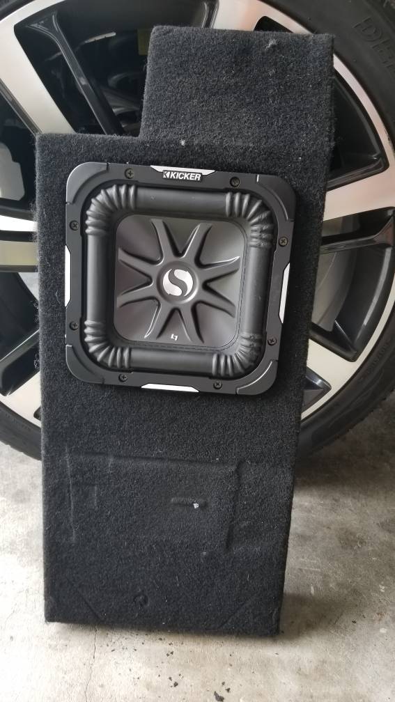

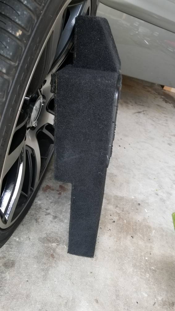

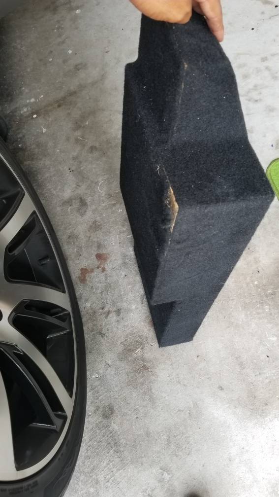

What I have for sale. Kicker L78. 900 watt. Had 450 watts going to it.
Replaced with a DC Audio 12 behind the 3rd row and a bigger amp.
Looking to get 315ish shipped.

That is pretty nice. I was hoping for something like that to avoid taking up space. What is the biggest cubic space that you can fit there? How was rattle?
To the original OP, if you want to keep OEM HU for OEM look, I understand but if you are worried about losing features that come with car, you can definitely go aftermarket and not only keep all OEM functionality but add to it instead of getting one of those options the knowledgeable Nathan mentioned above. I would just compare price. If you going to spend 300+ on any of them, might as well look into a few more and open the gates :)
The box is .48cu ft IIRC. Rattle wasnt bad. Just got keep things that rattle ( change, pens anything) etc out of the tray

That rattle is a small price to pay to save trunk space. I wish it could take a 12 with slightly more cubic space. You should take a video, looks like it beats!

It's out the truck now and for sale.
Replaced with a behind the 3rd row DC Audio 12 .
But it was nice to not have to move it, be scared to bang it around when hauling things. And I told people it was a factory sub ran on an external amp. The Chevy dealer was impressed, lol.
