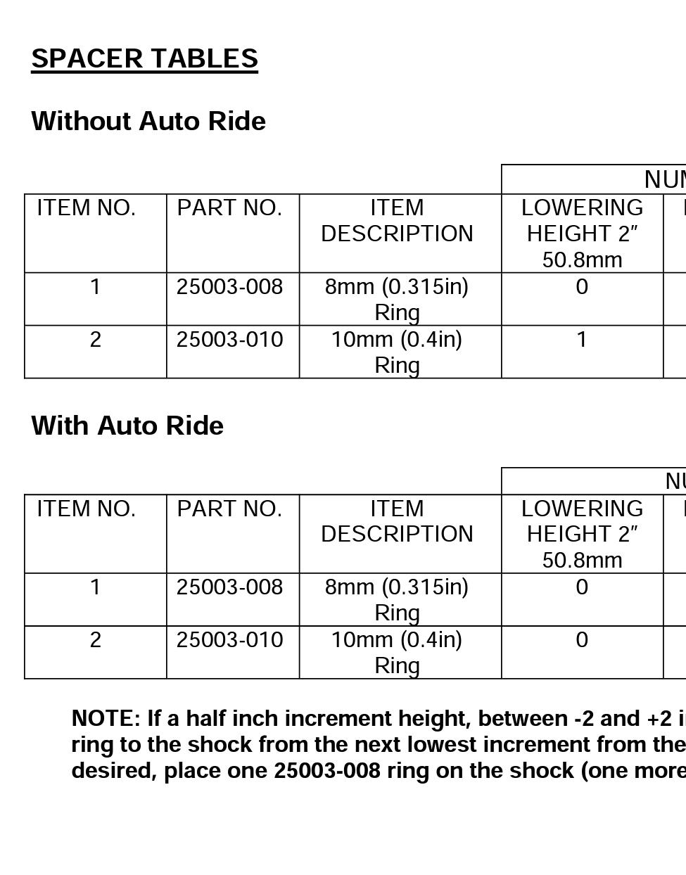

Installed a .5" spacer on drivers side to compensate for the GM lean.
I know I could have left a spacer ring on the driver's side strut but I followed Belltechs directions for autoride equipped vehicles and I wasn't about to go to the trouble of pulling the spring back off to put a spacer below the spring seat when my brother had a .5" spacer from a lift kit just laying around.
Here is Belltech's instructions...
It clearly states for 2" lowering on vehicles without autoride to use one 10mm ring BUT for vehicles with autoride to not use any spacers.
The Burb definitely set lower on the driver's side before adding the spacer and most of my rubbing on small dips was on the driver's side. Now it sets pretty level and it takes a pretty big dip to get the tire to make contact with the top of the wheel well.
I also massaged the top of the wheel wells with a small sledge and shortened the auto level links out back and trimmed the bump stops down.
So long story short no more rubbing when turning lock to lock and no more rubbing on dips in the road so I am happy and more importantly my wife is happy.

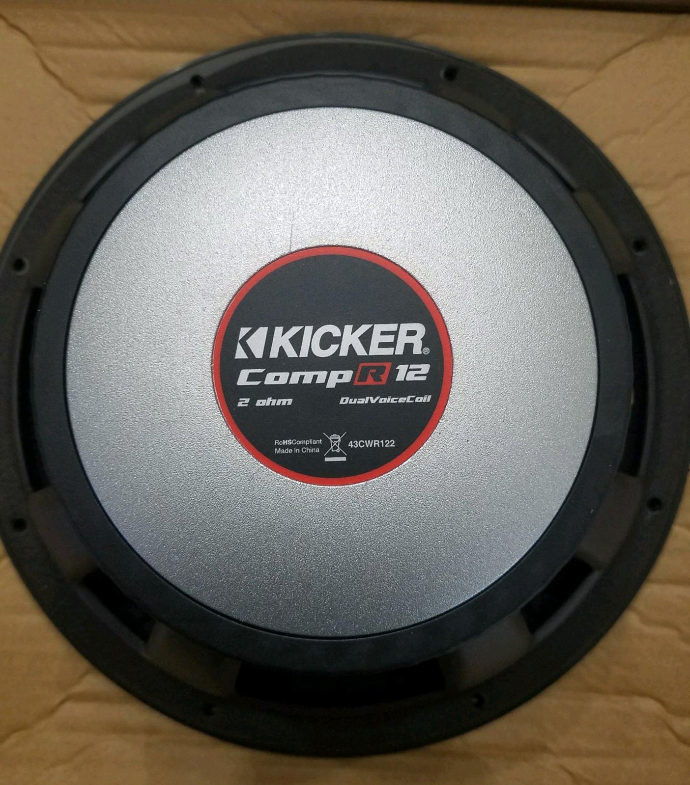

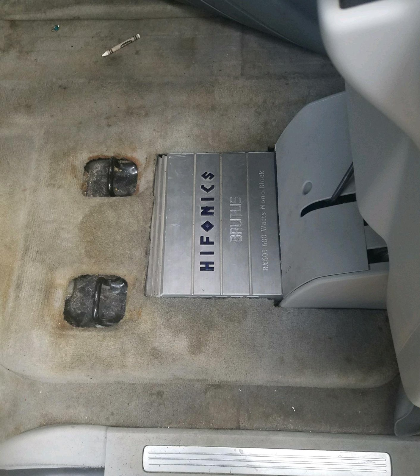

Package arrived today.
Waiting on box to be built and shipped. Ordered a box for single 12 between 2nd row captains.
Really need to clean the carpet. In my defense it was like that when I bought it and I bought a whole set of weathertechs off of CL for $75 right after I bought the truck so I never even see the carpet... lol
Gonna push it with a little 600w rms Hifonics Brutus. Speaker is a Kicker CompR 12 dual voice coil 2 ohms per vc so parallel to the amp gets me 1 ohm.
I am not looking to compete or even rattle windows anymore... I'm getting to old for that... lol
Just a lil something to give a little more bottom end to the Bose system. It already sounds better than it did with the stock HU. I am planning to dynamat the doors to help improve the sound. I may eventually upgrade the Bose speakers to something else but not entirely sure yet what I want to go with.
