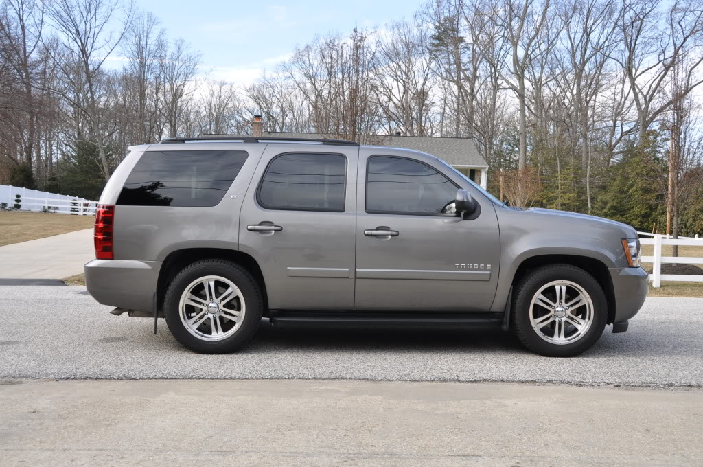

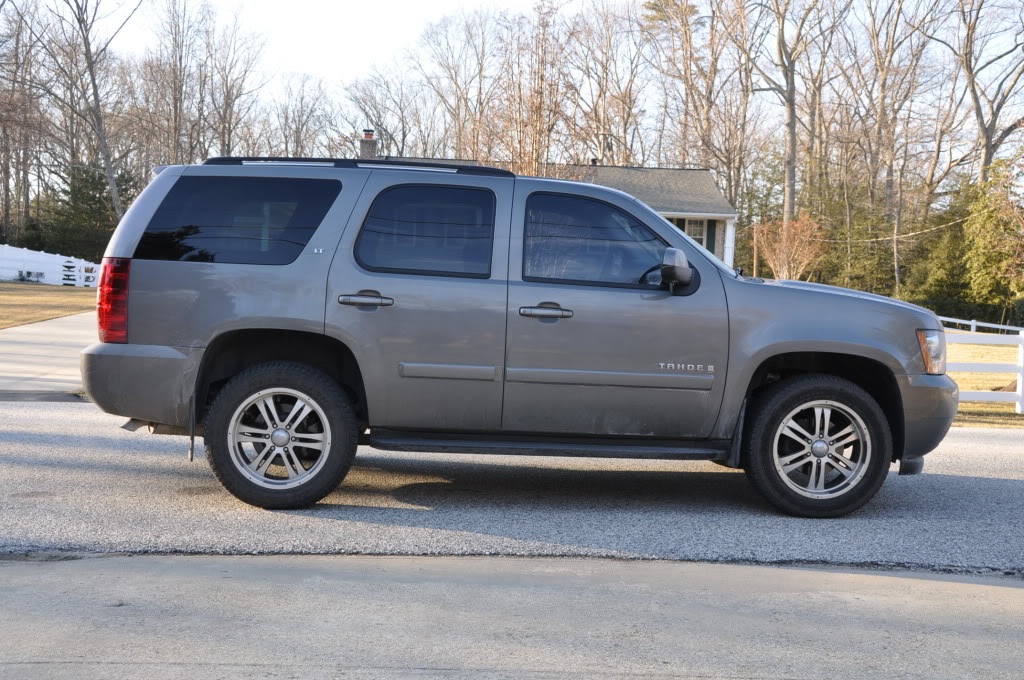

He used this kit here from me.
http://tbssowners.com/store/index.php?act=viewProd&productId=106
In front the struts are set at 2 inches and in rear the adjustable 3-4 inch springs are set at 3 inches.
NOTE---- You can cut the rear 1 inch spacers down so if you wanted a 3.25/3.5/3.75 inch drop you can do that no problem.
STOCK
LOWERED 2/3

Tony -- You need to correct your fist sentence to say FRONT...

Looks good. That's the exact kit I'm gonna get from Tony. What are his wheel/tire specs??
50,933
19,329
NICE :waytogo: Huge difference....

They are 275 55 20's. Thanks for the compliments, tony really helped me when trying to decide on the set up. Ride real nice as well
