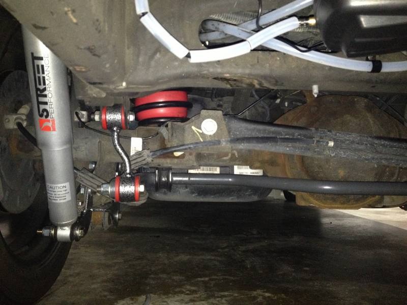

shoot me a pic of the bag in the spring with weight on it

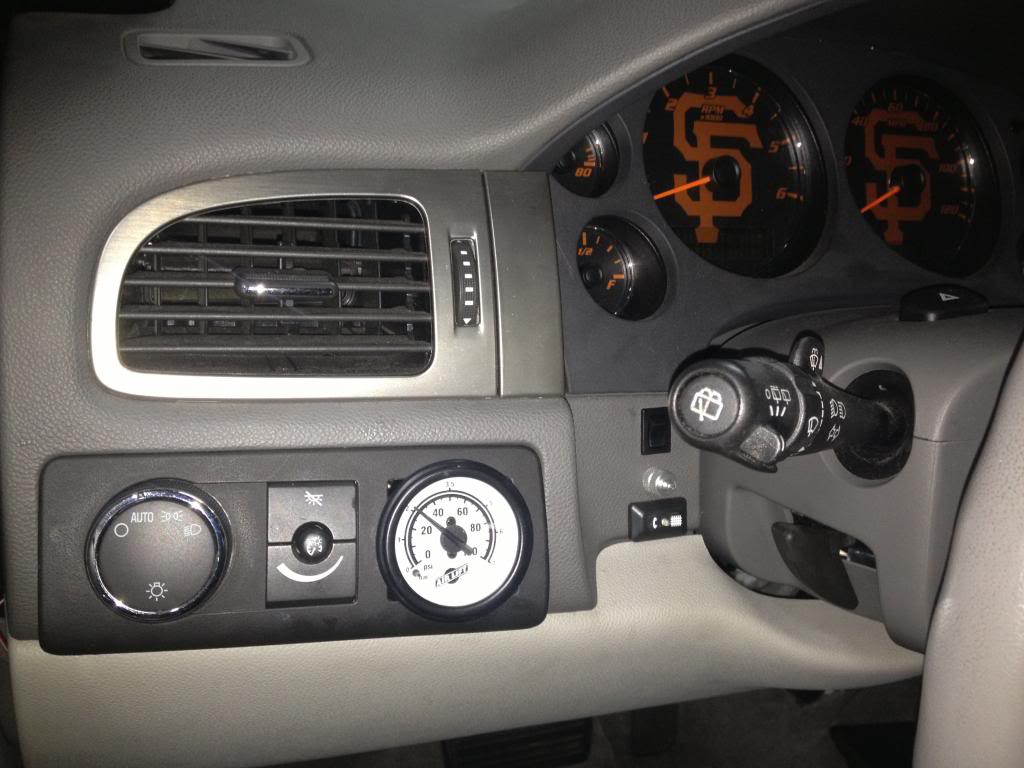

I finally got time this weekend to take some pics of the helper bags. I used the airlift 1000 part #60742. I installed the psi gauge next to my headlight switch since I had an empty compartment that was useless. I also mounted the switches next to the steering wheel where they won't be an eyesore. I mounted the compressor above the spare tire

Looks good. Im glad i went with a non progressive design. This way you can see the bag acatually fits in between all the windings. Thanks again man. Now load her up lol
