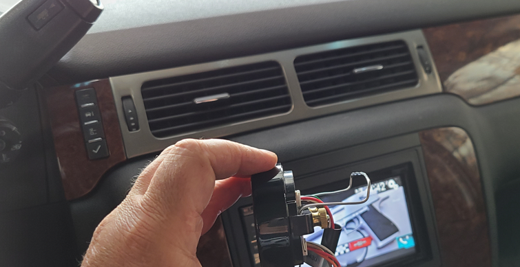

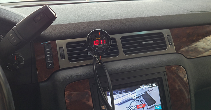

I have the other brand in my vette.
I like it better for the main reason that it comes with a serial connector already installed.
You have the option to connect it or disconnect it as you wish.
One pita part of that one, you need to do an open air calibration of the sensor every so often.
It also has lots of complaints about short life of the sensors.
I read something where peps think it's the way innovate drives the sensors.
With the aem, you need to wire the serial in.
It also does not come with a serial connector, but it's only two wires...
My plan is to dig into some of my old computer crap for an old serial connector.
Since i never throw any of that crap away, i have a good chance it's in the horde. :jester:
The AEM one also says you never need to do the open air calibration, but they say you can if you want...
The little processor box thing is also apparently inside of the little gauge, so you connect another wire set in order to log or use it's other features.
I'm not the biggest fan of that setup.
That means i need to run more wire up/down my pillar... :disgust:

And i routed the wideband wire today, for now I'm probably going to run power from the cig lighter.
Maybe give it it's own ground for good measure.
For the serial adapter part of the AEM, i have this ordered.
Has the FTDI chip that i know and love, no real reason to have the actual serial port. :waytogo:

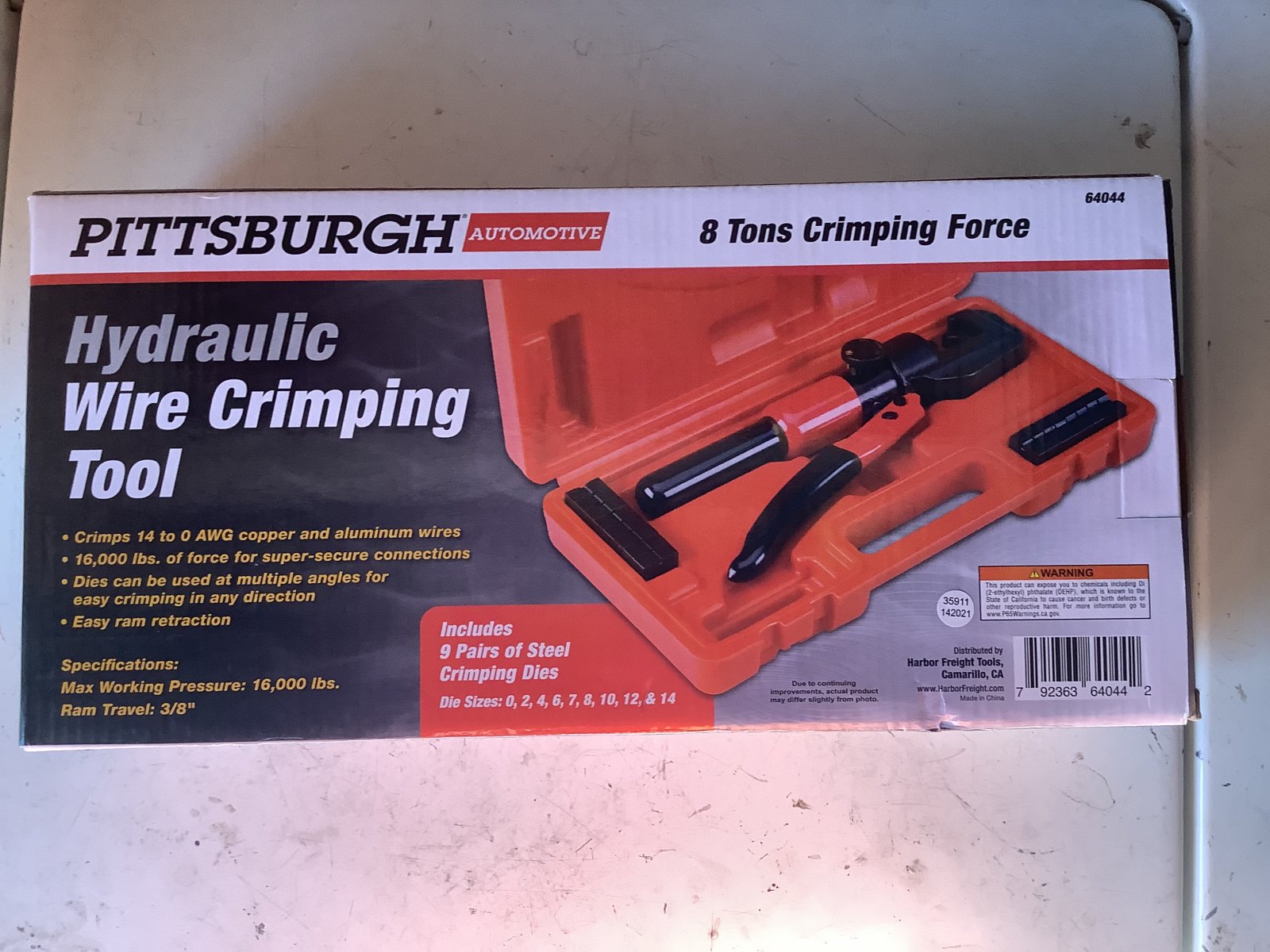

Check out Harbor Freight for a hydraulic crimped for that 0 gauge cable. Bought on when I re wired the Chevelle and made all new battery cables. Made life sooo much easier.

Also, I used a hydraulic crimper like what @cooki3mnster mentioned. Same thing, just yellow and from Amazon. Got the tinned marine lugs and adhesive-lined heat shrink tubing from Amazon as well.

Wideband has been installed, and i'm now starting to tweak my config file.
Reviewing the goat rope garage config, I was actually looking for the how to adjust fueling.
But apparently it's no longer in my saved.
So i started re-reviewing the setup episode, lots of good info and i was able to apply a slight change to the config file i have for the wideband.
Good stuff right there, now the real trick will be is if it actually works. :jester:

And I got hp tuners to actually connect to the wideband gauge.
looks like that usb serial that i purchased never did connect.
I finally pulled the serial adapter out of my vette and used that instead.
Made little connectors to connect directly to the pins, per the AEM manual.
it worked flawlessly.
Later I'll try and figure out wth is up with the one i just bought. :confused:

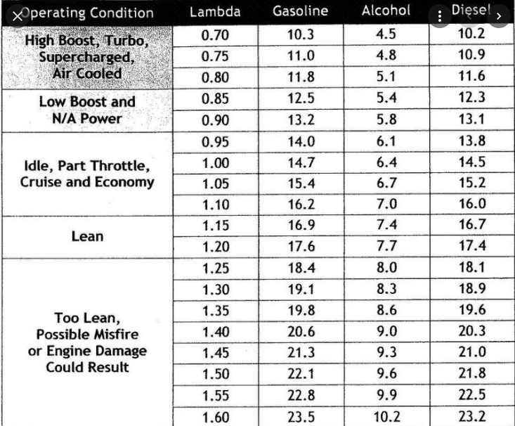

Did a good data logging session with the wideband running.
All looked really good, i didn't see too much dipping and i never saw it go very lean.
Using this as a general guide, later i'll do another run.

Driving around a little the other day the fueling looked pretty good.
I need to do another round of data logging, however I'm getting close to wanting to play with timing tables.
Or maybe i should hold off until i get a good 1 - 2,000 miles on the new engine.
