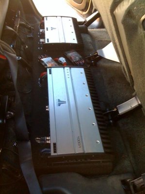

something is not right with the wiring or the amp is starving for power. I'm running two amps under my rear seat which gets even less air flow and no heat issues. my 1001/1 is actually cool to the touch most of the time regardless of how much or how loud I play it. Now I did have a problem with it running hot initially and it had to be sent back to JL.. Turns out there was a defective part.. some kind of semiconductor if I remember correctly. no problems since. You shouldn't have to put fans on these amps.
