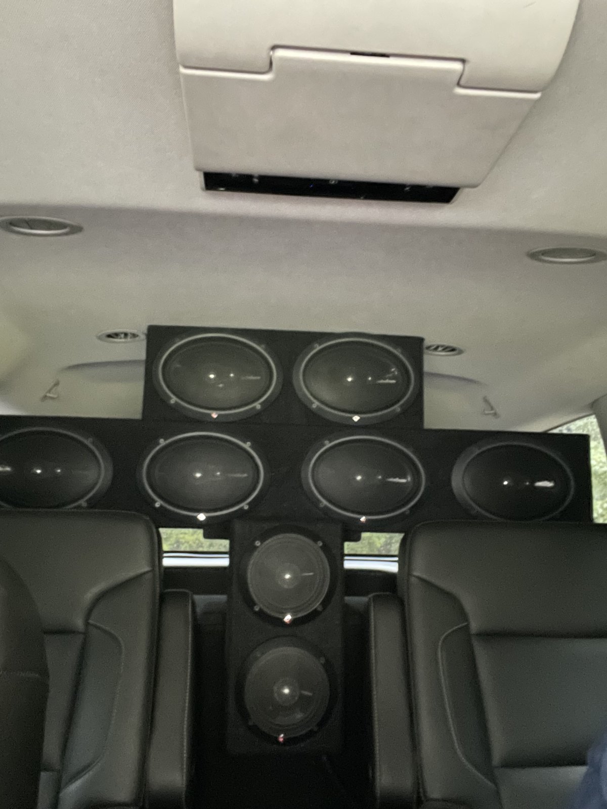

I didn't want captain chairs for the backseat, but here is a unique box Wizard Audio from Oxford, AL made for me.

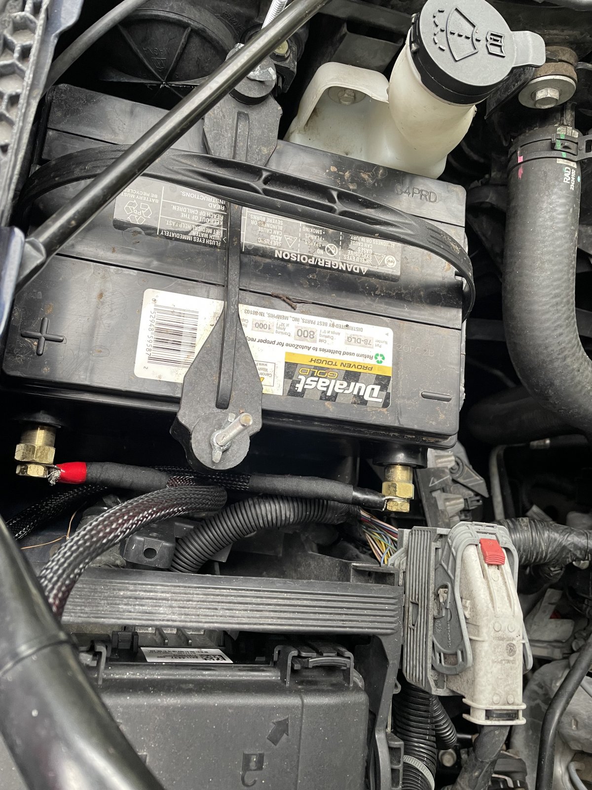

When you added the second battery, what size cable did you use and how did you connect them to the original battery? This is where the batteries with side mount AND top posts come in handy. I have used the side post with 3/8" lugs. Put a nut on a 1" long 3/8" bolt then put the 2 cable lugs on the bolt and install the bolt into the battery. Hold the bolt head and tighten the nut down to tighten the lugs.

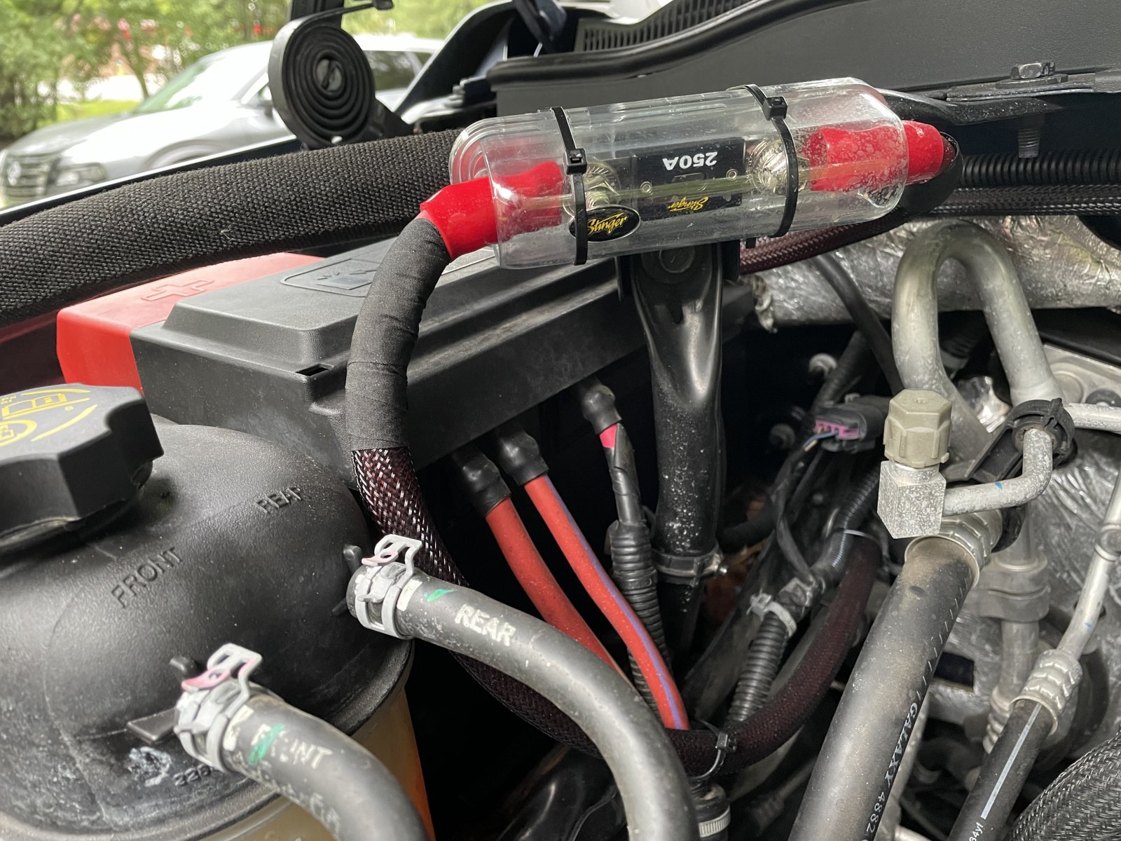

Thanks for so much details. I will add some pics of the batteries and the fuse thingy the installer added on the installation to the main battery, asap. He hasn't added any capacitors yet. Looks like 2-3 weeks in the new alternator, headlights replaced next Friday, but I will keep giving updates, thanks for replies.
