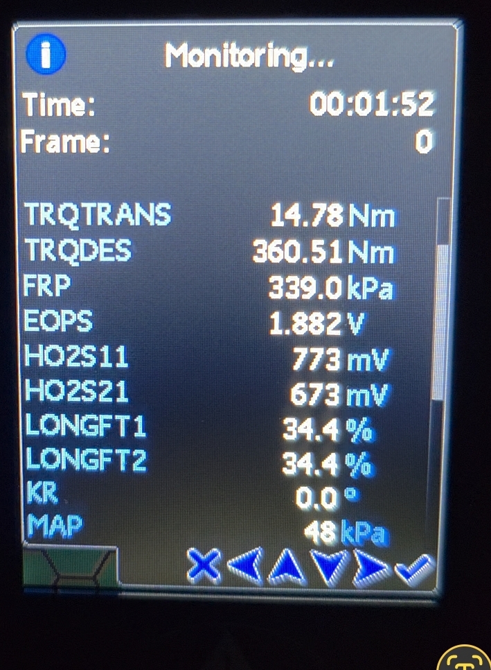

Has anyone had any issues runing a BBP tune adjusting to e85? 2nd time this week I'm getting a P0171 lean code I am trying to run e85 now I was under the impression while runing the Black Bear performance tune it should adjust to e85 normally?
My freeze frame data is showing 34% for both LTFT any suggestions ?

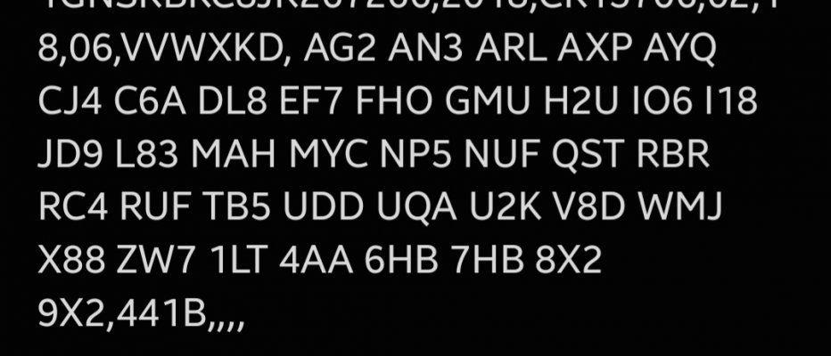

Scanned QR code on driver door jamb and found out it's FHO which is pump gas only
FHS is for e85. Sooo is it easy to make this engine e85 ready ?

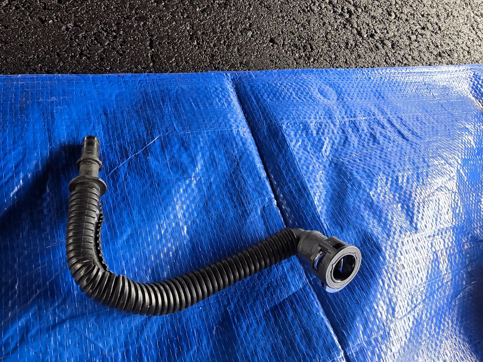

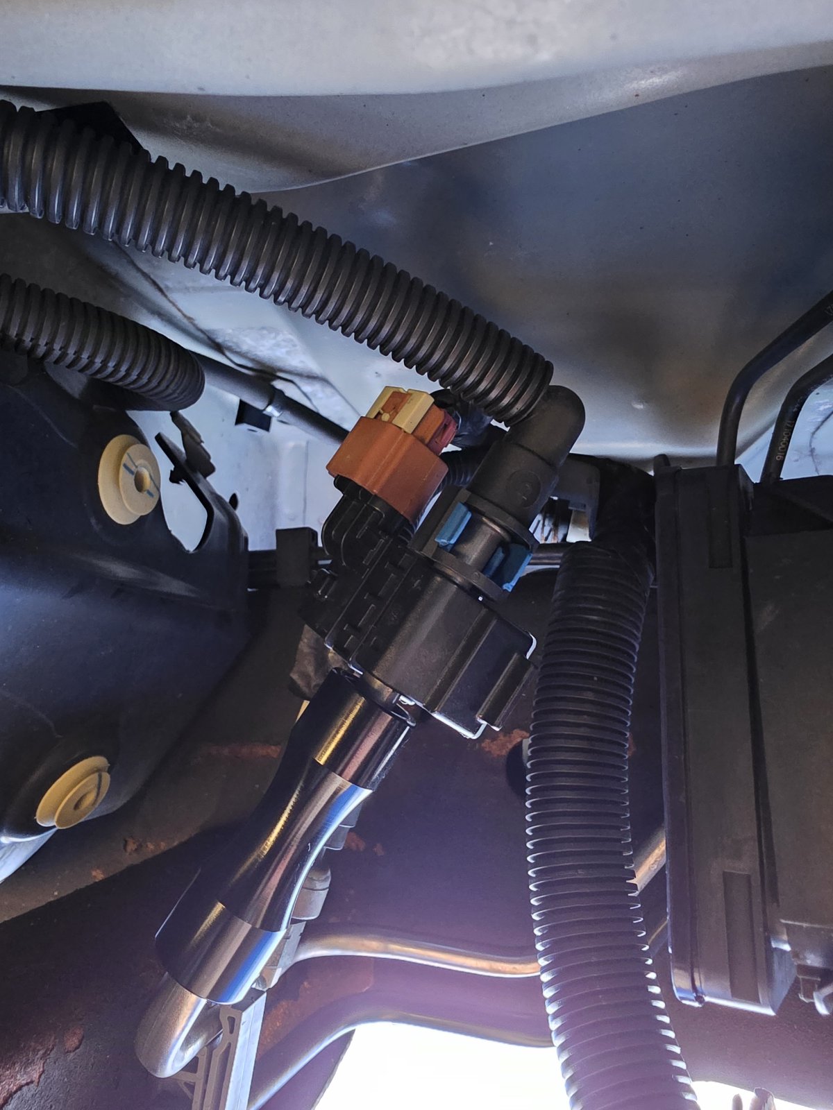

Dummy plug and extra fuel line extension removed from vehicle
E85 sensor and DSX tuning QC coupler installed
Easy peasy, had BBP send over a new tune with enabled e85 . Very simple
