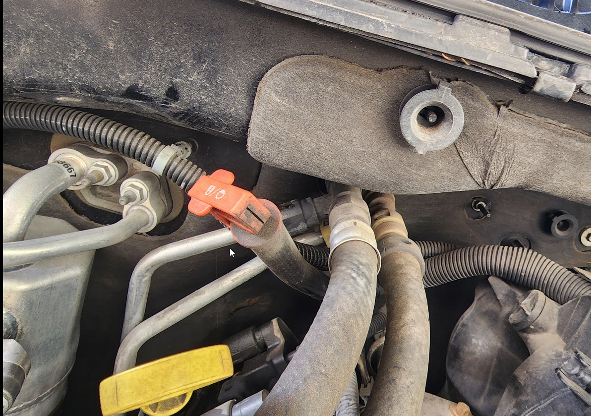

3) When looking for the cause of that smell yesterday, I saw this. Looks like a leak? Any ideas?

2 & 3 are possibly related. That location is very suspicious for heater core T fitting(s) leaking. Look at those carefully. You didn't mention your mileage but you probably have over 100,000, if they've never been changed out, it's time.

Have you determined whether the coil pack is wet with oil or coolant? Wipe it clean and see what, if anything continues to drip on it. It looks like coolant, but the road grime makes it hard to tell from the photo.

I haven't done much with that leak since finding it last night. I'm going to wipe it down during lunch today and see if I can pinpoint the leak after driving it a bit.

It's definitely one of those tees. Checking it out more closely I can see leakage all around that tee.
Any idea which is the correct replacement part?
I think it's this one: DORMAN 800414 Heater Hose Connector - Auxiliary Heater; Inlet Hose Tee; Auxiliary Air Conditioning and Heater; 113 mm Length
Also, while in there I think I found a coolant leak. I replaced the radiator like 2 years ago. I put coolant in the other day and the tank is almost half empty already. I just can't figure out what hose this is. Is it the trans cooler line, right? I think I'm just going to replace both the upper and lower trans cooler lines.

More likely your coolant loss is that fitting. It is constantly circulating whether heat is on or not. Aside from the coil pack from being wet, the fitting was likely spitting out while you were on the road.
The line you see there with the arrow would be carrying transmission fluid to the front, not coolant. If transmission cooler lines or the core for that was involved at all in your coolant loss, you might see coolant in the transmission fluid.
If transmission fluid is clear and not milky or weird looking, I would focus on the heater T's and replenishing the coolant for now and see what happens.
Replace the heater T's, top off you coolant and re-check the coolant level over the following weeks after driving long enough to get things up to temp and circulating a while.
Sometimes extra coolant is needed after air trapped in the lines or in the rear heater core gets burped out. The level drops a bit when the air moves out of the system.
AC Delco T's are preferred for longevity and fixing one time. But Dorman works in a pinch. I had one just snap at the hose and my coolant was being pumped out full-bore by the water pump until I could pull over. Dorman was available at NAPA and I needed right away. No leaks. Do I expect the Dorman to last 18 year like the factory part? No. But will probably last long enough for me and the time I end up having this Tahoe anyway.

Those heater core Tee 's can sometimes be a ***** to take off, stuck back up in there like that. I tried like hell to get one off without breaking that little white release tab.
Then when I opened the new T it had a new white release tab.

You'll be sorry if you use the Dorman tees. @Doubeleive posted the correct part numbers in this post:
I'm getting errors on Amazon that those part #s so not fit a 2005 Tahoe. That thread is for a 2014 Yukon.

Purchase your Tees from your local dealer, or got to GMPartsDirect.com and purchase them for a lower price.
As stated above, do NOT purchase Dorman Tees, unless you are in an emergency situation.
Also, wear gloves when you replace the Tees, as the firewall insulation is real aggressive, and your hands will be itching for days.
