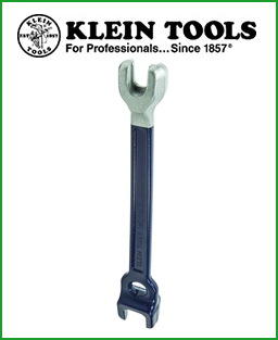

So cut the bastard cable and clamp it with something like one of these
or a few of these in series, it wont come loose
https://www.ebay.com/itm/3535849105...CHIhr86h2Q%3D%3D|clp:2334524|tkp:BFBMgLeJ8ptf

That first one shown is called a 3-bolt strand clamp, used for attaching various sizes of steel strand to communication pole bolts. Telephone and cable television hardware. Creative. I have a blue lineman's wrench in my toolbox that fits those square nuts.

I have seen some clamps like that holding high tension cable, if you cut it and clamped it with 3 or 4 of those D clamps it would hold it too, just need to figure out a location and get some bolt cutters
